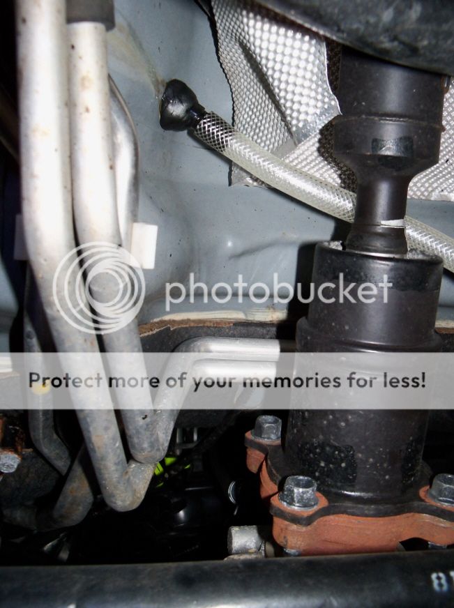

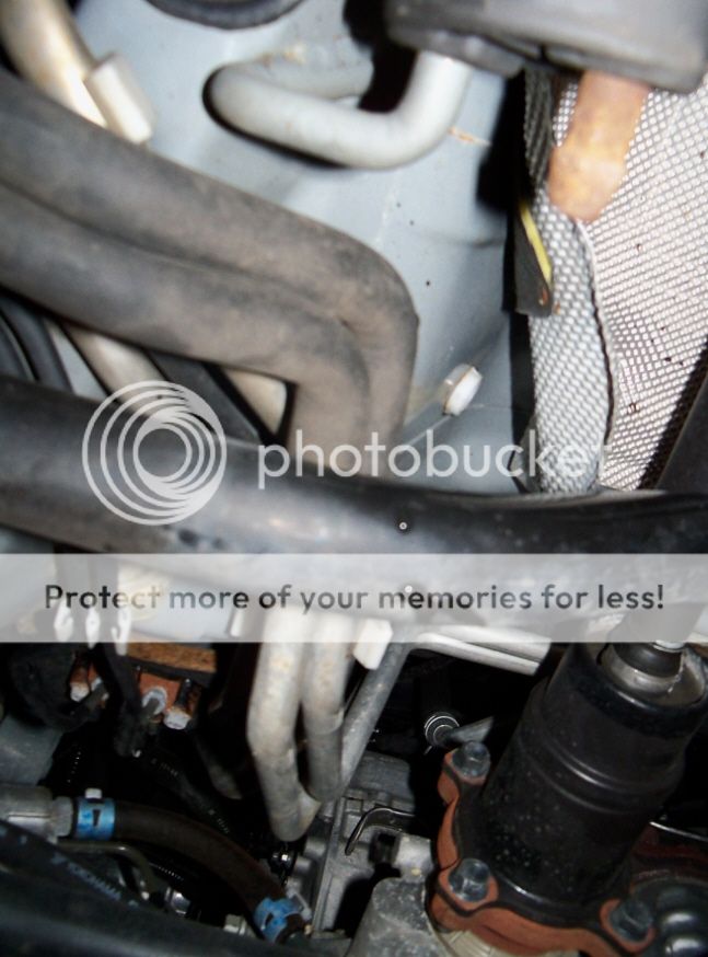

Locate the clogged white AC condensate drain it's under near the driver seat in the vertical wall of doghouse,
you'll have to bend back the aluminum heat shield:

Stick the micro hose into the CX-9 white drain pipe and wrap the butyl sealant all around, make sure the seal is fully tight all around like you see in my pictures:
