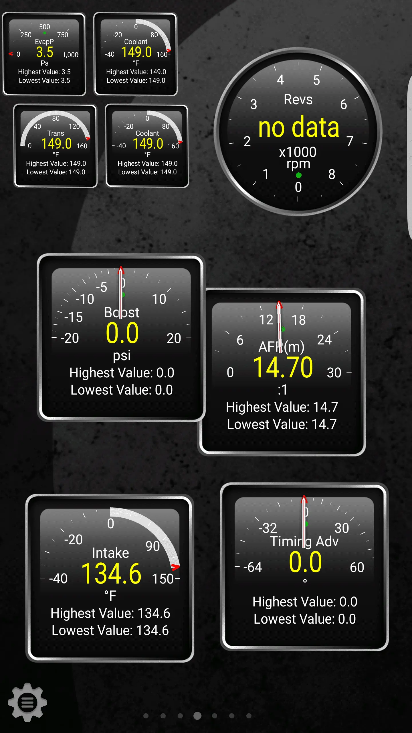

I've got it (engine off)
Chris: Just checking but have you seen coolant and AT at slightly different temps in app? Just curious if it could be placing coolant temp parameter in AT temp field.
I'd have to check when its running. It may just be coincidence or it might be the sensor averaging since the coolant and ATF go through the oil cooler. That might explain why there is a method 1 and 2 option.
According to the service manual the ECT (engine coolant temp) is used for both fluids.
Good to know. I hadn't looked at that. That should make it a lot easier for those servicing transmission as cost to monitor fluid temp is minimal.
I could fine no ther sensor mentioned in the manual regarding atf. Even under overheating troubleshooting, only ect sensor is referenced

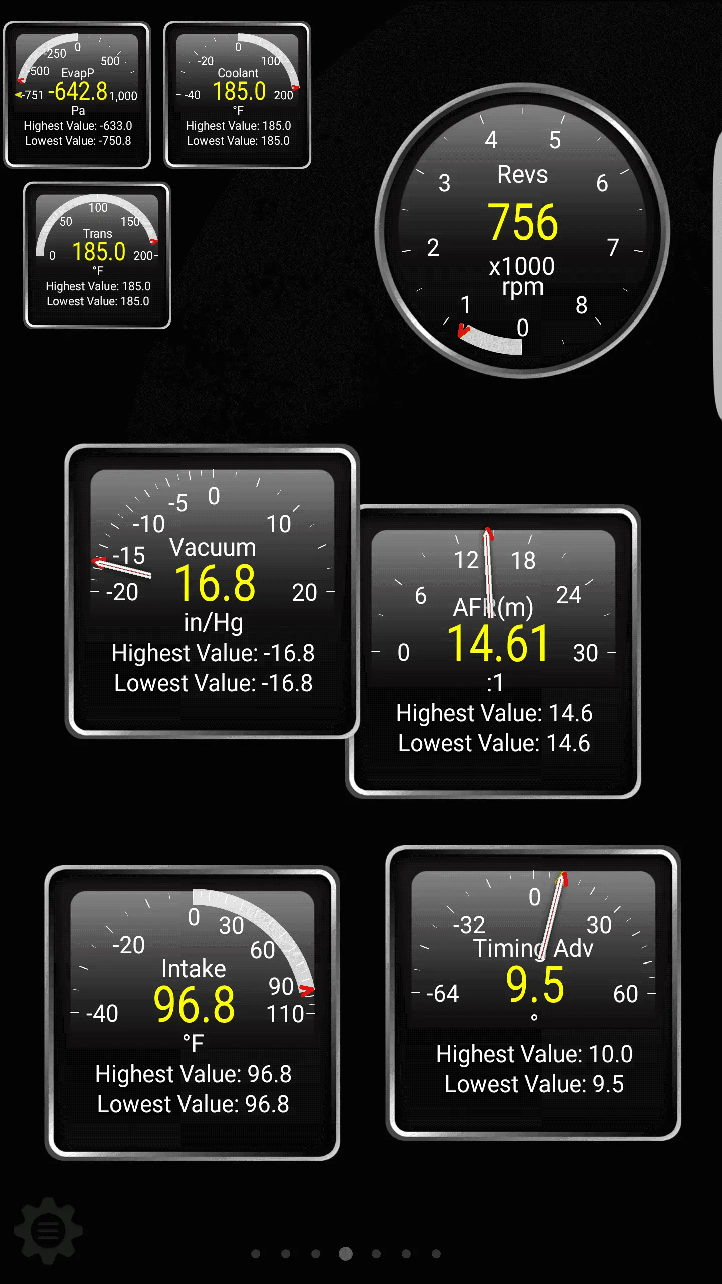

Drove to Burger king and back to work(<10 min run time)
Wait so you got trans oil temp up to 185 (which is within normal operating temps) in 10 minutes.
In that case 122F could be reached by simply idling for 5 minutes or so given garage temps are 60-80 degrees.

The car wasnt overnight cold, it haf been driven a few hours before and sitting in 80 deg weather. This one is coming from a car meet, i pulled over and plugged it in so the mins of some # were already high . 20 miles at hwy of driving with 85+ highway and busting 100 a few.
