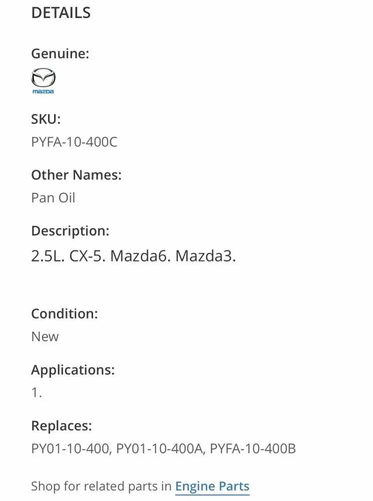

Just FYI, the oil pan for the 2.5L is not terribly expensive, and the labor shouldn’t be too much either. And DIY is a possibility too. Just be aware that a member (madar) has said there’s a new (revised and larger) oil pan from Mazda (see “replaces” part list) when he had his oil pan replaced on his 2016.5 CX-5 due to the oil leak. The new pan takes more oil than the factory one.

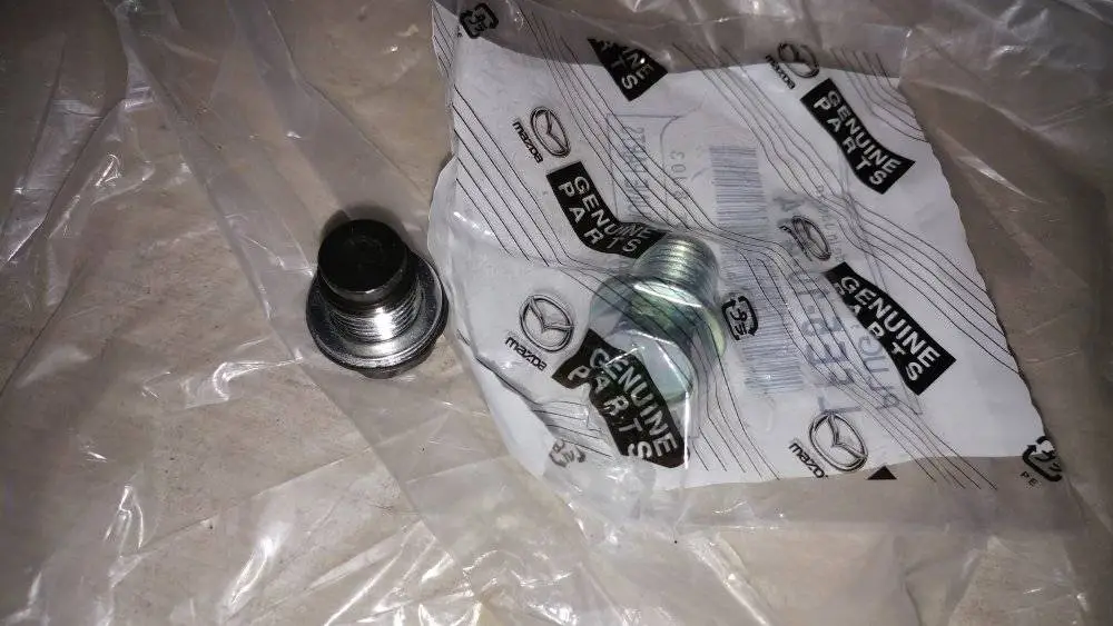

Fyi plugs from factory are black and OEM replacements are silver.
Upvote 0
oem plug 'head' on 2016 is shown by yrwei52 and is different. Its not hex head bolt sticking out as it was mentioned.
The newer oem bolts and replacements are like these below (hex head showing outside the pan) and yes the oems that come with the car are painted together with the oil pan in black.
at least the head and inside the pan, bolt end.
I think its pretty much clear what happened. They messed the old plug and changed it to the new type since thats whats available now.
Then they put the sealant junk around for whatever other reason, stripped,etc.
Only real long term option that is worth it to me is to remove plug and see whats behind it. Prepare for a new oil pan if needed. The new pan comes with the plug/bolt.

Interestingly enough I did go through my paperwork last night from every oil change I have had and did find when the drain plug was changed, over three years ago. To quote: "We replaced the engine oil pan drain plug as the internal hex head was rounding." Part# in the paperwork for the new plug is HE03-10-404 Plug, Hex Head (No Flange). This was at the dealership I used to have service done at before they were bought out by the current dealer a couple of years ago. I think I even remember them mentioning it but I didn't give it much thought at the time.
Upvote 0
I certainly will, I appreciate everyone's time weighing in on this. Was out of town last weekend and I'm out of town camping in a remote area all next week, so I'm inclined to leave well enough alone until I get back and can tolerate being without a vehicle for a few days if it comes to that. I'm at about 6,000 miles between oil changes (don't usually go much past 5,000) but I don't think a few hundred more will make or brake things.
I guess that is the OEM replacement for the internal hex head one and not a regular bolt from the hardware store. I am starting to think that it is not stripped after all since it obviously screws in. Maybe HE03-10-404 tends to weep a little so they add the extra precaution. When you do your own oil changes you won't have to add the sealer, and if it weeps you can get a drain plug that seals good.

The Mazda hex bolt has a flange. I'm not sure from the picture that the bolt is even a genuine Mazda bolt. I would get myself a genuine mazda bolt with a flange before I did another oil change. This whole issure would make me very uncomfortable. Please post back. Ed
