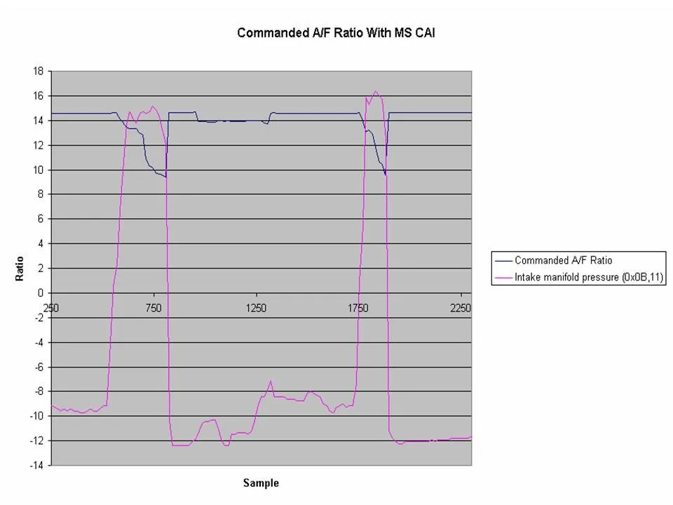

stretch said:
Speedy, I think the your "scanner dyno" results and these real-life dyno results are confirming something: that the ECU doesn't know what it's doing anymore. The reported gains from users are anywhere between 10hp and 35hp!
I'd estimate the gains from relieving the pressure drop in the intake path should amount to 15-20hp; anything more or less is likely coming from the air/fuel ratio changing. Either it'll lean it out (see above post) and you'll make more power than expected, or the car will get confused and make too large of a correction- and perhaps even pull timing- resulting in lower-than-expected gains. See, when you have the MAF after a bend, the correction needed at an RPM and load will not be the same as the same RPM but a different load. The ECU can't deal with this, but it tries, and these "tries" may be why power gains are so inconsistent.
Hey stretch, sorry, I have been on another thread through all this. I did respond to Dread with my A/F ratio data. The following is on another thread:
http://www.mazdas247.com/forum/showthread.php?t=123662057&page=9
"http://www.mazdas247.com/forum/showthread.php?t=123662057&page=9"
It turns out to be fairlly difficult to determine the A/F ratio from the SW, but I was able to get some useful data, then derive the commanded A/F ratio.
First off, the numbers indicate that the First O2 sensor is measuring the A/F to be about 8% leaner than stock with the MS CAI. The good news is that the ECU is commanding a decrease in the A/F ratio (Richer) by about 6% to compensate. The Commanded A/F ratio under peak load in stock config was about 12.2. The Commanded A/F ratio under full load with the MS CAI was about 11.5. This is the commanded A/F ratio based on compensation learned from feedback while previously driving, so it seems, it is compensating for the MS CAI. I also noticed during the dyno tests that almost the same density of black smoke was coming out of the exhaust in stock vs with MS CAI. So, despite the difference in diameter of the MAF housing (as posted by flyrevs and cp-e) and the increase in air-flow from stock to MS CAI, it seems the MS 3 ECU is adjusting the A/F ratio to keep the car from running too lean. Initial results look like it is about 2% leaner.
Here's some OBDII data on the "Commanded A/F Ratio" with the MS CAI. From my calculations, the car is actually running 2% leaner than this.
