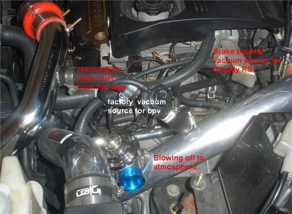

I'm having a problem similar to how he describes it. However, I hit the gas and when the turbo spools up it sound like it's sucking air from 2 different places yet I hold normal boost readings on my guage. I also don't feel it getting to the wheels like I used to, so something (once again) isn't right with this car. I've checked all the hard pipes and all connections are solid. I haven't checked the mani, but at risk of sounding stupid I don't think that's the problem. Is it possible my bpv is no longer working (see photo for referrence)?
Have any of you heard this, or am I on the wrong thread all together with this issue (I don't want to thread jack)?
