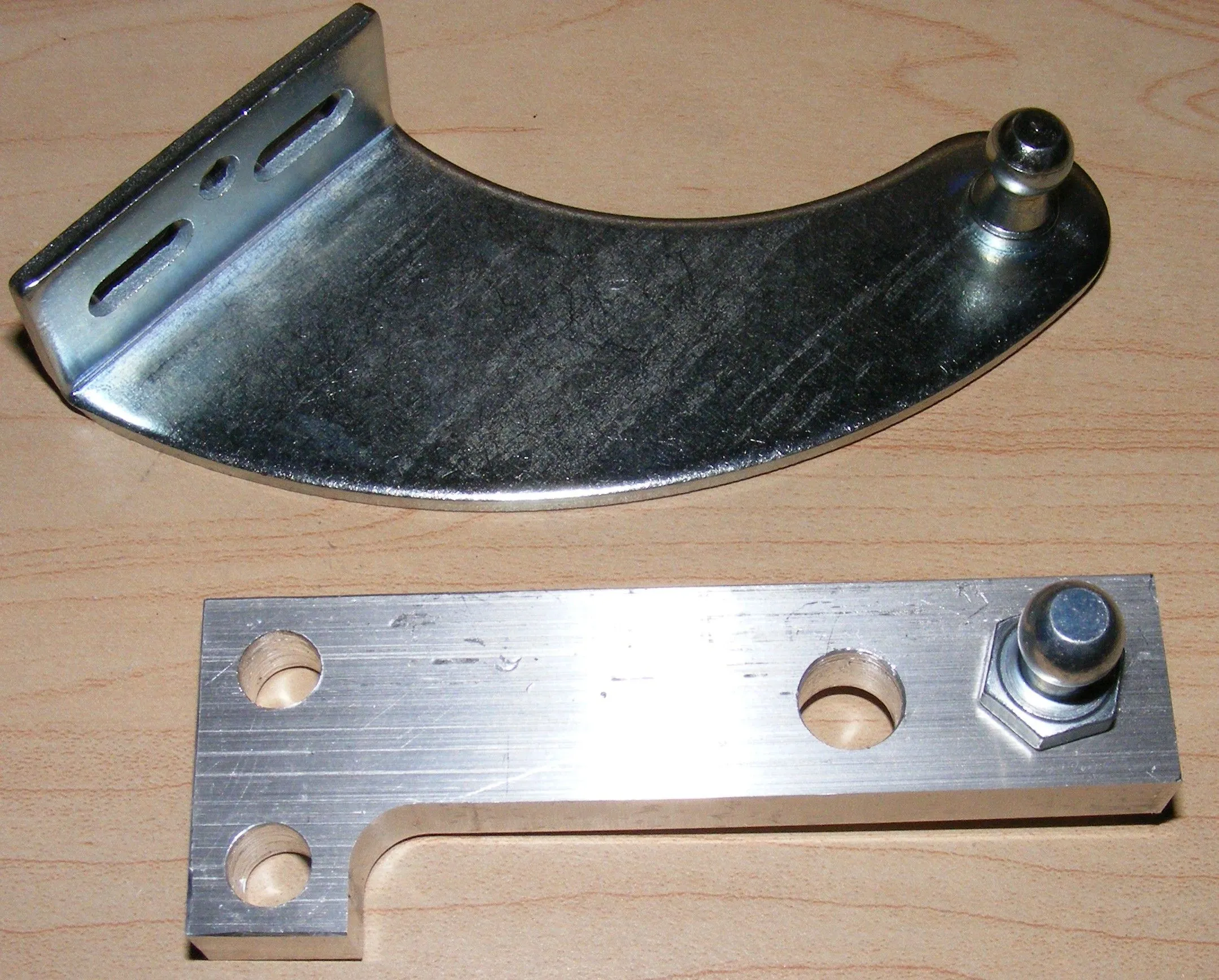

I finished the prints for the short-throw shifter plate today. Because I'm a good engineer I made a prototype out of some aluminum to check the fit-up, and it looks bang-on (machining the aluminum takes about 1/4 the time as the Ti). Clearances all look good too! Unfortunately I need longer bolts to mount it and test everything while driving, and the hardware store was closed when I finished machining it. However, with this good indication I'm going to start machining the Titanium part either tomorrow or Friday, depending on how much free time I have. Tomorrow I should be able to post the drawing I used in *.pdf format.

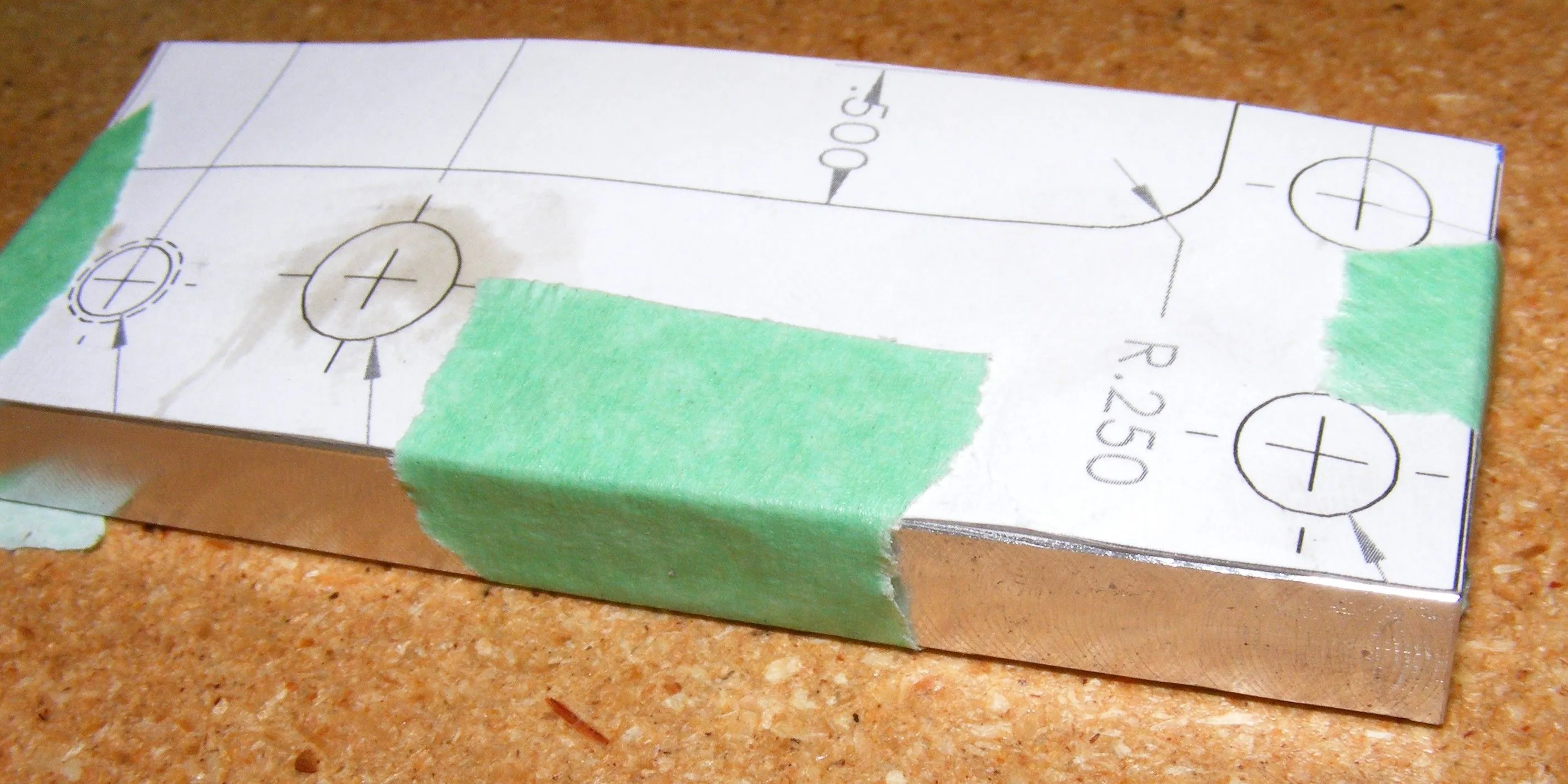

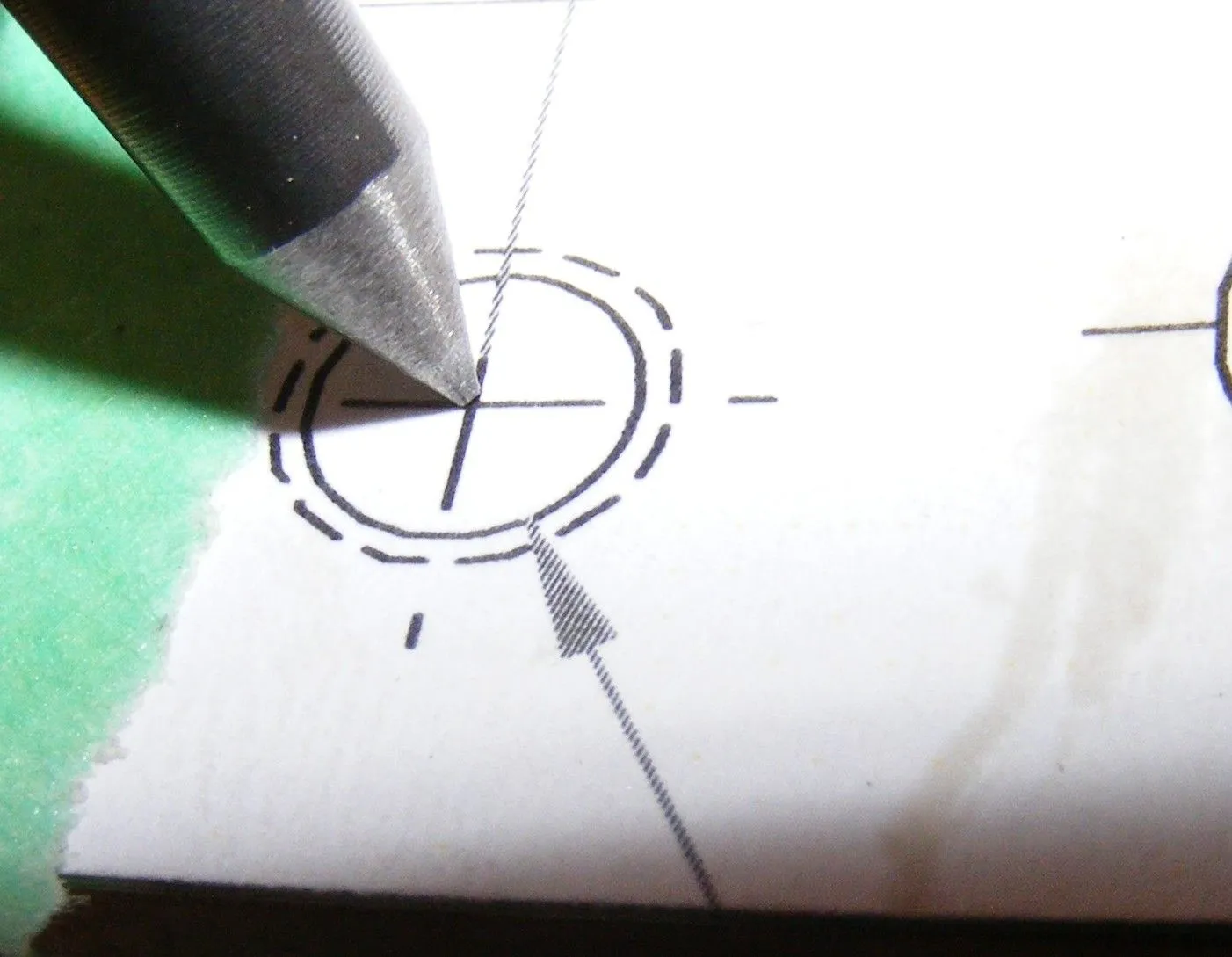

Everyone else way- Cut out the outline of drawing either by measuring and marking, or by taping the print right to the metal stock and using a punch and hammer(a nail works if you don't have a punch) to transfer all of the corners and hole centers, marking between the corners to get an outline to cut/sand/grind, and pilot-drilling at the hole center punches.
I did my aluminum piece half-and-half. I machined the outside profile out of an aluminum plate (3/8" was what I had to work with) and then taped a cut-out of the print to it and punched the hole locations through. I ran a small pilot drill through each hole location, drilled the full diameter hole, then tapped the ball-joint mounting hole (remember lots of oil when you tap, and turn back every now and then to break the chip).

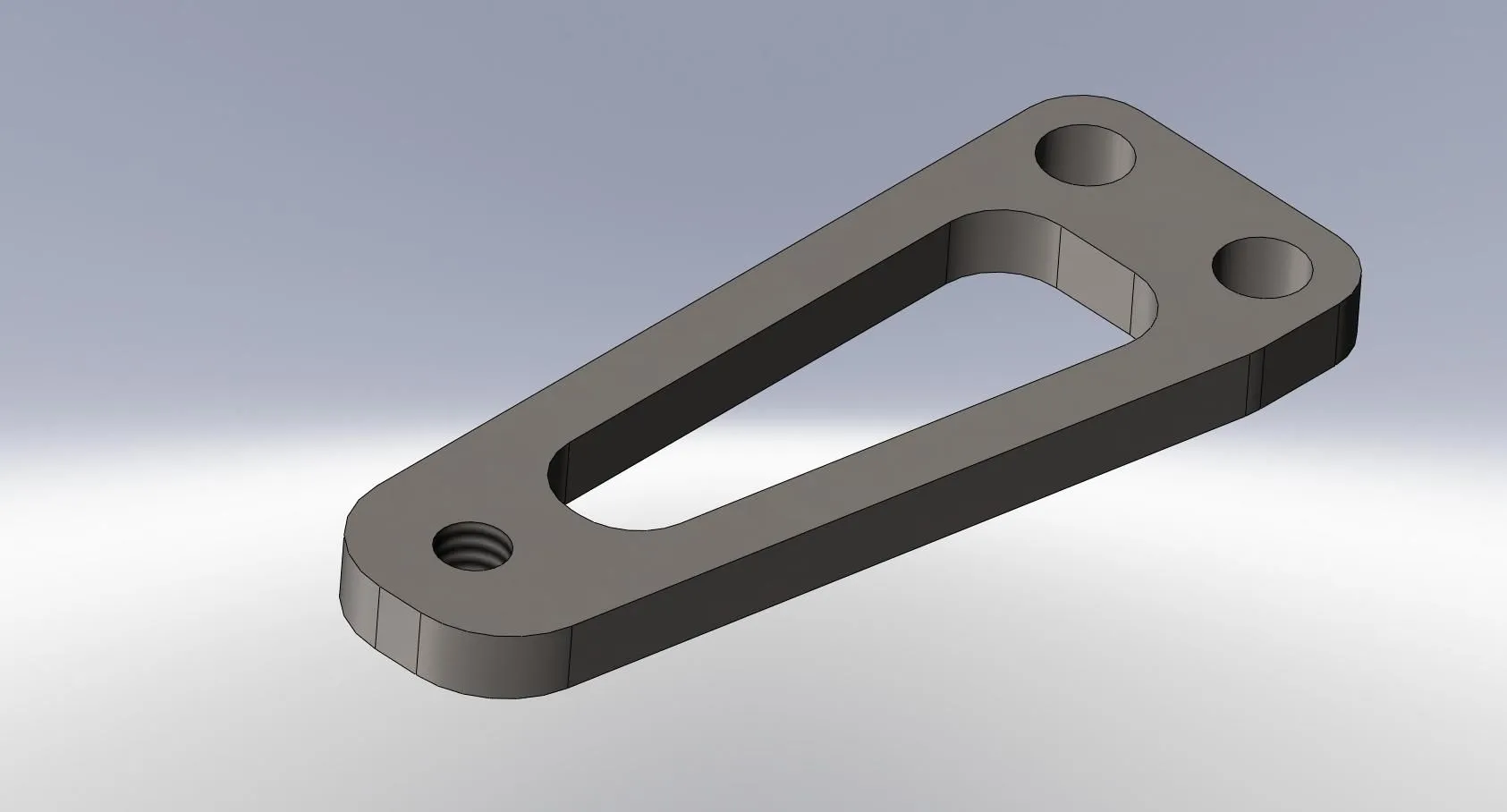

I might be posting in the group-buy section soon to see if enough people would want to buy titanium (or aluminum or steel) STS plates and shifter weights. I can work with a local machinist to use his water-jet table to possibly have the shifter plates look like the attached picture. It will not be inexpensive, the Ti material could be $10-$30 per plate and the water-jet time is $100/hr... I'll post here when I figure out more details and get a better handle on the cost of everything and start a group buy thread.
