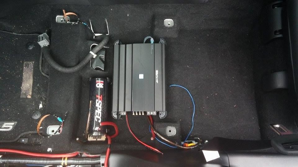

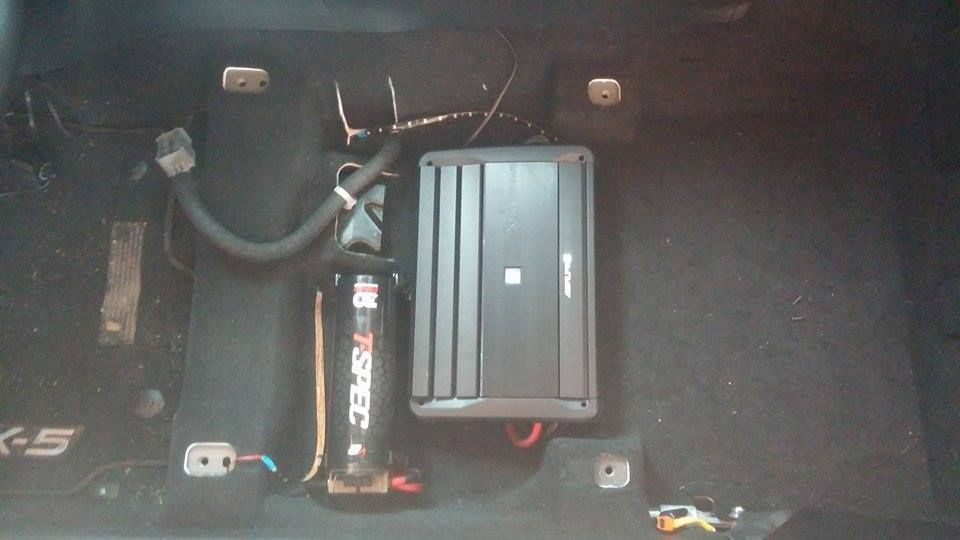

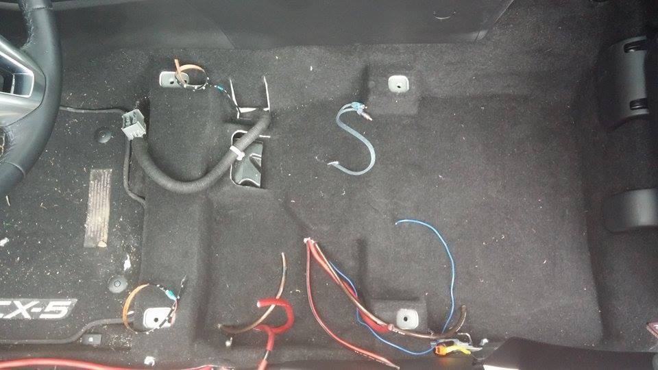

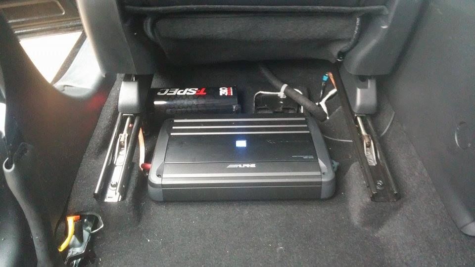

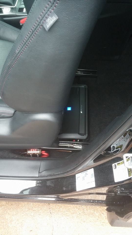

amp sub and cap installed .
Anonymous MD
2016 mazda cx 5
finally got the amp capacitor and sub wired up .
alpine mrx-m110 1100w amp
alpine type R 12" 1000w
t spec 3 farad capacitor
would have better pics if it didnt start raining on me :-(
Nice install. I notice that seems to be the spot people like to install the amp. And it is a good spot. I'm just curious to know if there is any heat issues.
Did you use a line out converter?
yes i used a cheap kicker one . if you do it it will work but i want to swap it to something better . :)
shouldn't have a heat issue i dont think but my plan is to make the vent extend past the amp or block it off . when i do that ill let you know . for the summer im gona leave it alone so it has the AC . so far the amp doesn't get hot that i have seen . :)
