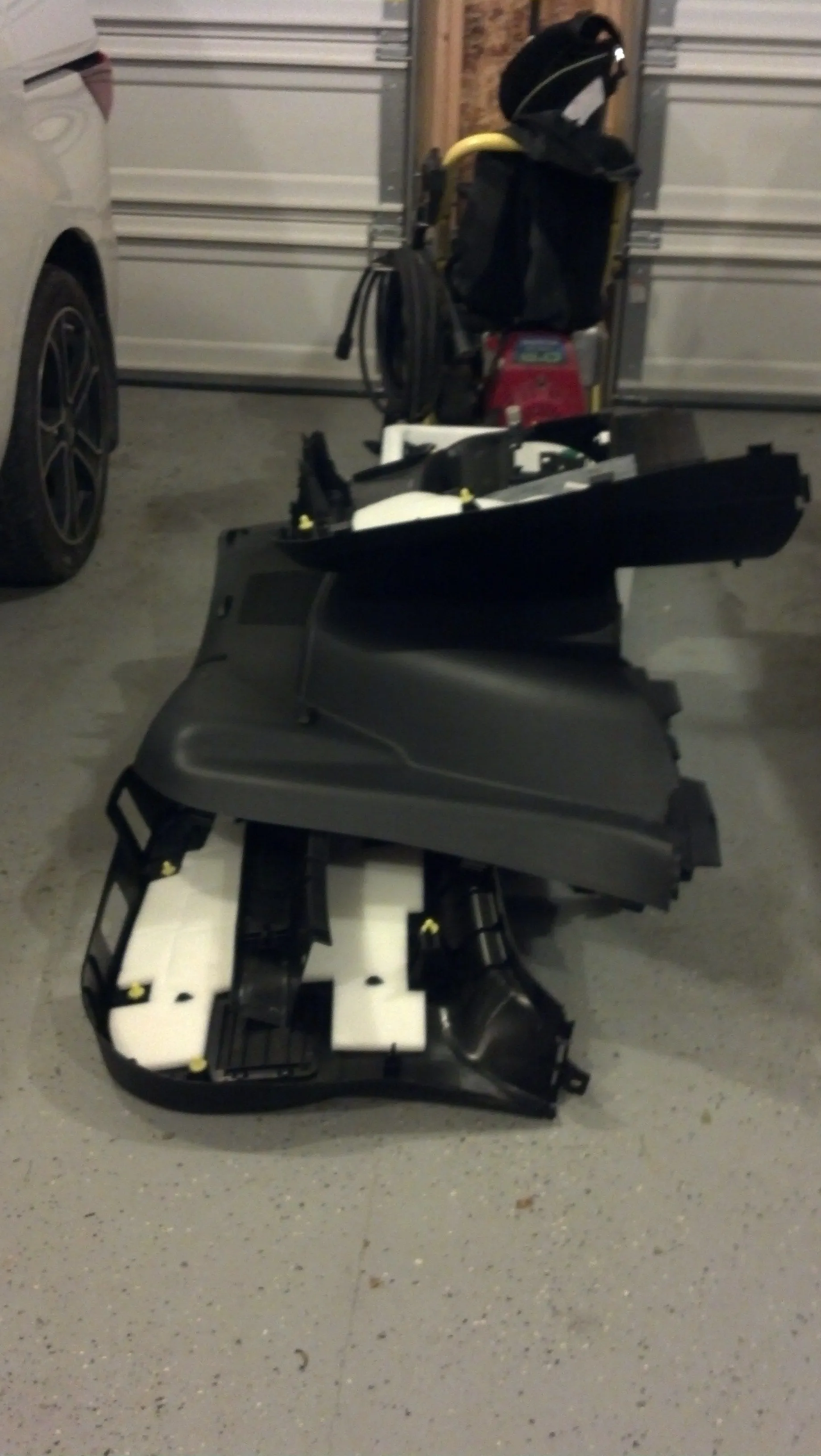

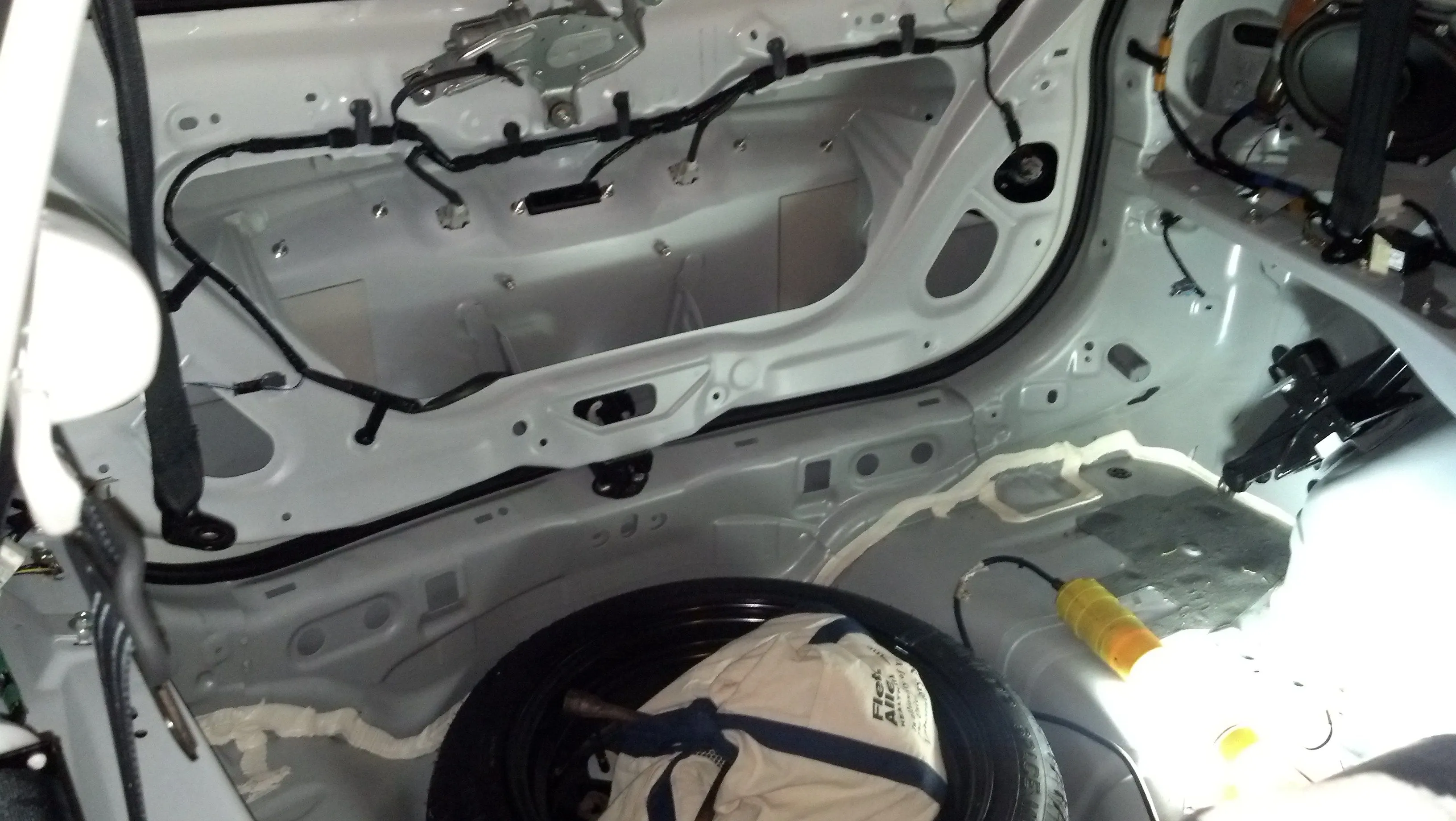

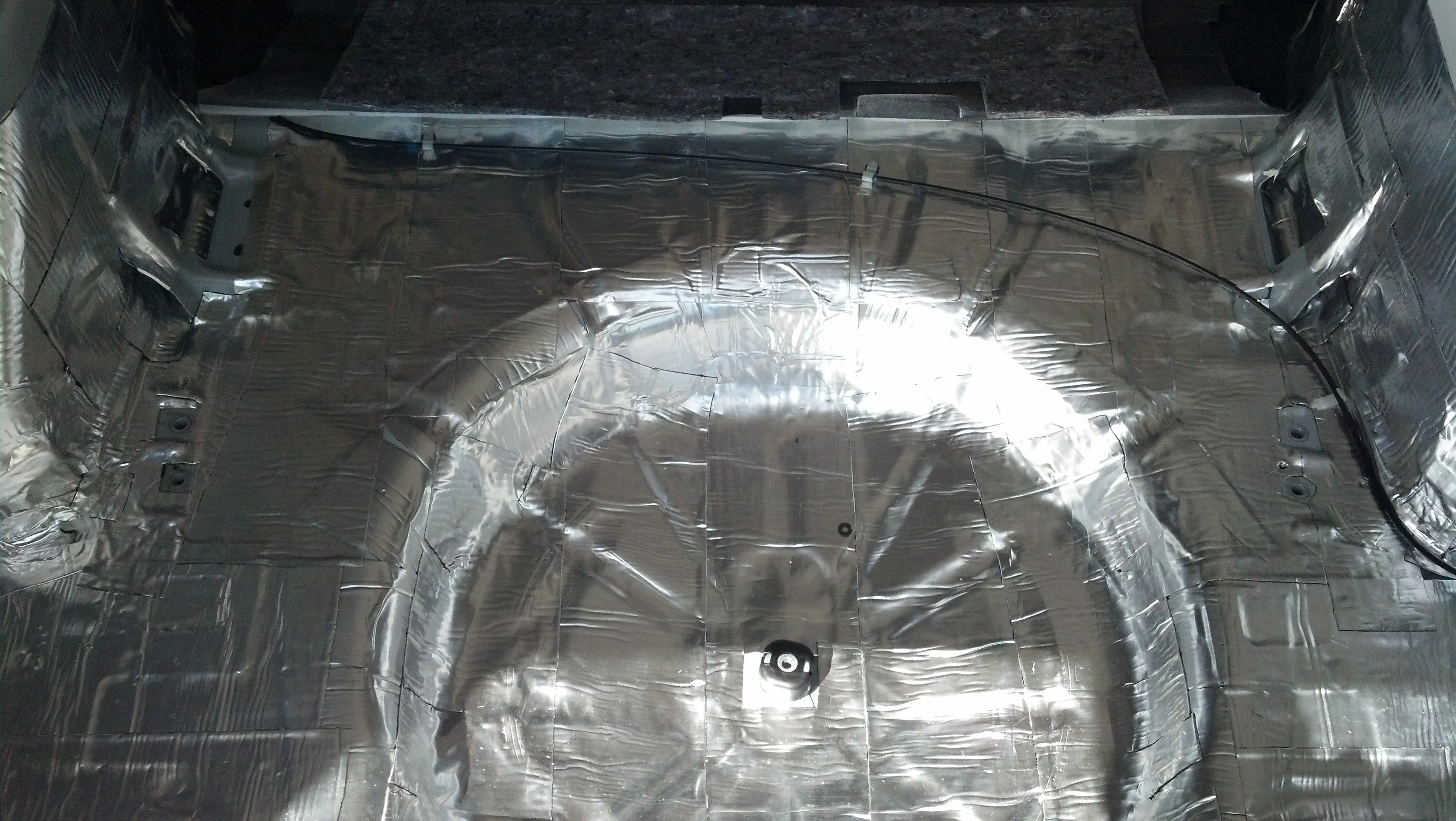

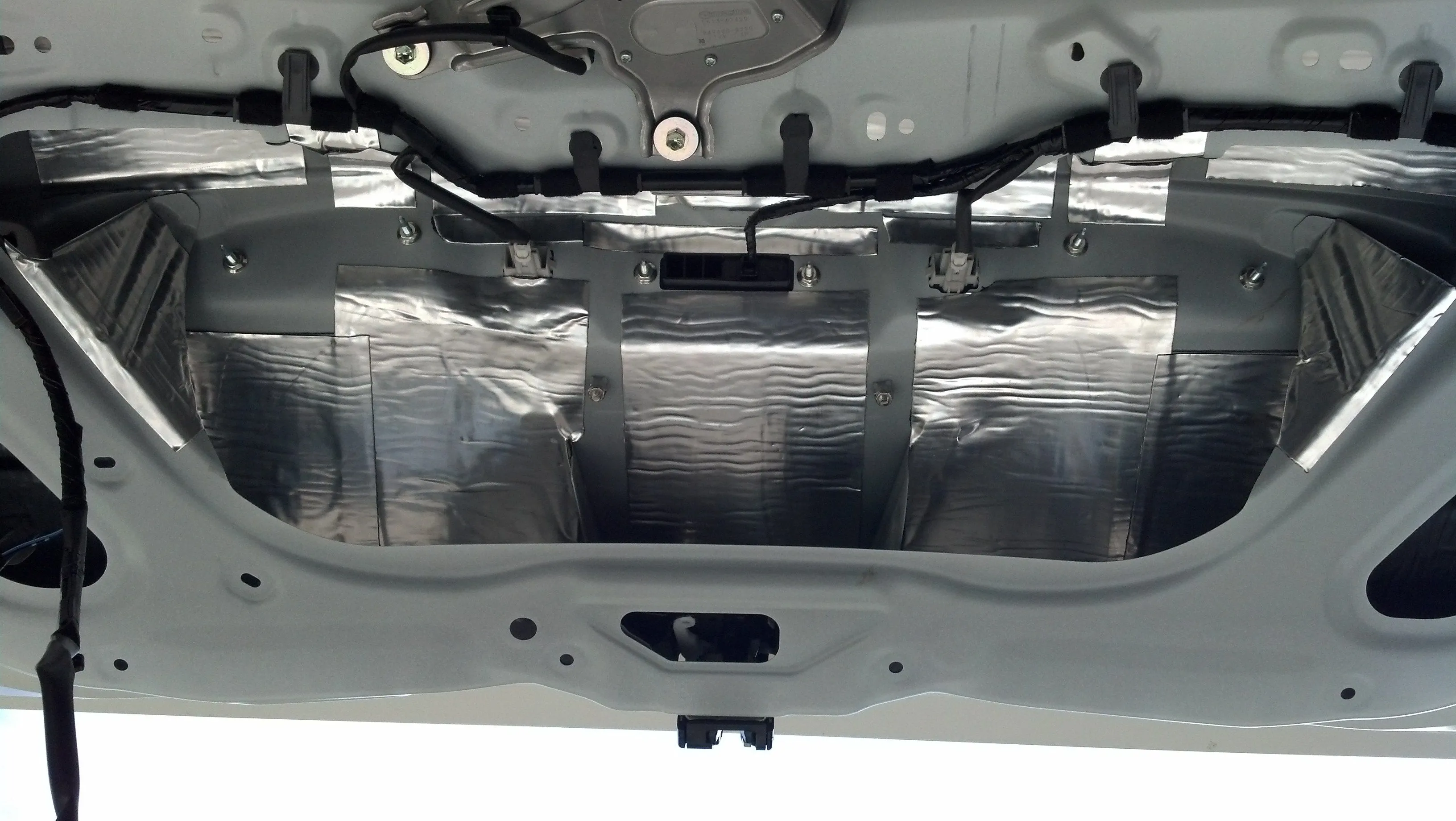

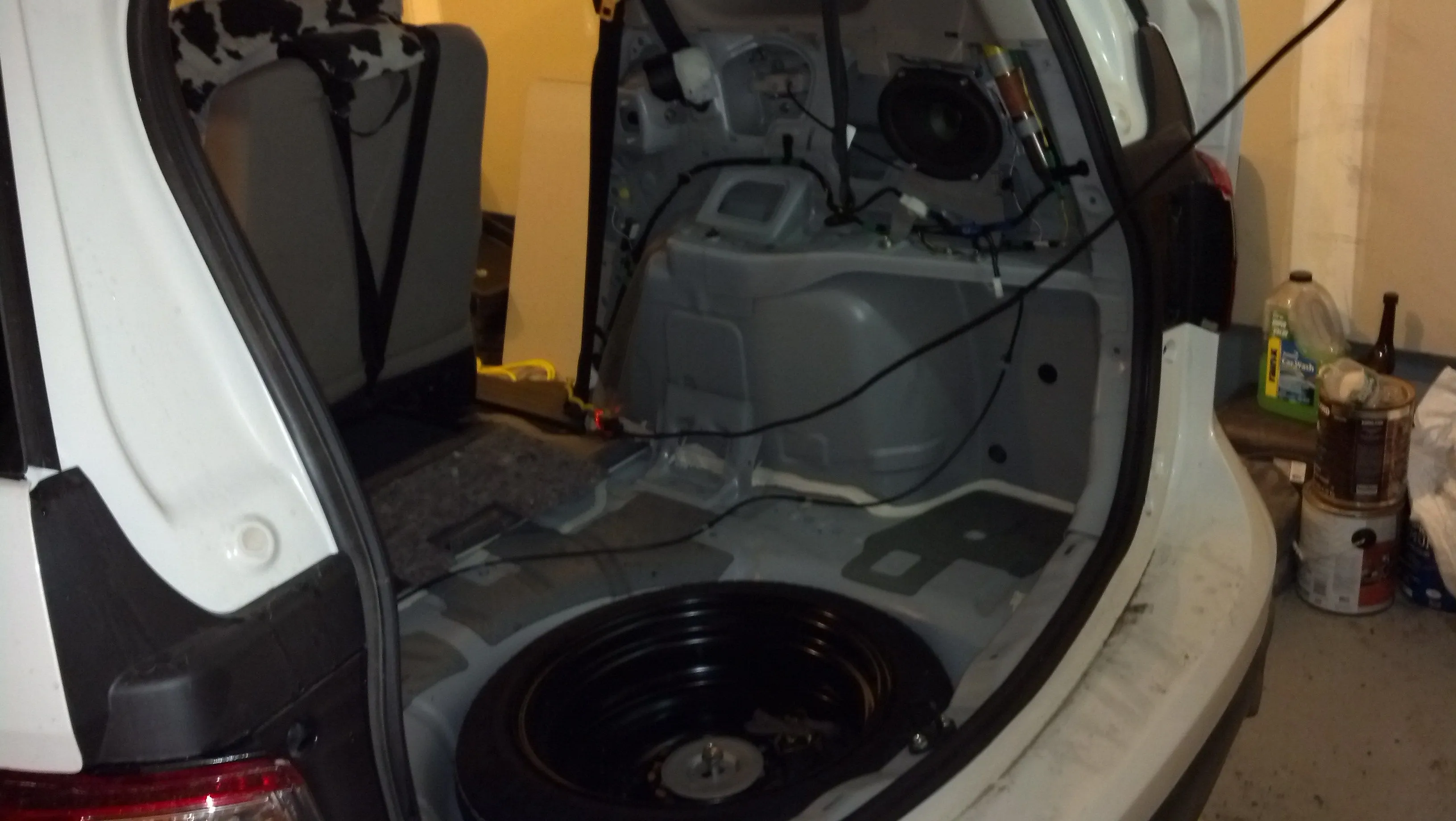

I haven't yet installed any of it, but I did disassemble the entire rear portion of my Mazda5. Removed the rear seat, disconnected the rear seat belts, popped all the interior trim panels out, and rolled the carpet forward. I'm planning on taking off a door panel to see how easily this could be applied in there too because I have read that lining the doors yields the best results. Pics of the work done so-far are below.
