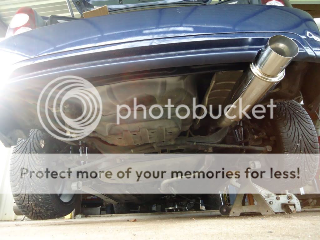

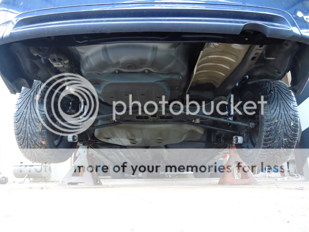

Been working on this thing for too long now - finally drove it again - with the exhaust done. Just need to finish a few things and she's road worthy. STill have an issue with the transmission - but that'll work itself out with more debugging. PICS!
...no exhaust....
and like magic - INSTANT EXHAUST!
and a small clip of the exhaust note - it sounds yummy!
Damn, that sounds sooooo good!!! Glad she's coming along, mate. (2thumbs)

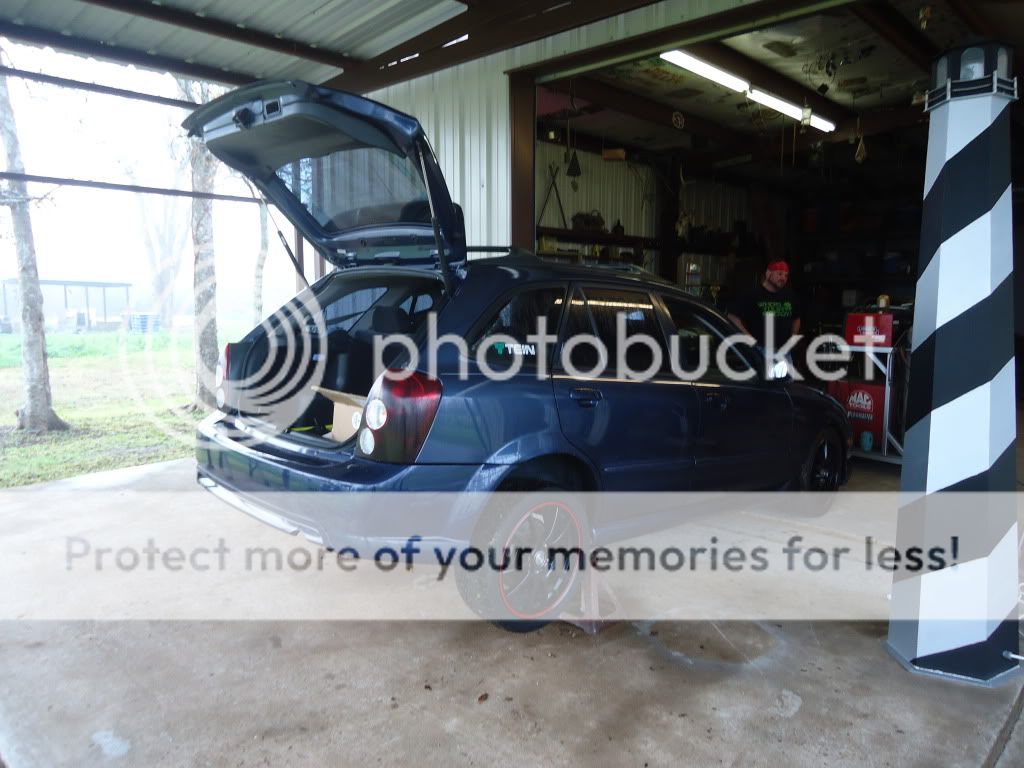

short (very short...) flyby.
