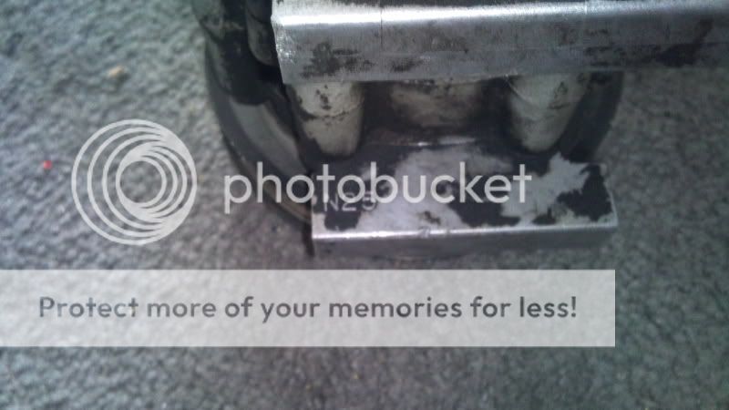

alright - here goes. KL-P5-take2
Oh I was meaning the metal pipe to metal pipe, not pipe to hose. There is a tool my dealer has where we can cut the rear section of the A/C system of and reconnect a new section rather then remove the complete system that otherwise is in good working order. I would think the same could be done here to allow the 626 end to be attached to the P5 pipe.
Silverfox, you're onto something I do believe. So if I understand this right - just have them cut off the old aluminum ends (P5) that are too large I.D. - and have them attach (weld/solder/join....somehow) the PGT/MX6/626 ends on? That seems about the easiest. I have a heliarc at my disposal, and the machine is magnificent...it can cold weld with the power turned up to a whopping "0".
Yes that is what I am talking about, if you are able to weld thats great and may be the best option for you as it is all there infront of you. I am trying to get the info on the tool we use at work (I am not there atm)
I'd really appreciate the info fox - that's one thing that is pretty great about this board. The information trading is pretty good!
I'm going to exhaust my sources for a/c compressors and a/c lines then ill see if anyone can do that, I didn't think you could weld aluminum I thought all you could do was bond it which is incredibly weak
you can heliarc aluminum - which is plenty strong for what we're doing here. My only issue would be whether the material (piping) would be thick enough to make a join.
its about 1/8 of an inch think at best
those dont work what compressor do you have?

also milli use different compressors than the 626, probe, and mx6
so i think im going after a milli compressor 95-98 i believe
