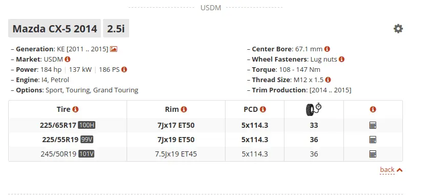

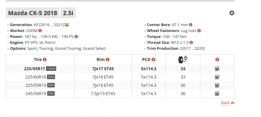

Found a chart on wheel-size.com, used a 2014 and 2018 for comparison.

It seems the offset is minimal...As long as the bolt pattern and bore is the same, I'm fine with the rest. Plus 17inch winters are cheaper than 18s.
They will bolt up fine, as posted by Mazdiod2 earlier model wheels have a slightly different offset.
