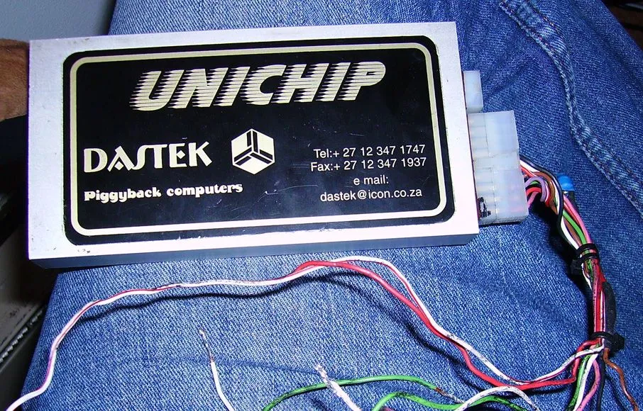

so has anyone seen this kind of unichip before?
i just got today, im just confused on how the rewiring is done tho...
...looks kinda old doesn't it, meh
oh btw, i want to put this on my 99 pro ES 1.8 (non-turbo); think this will work?
