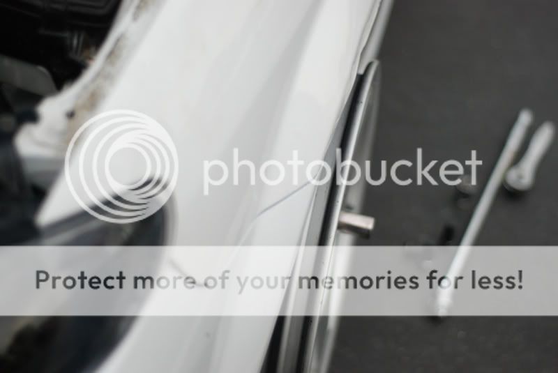

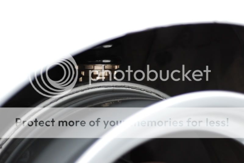

Aggressive fitment anyone?!
BBS RS 17x9 +28 w/ a 205/40/17 Falken 452 :)
doesnt get much better then this
front are at 0 camber and rears are at -2.5 which is perfect!
and without the side skirts really shows the stance
enjoy
whats the clearance difference between a pro5 and this? i really wanna squeeze 9" in there, but idk what offset i need to find
from what iv read theres just a small difference in the rear quarter, maybe 2-3 mm difference?
and iv talked to dj dub who test fitted some 9's and i actually did some extensive measuring earlier today, and iv come to agree that a 9 inch wheel with a +30 would be the lowest offset possible, before u hit the strut/coilover. so i think that the offset should stay between +30 and +20, before it starts lookin like funkalicious when he test fit those BBS's.

Dude, I tried on 17x9 +35 and the hardly poked. +30 will be great
Pick up where I left off son ;)
this is all i got as far as pictures......the +30 will BARELY CLEAR by maybe 1-2 mm, lol leaving no room for camber......but if u fit it as +30 it should work with a proper stretch, anything lower will prob need some camber, have u seen funkalicious' set up? its hard to compare though since he modified his quarter panels
edit: O yea man i should tell u the measurments iv takin are on my car, a sedan, and i dont have coilovers, im running modified struts and sleeves, so the clearance to coils might be different, idk
