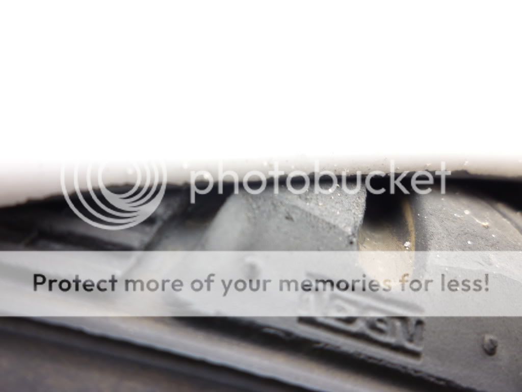

I have the BC coilovers and beleive me...they are VERY STIFF.. i even have all my fenders rolled to the max and have removed some of the inner fender liner.. i will take pictures of where i rub.. i rub straight frame..and proud of it
Ok, I gotcha. You said you rubbed the fender earlier, and I didn't really see how that was possible w/ a 17x7 +50. I was pretty sure you meant your tire just flat out rubbed the top of the fender well, lol.
This is just one place i rub... and this is not full turned...with no one in the car.
In the rear, I can barely fit a credit card in between the fender and my tire. I rub on every thing. Especially on Washington's bad ass roads.
Twis - How are your tires directly under the fender @ +50?
BTW, & this is directed @ everyone, not anyone in particular... Everyone's roads are bad, not just yours. ;)
