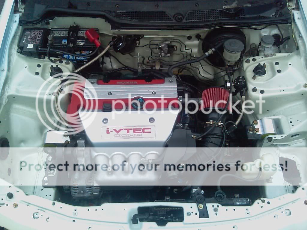

I dont mind a nice well built one, but where I live they all rusted multi colored ones and it pisses me off, but they are quick, I just dont like how they build them here... all motor and no cosmetic at all, I like pussy, not balls, girls want nice cars, not crappy looking fast ones lol
mine isnt rusted, even my bay is painted n its a 94
