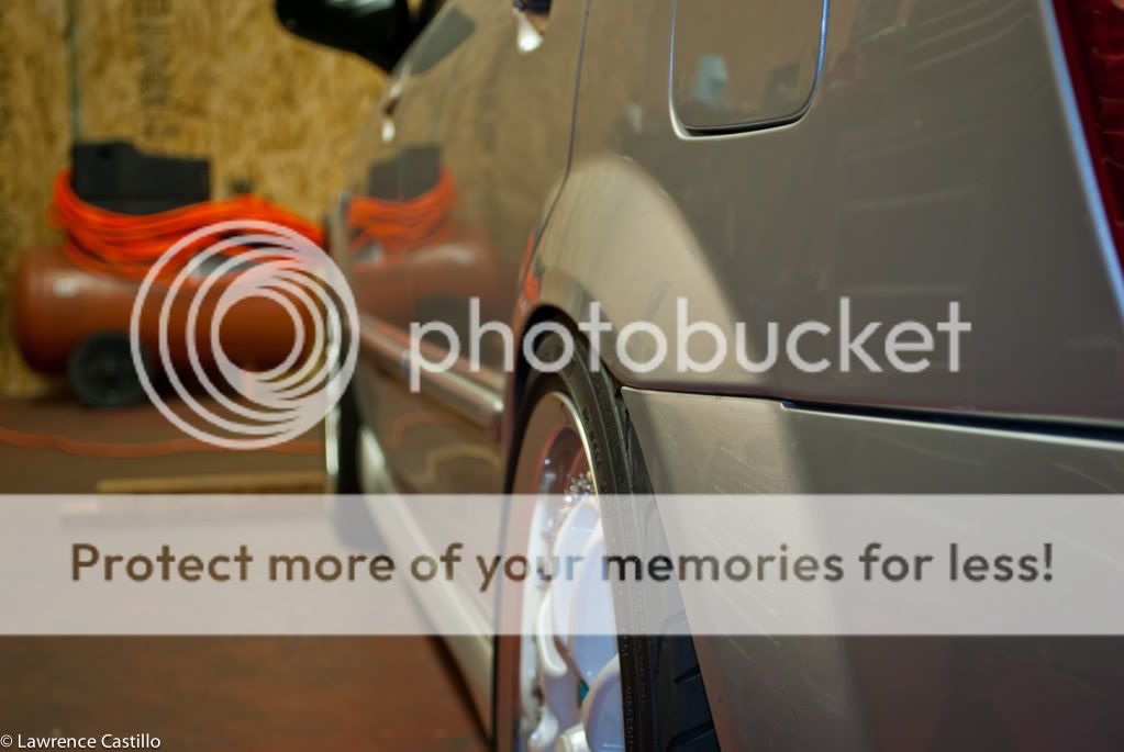

Here's a "down the line" shot of the fitment. Thanks to Lawrence C.
17x8 +35 with a 215/40. I have about 1.8 degrees camber all around. Fenders rolled flat and slight pull in the rear (hard to see in that pic). I cut the crap out of the bumper tab, but I just realized I'm rubbing on the front lip of the rear bumper (in the fender well).
