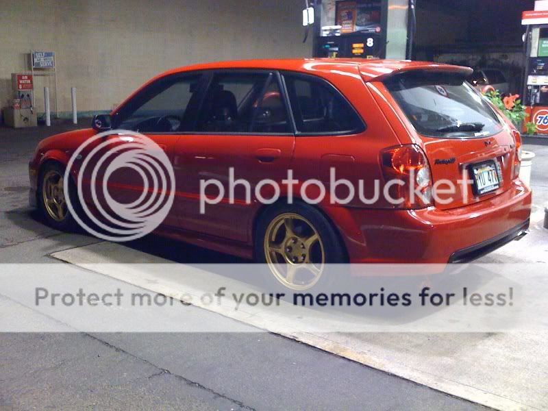

Does this count?
They came off an RX7 lol. I'm going to eAt them up at scca then pick up some 225/40s

Rims are reinforced Rx7 (FD) rims 16x8 (not too sure on off set.
