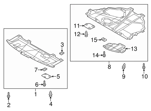

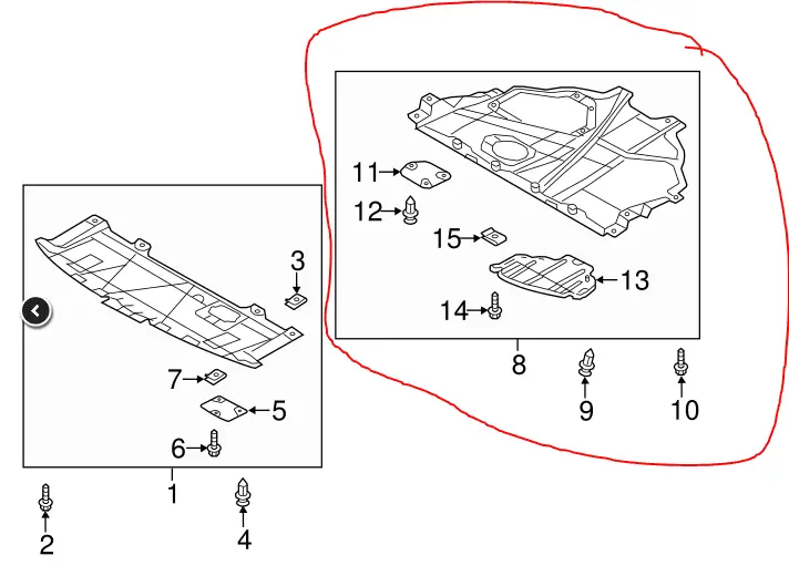

I tried to use the same rivet on the oil filter/oil drain underbody cover but it didn't seem to fit so I'm not sure what size that would require.

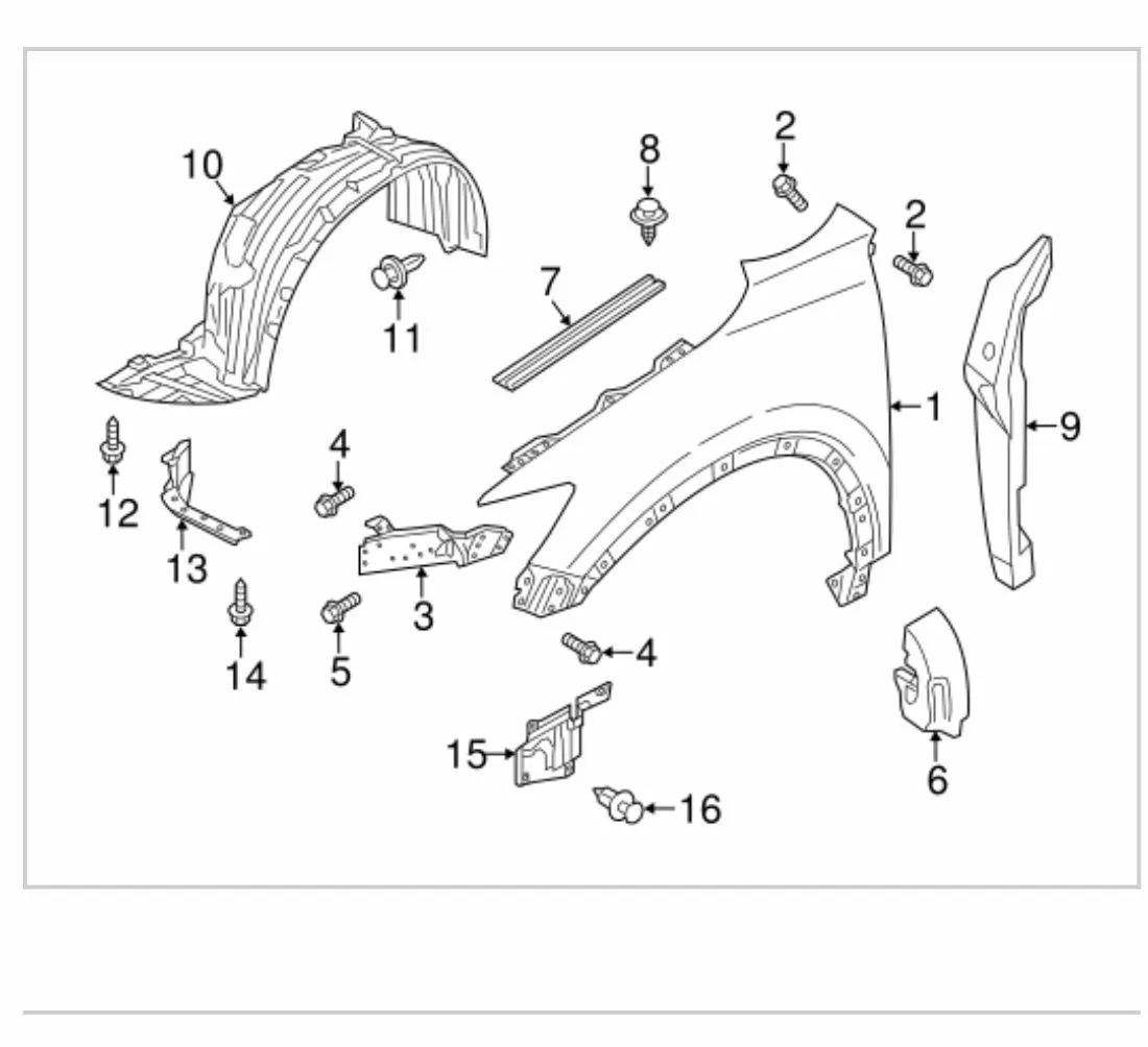

Mazda uses many different kind of plastic push-pin fasteners and rivets, hence too many OEM part numbers which is very confusing. For gen-1 CX-5, the part number for easy-missing plastic push-pin fastener (#12?) for oil filter access panel (#13) is BGV4-56-145, although the description says “Radiator Support Splash Shield Clip - Mazda (BGV4-56-145)”.
In fender liner area they have:
#8: Body C-Pillar Trim Panel Clip - Mazda (p/n: GJ21-68-885B-02)
#11: Splash Shield Rivet - Mazda (p/n: L33X-13-209)
#16: ?
p/n L33X-13-209 OEM plastic rivet is used the most on CX-5
So use Mazda’s part number to search after-market plastic push-pin fasteners and rivets, and most likely you’ll get the right one.

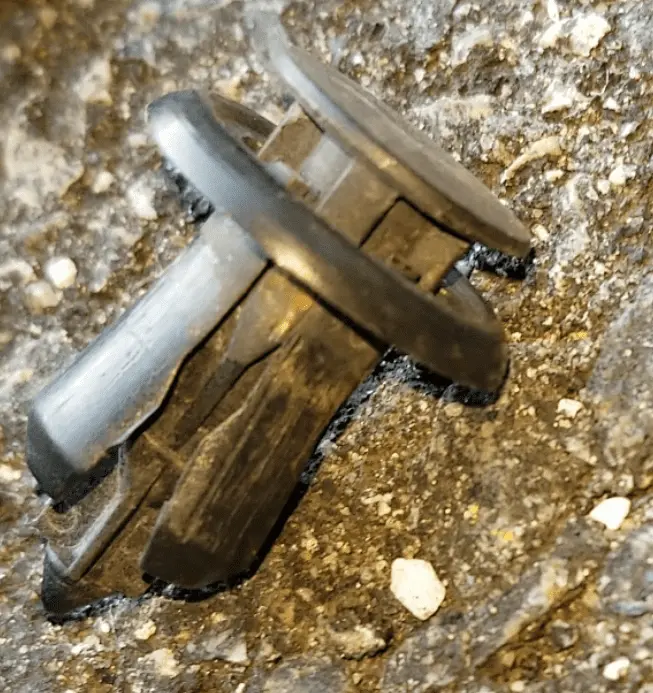

After finding enough loose plastic push rivets on underbody panels and wheel well liners, I purchased the attached kit from the "big A". The included removal tool works good so no more screwdriver and needle nose pliers. And I found that adding a flat washer of some sort (I used spare 12mm oil drain plug washers from previous cars) under the rivet head makes for a tighter joint. I only used 2 sizes out of the kit so far but I think some of the smaller one's would work for interior plastic panels and elsewhere. Admittedly a small victory but helps eliminate extra trips and high prices for such simple items. Although mentioned above, this GOOACC kit has more sizes and includes the tool.
