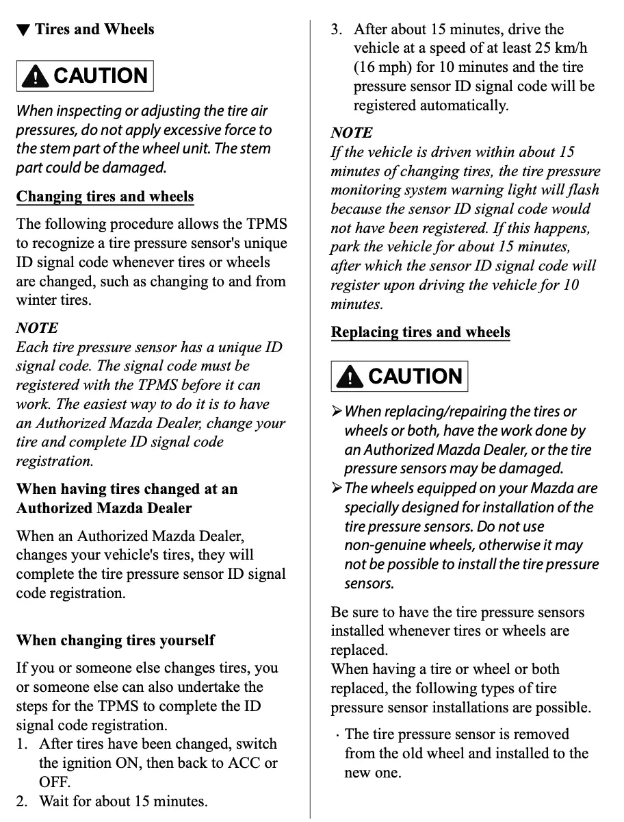

There is a process you need to go through when swapping tires/wheels to get the car to recognize the different TPMS devices.
That cautions hurts Mazda's credibility. What's so special about their wheels?
I have aftermarket wheels and my original Mazda TPMS sensors, zero issues. I was cheap and didn't put sensors on my winter wheels. Next time, if there is one, I'll use aftermarket.
Just typical corporate CYA speak. I have aftermarket wheels and OEM sensors too, with no issues. But if someone were to get an aftermarket set of wheels that doesn't play nice with the OEM sensors, Mazda can refer to this to show that the sensors are meant for genuine Mazda wheels only.
