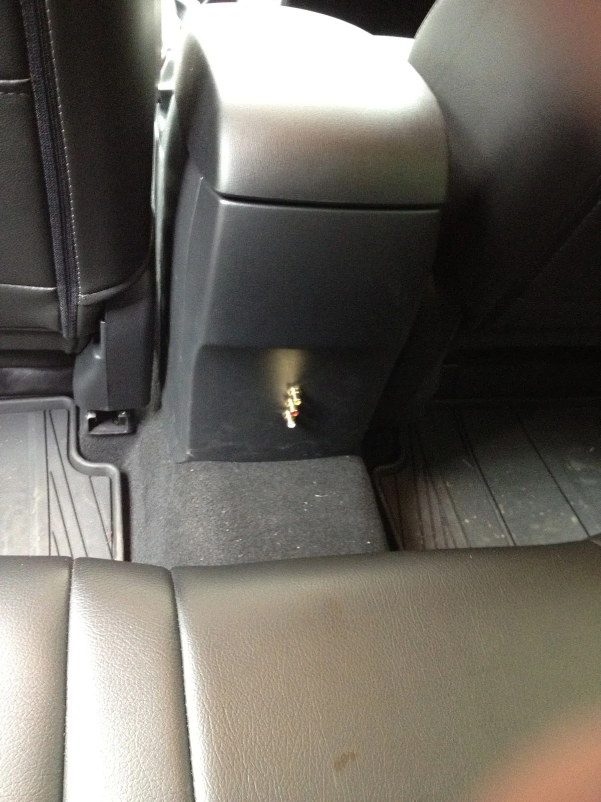

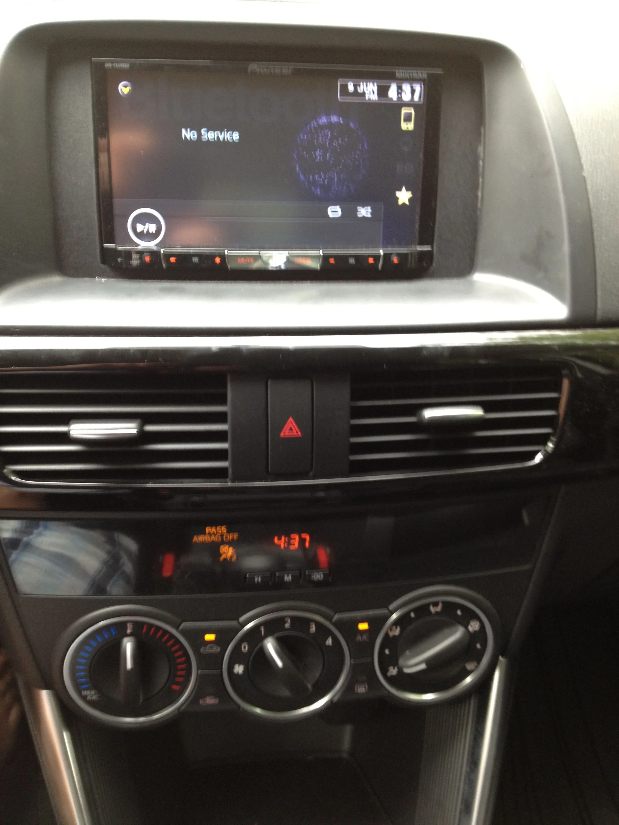

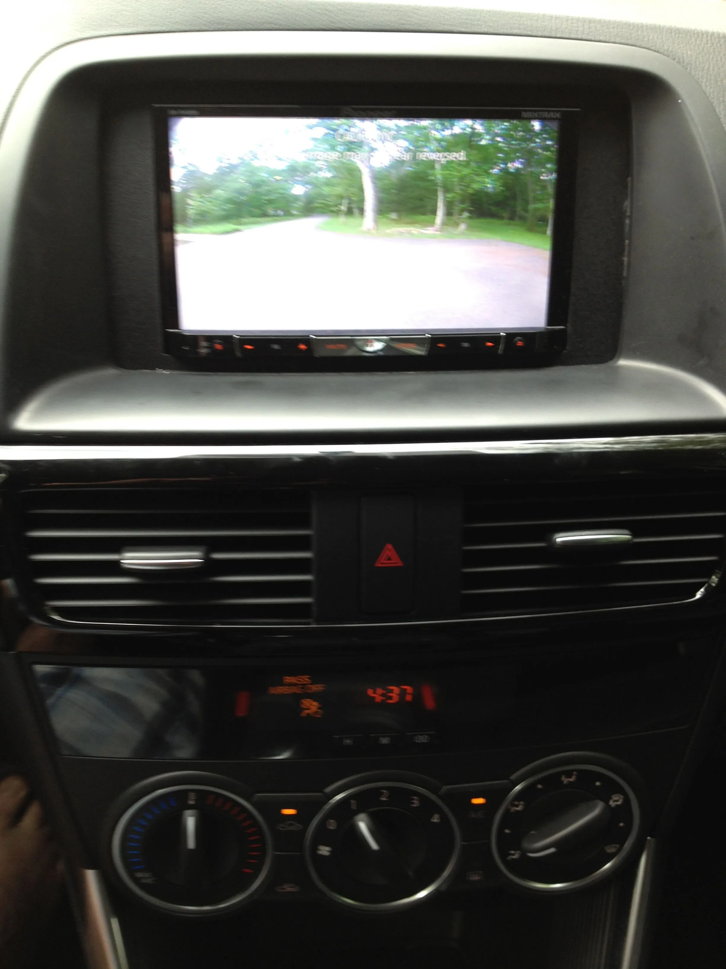

I had installed a double din Pioneer which went in without modifications. The installer hooked up the steering wheel controls without any trouble using an available adaptor. Bluetooth came with the unit and installed mic neatly above visor, works great. Also included backup camera, which works both when I put in reverse and manually. Nav works well through my iphone with 3rd party app. I also have rear stereo and video output for passengers in the back seat. All the toys w/ the six speed. Biggest headache is that there is currently no after market adaptor for the antenna and we are waiting for Meta or others to come out with one so I can enjoy HD radio with this unit. Total cost w/install 2000.

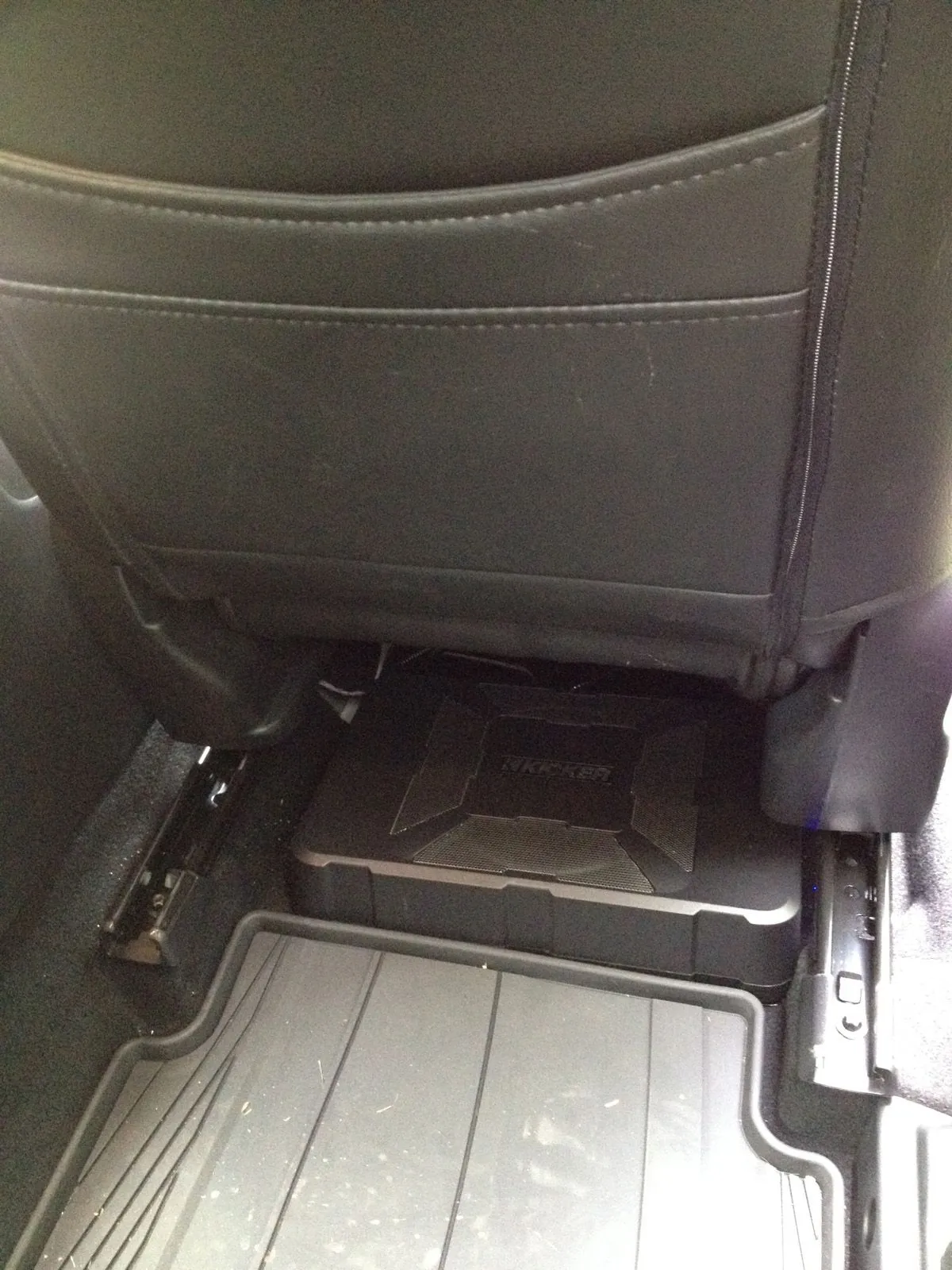

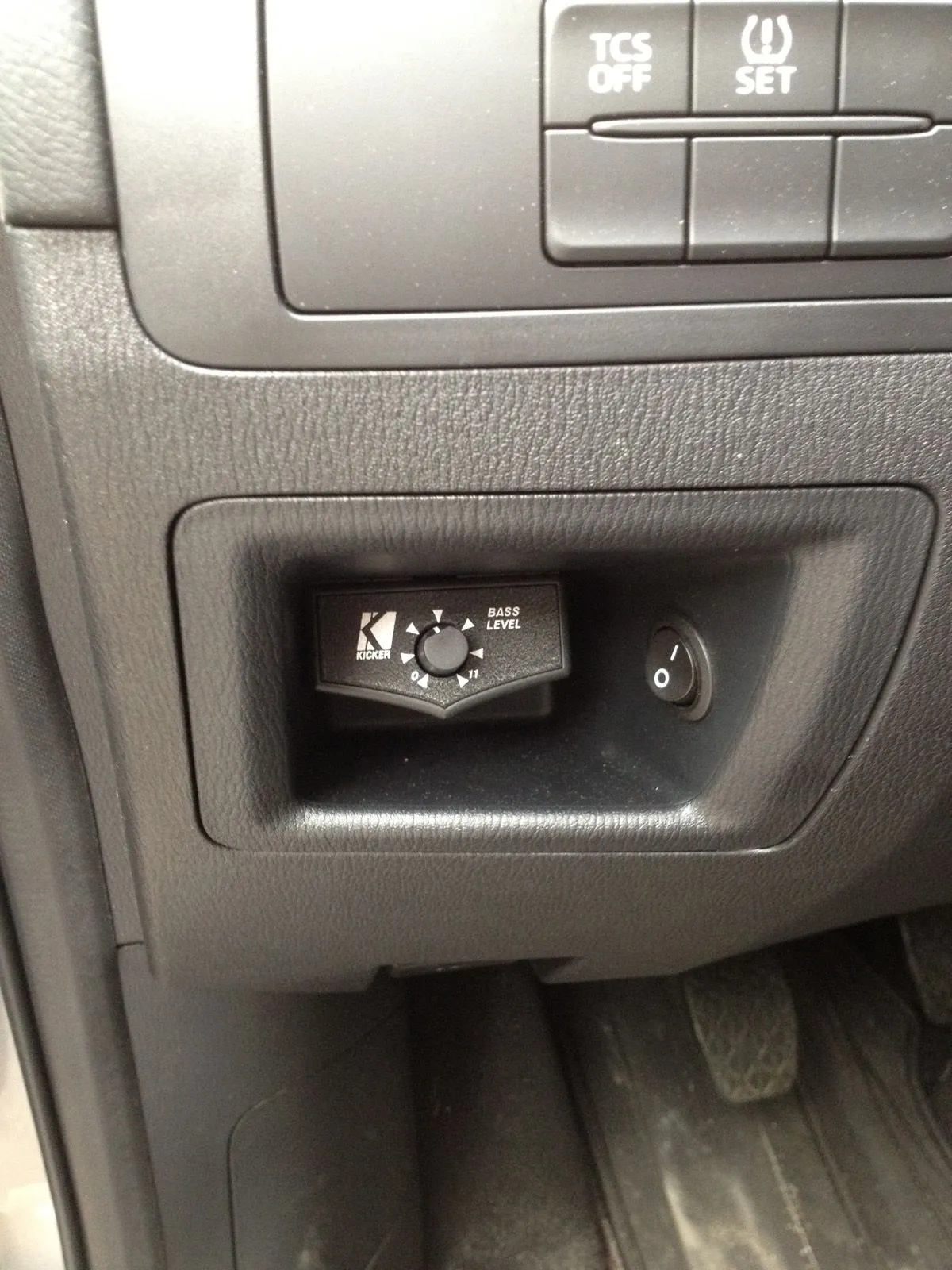

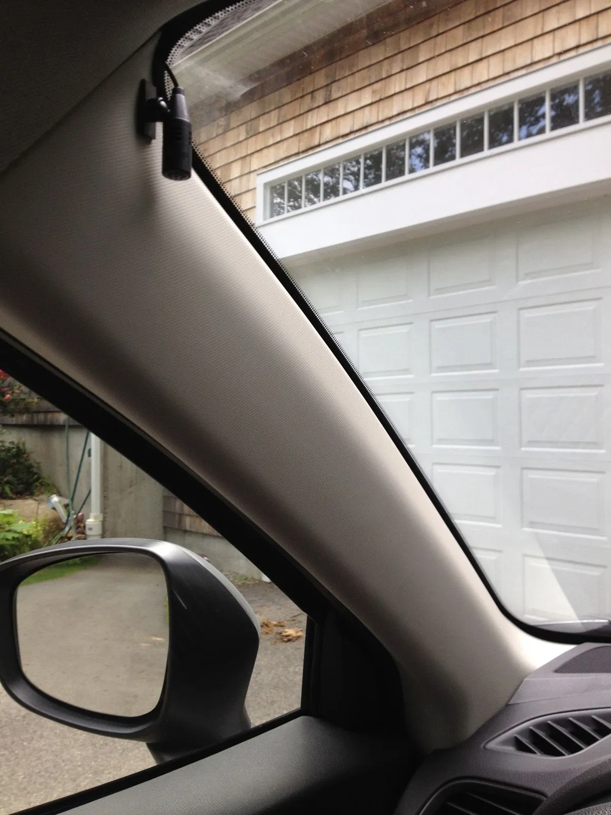

Here is the microphone locationIMG_0161.webp and the subwoofer with seat all the way upIMG_0165.webpand the switch for the DVD over-ride switch and subwoofer controls.

IMG_0163.webp This is the rear video and stereo jacks, Pioneer features a "zone 2" with this unit where you can port video and audio to the back while mirroring or playing something different in front.
Nice work. Why did you go with the surface mount microphone instead of wherever the stock placement is (in the overhead center console, I believe)? Also, regarding lack of an adapter for the antenna -- does this mean that AM/FM don't work or work poorly, in addition to HD?
