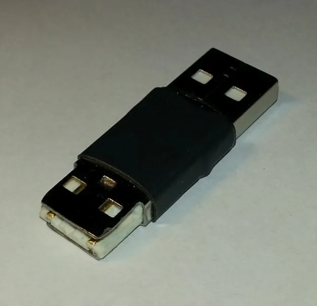

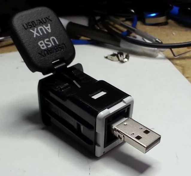

Second, you can use the stock USB connection, but you have to run a USB cable to it and create a connector-adapter yourself. I've done this, but the steps are tricky - you have to be very handy with a Dremel - so I hadn't done a writeup (though I do have a prototype adapter I might be prepared to sell :))
If there's enough interest I can write it up.
Prototype was a male-male adapter, it worked fine, only the female USB cable from my head unit was just 6" too short to reach! So I had to repeat the work to create a 1ft male-male adapter cable instead. This is the 'prototype':

Works like this...

Works like this...

Redbaron, definitely write that up.
I may just fab up a two port insert so I can mirror my phone/app radio and use my ipod at the same time.
