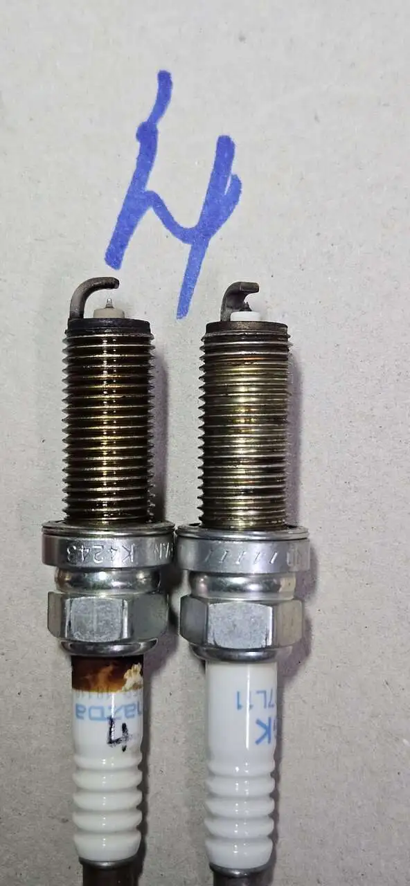

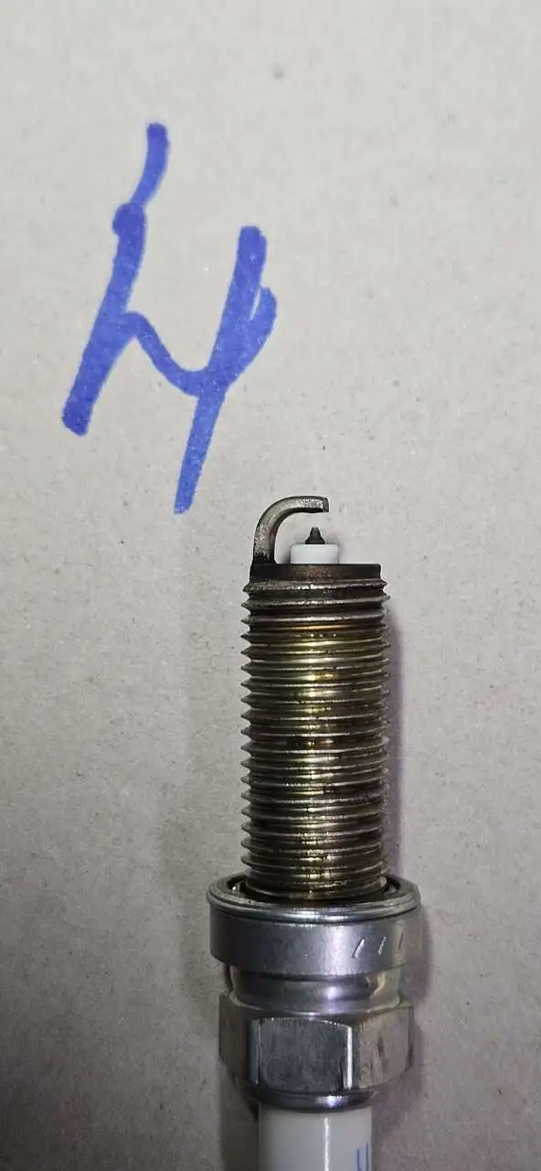

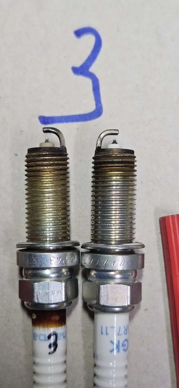

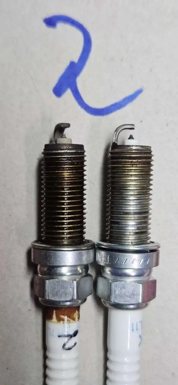

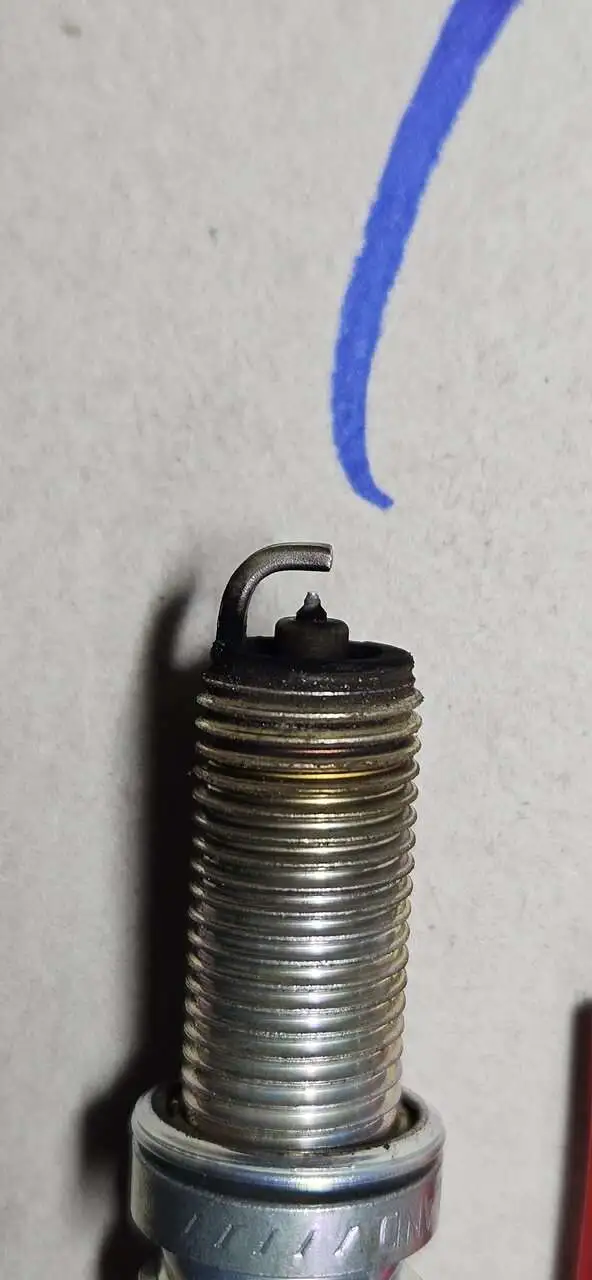

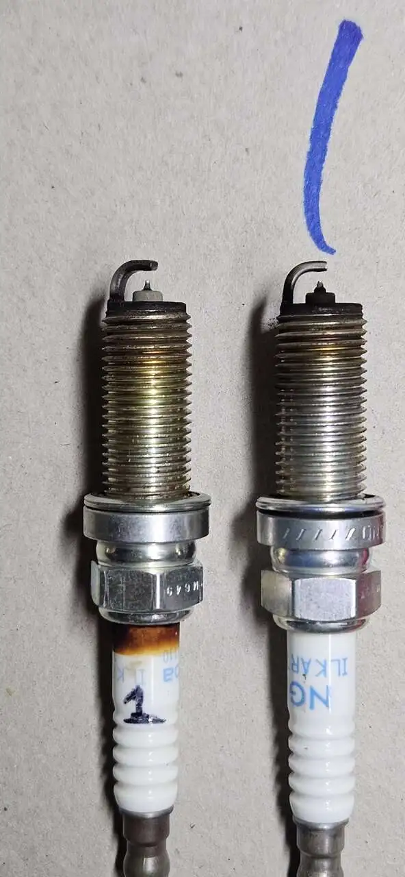

@AL Cx5 Got the plugs out and posting the pictures.
I also had stored the OEM mazda plugs that I was using until 57,000km and now have switched to NGKs . Current odo at 59000km.
Cylinder 1: looks very black compared to the others. Have not had too many misfire counts from this cylinder.
Cylinder 2:
Cylinder 3:
Cylinder 4: The one with the misfires

Cylinder 1:
Cylinder 2:
Cylinder 3:
Cylinder 4:
