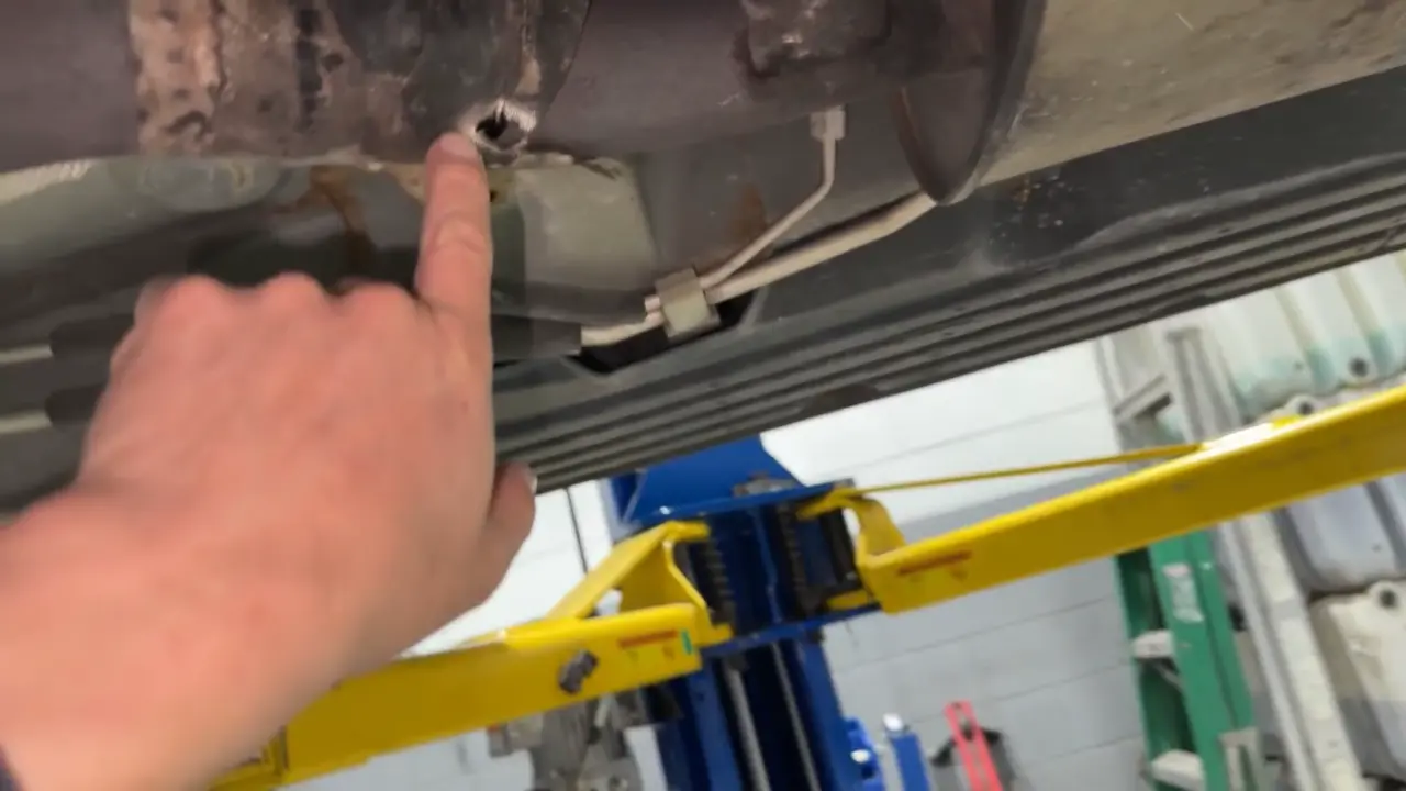

We have 2010 CX9 Touring that has lived in Chicago for the last 14 years and finally needs some exhaust work. Basically everything forward from the mufflers.
What’s out there aftermarket wise that you guys like? Doesn’t need to be high tech or super performance. My daughter in Austin is the main driver now
I used Walker exhaust piping, and ANSA rear mufflers on my wife's 2012, all purchased off RockAuto
The mazda muffler lasted 14 years in Chicago weather. That is why it is so expensive. But i agree it is overkill at that point, only buy what will last for the remaining life of the vehicle.
The mufflers are still pristine. It the intermediate pipe that really seems to be the only culprit. My daughters pretty mechanical but still hard to diagnose from 900 miles away
My wife's mufflers were fine too, with the exception of the flange connections to the y-pipe. All rusted up at the connection, and weren't coming apart without cutting. The replacements were cost effective enough to just buy the whole lot. Made installation much easier, since I didn't have to wrestle with any old rusty parts. Cut the old off, then bolt the new on, and done.
