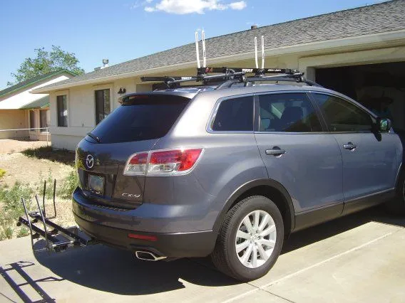

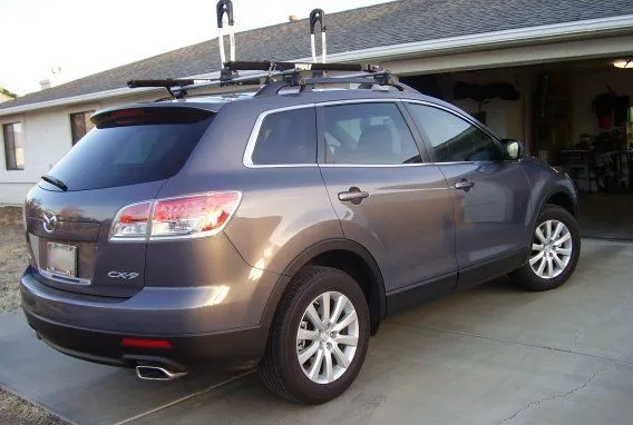

You can see how I did four bikes. I already had the 2 bike hitch rack that I fabricated, which is why I put a factory receiver on my car (1 1/4"). The roof system doubles as a two kayak stacker, so it worked well for me. In the second photo you can see the wheel forks with the kayak caps in place. In case anyone else has boats and bikes.
