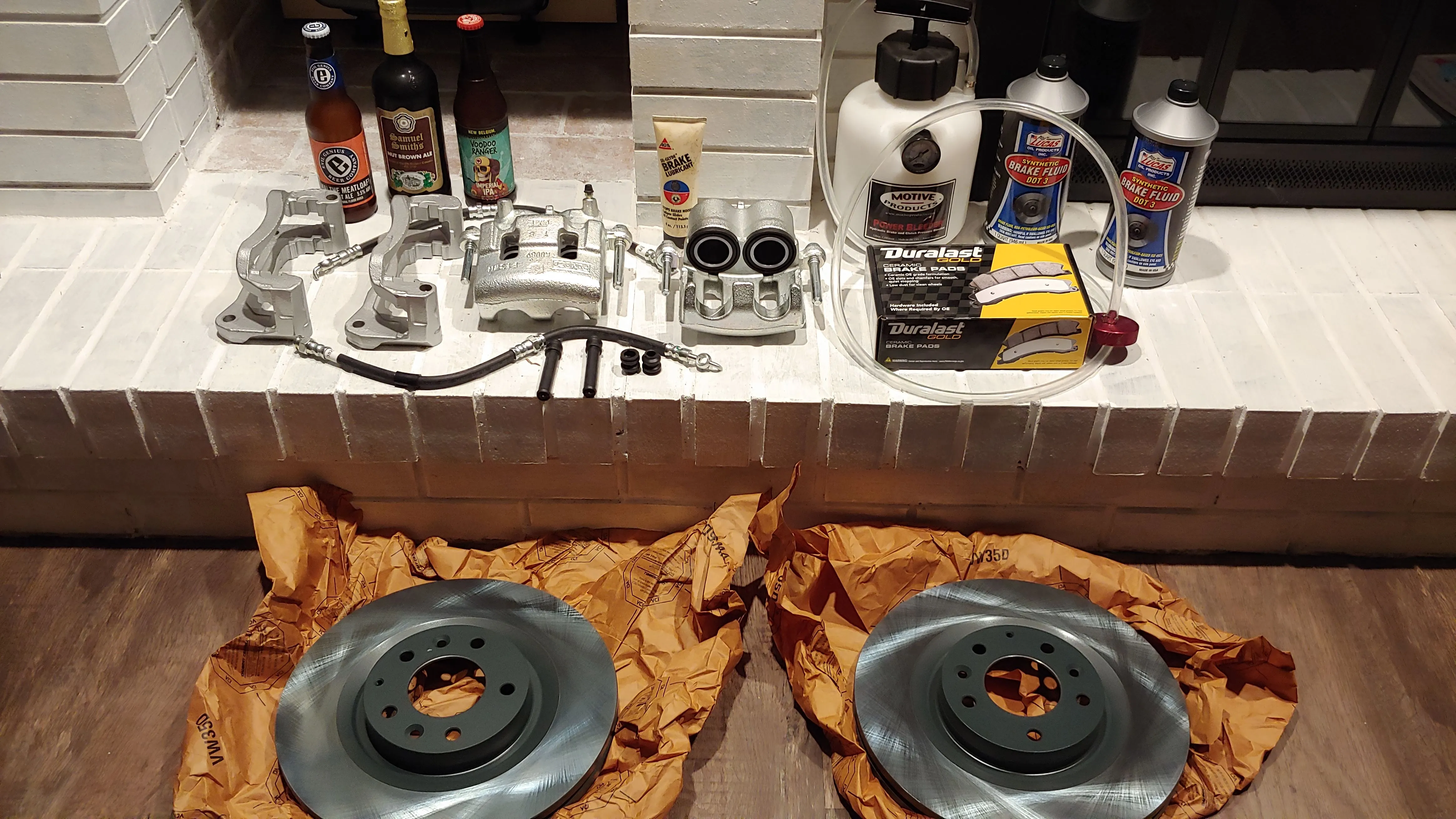

As a follow up, the right front caliper pistons were sticking, thankfully the problem was not the hub/bearing. Ordered NAPA "coated" "Total Eclipse" calipers. They arrived and are very poor quality. Appears they are Cardone reman calipers with black spray paint. The paint is already chipping off all over the place exposing the bare iron sand blasted surfaces which will immediately rust. Additionally, the pistons have been sanded down and re-used, and are heavily pitted and have slight rust already, before even putting them on car. The outer seals feel really thin and inferior. Napa No-Go. I am returning them and found new oem calipers (which btw are zinc plated) for 155 a piece from a Mazda dealer in Brunswick, Ohio. Trying to get all these parts before the virus knocks shippers out of the equation too!
Job completed last weekend. Napa brake hoses, new oem calipers, duralast gold pads, auto zone boot kit, Sil-Glyde grease, Napa rotors, Lucas brake fluid. I brushed/cleaned/sanded the brackets and painted with caliper paint. Greased the rear pins too, bled all 4. Turned out great. Smooth!
