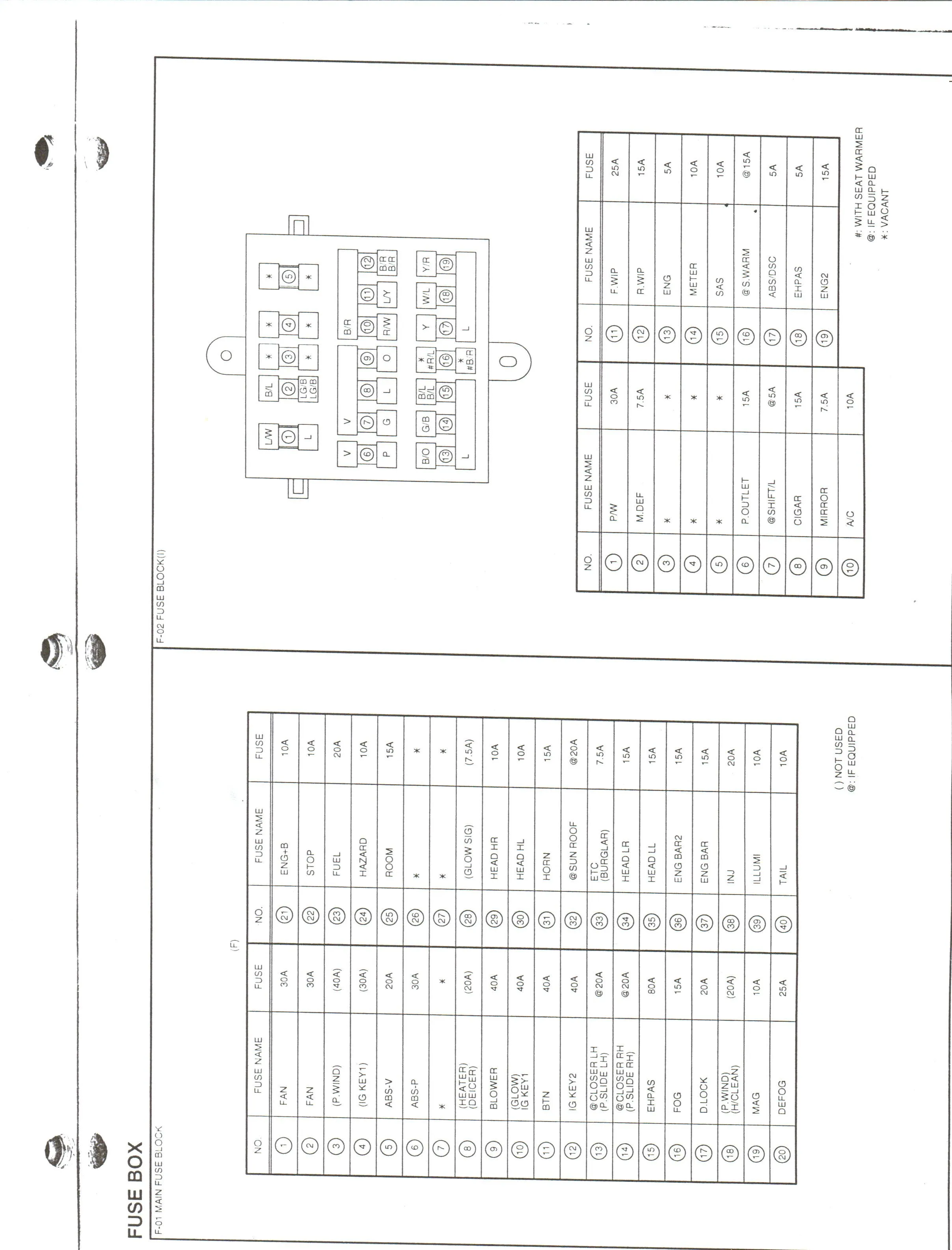

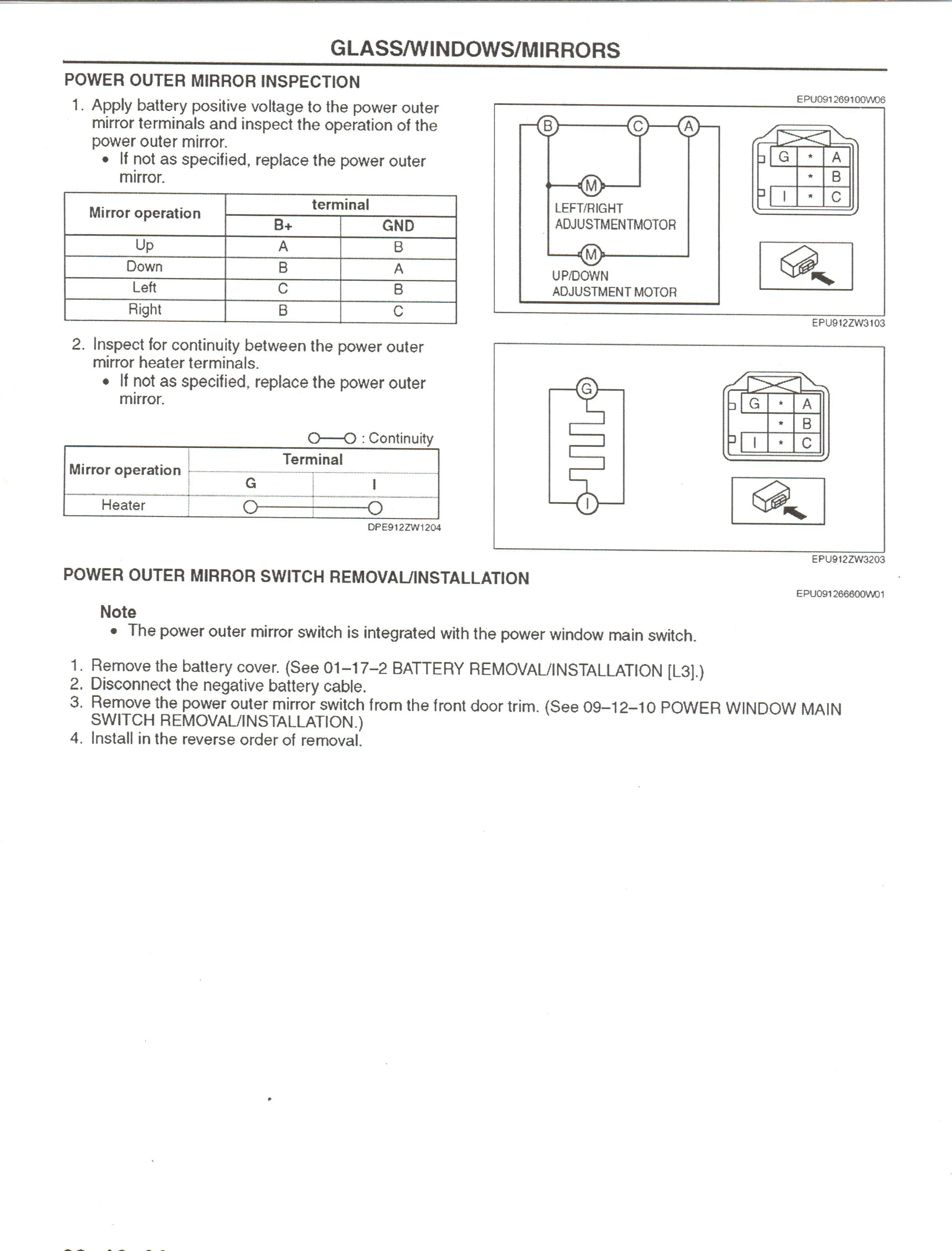

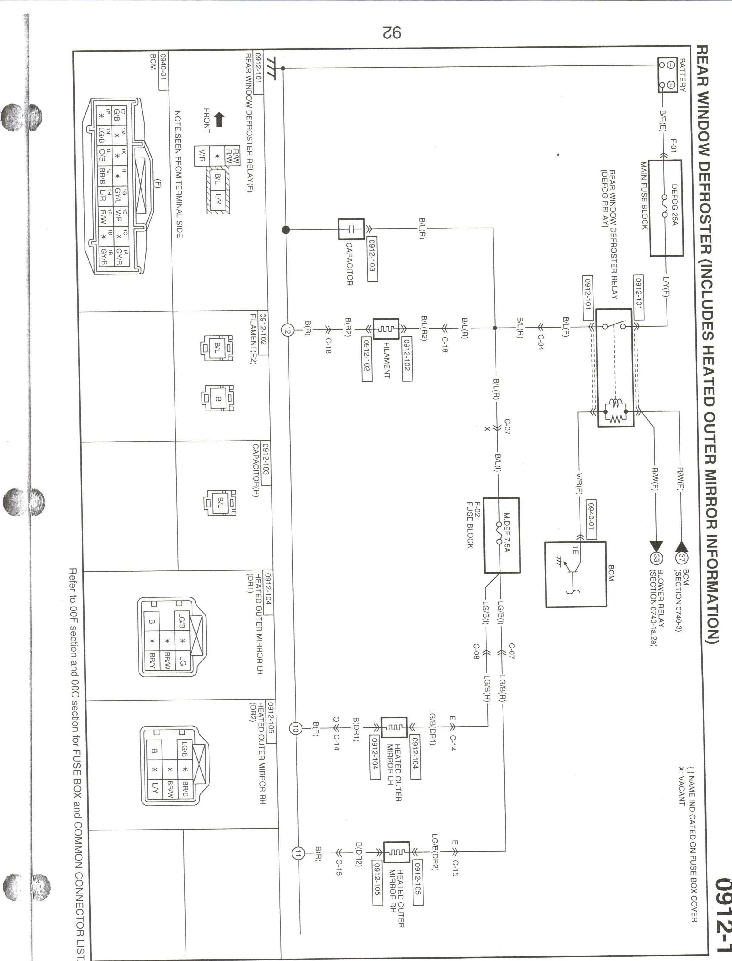

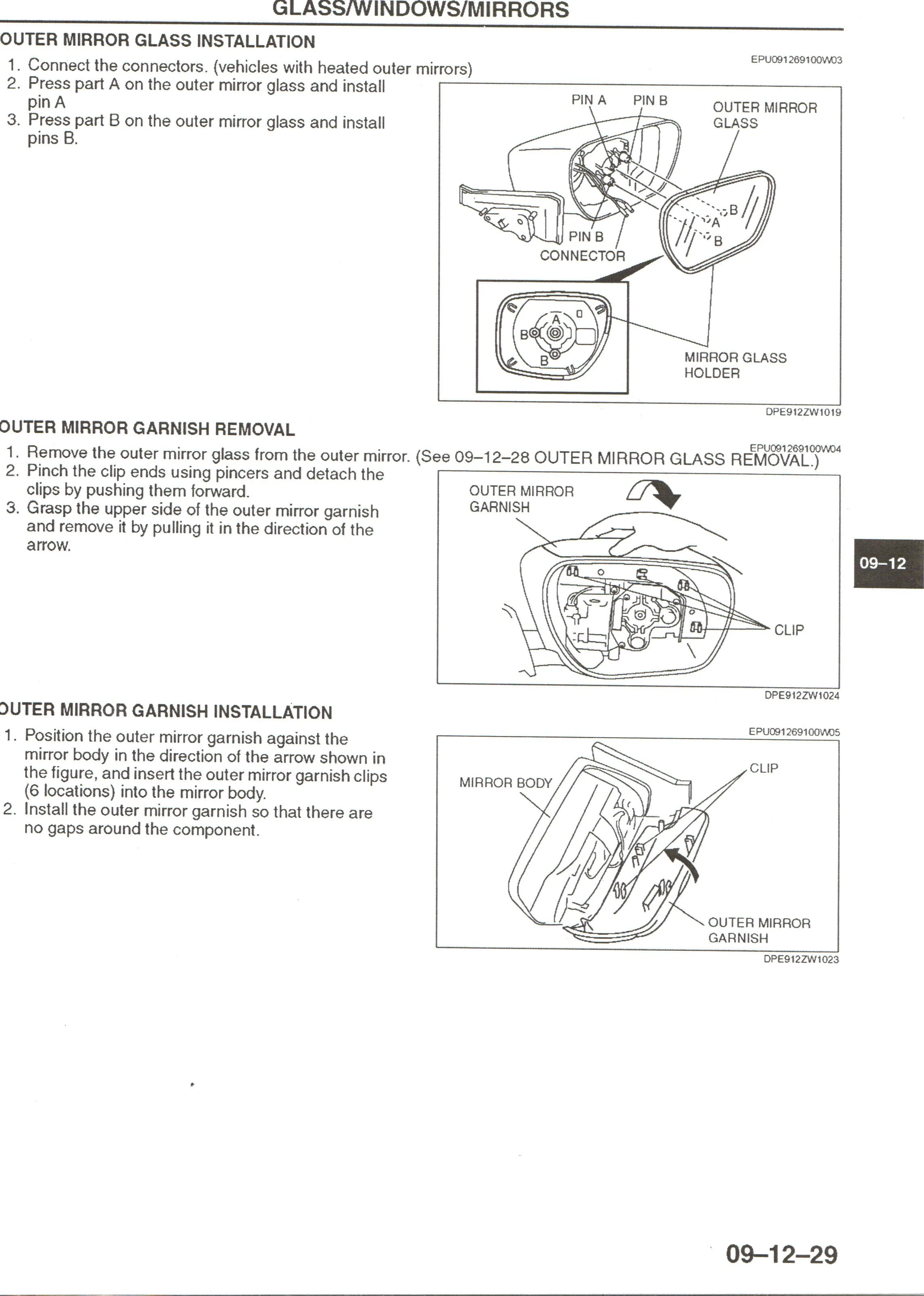

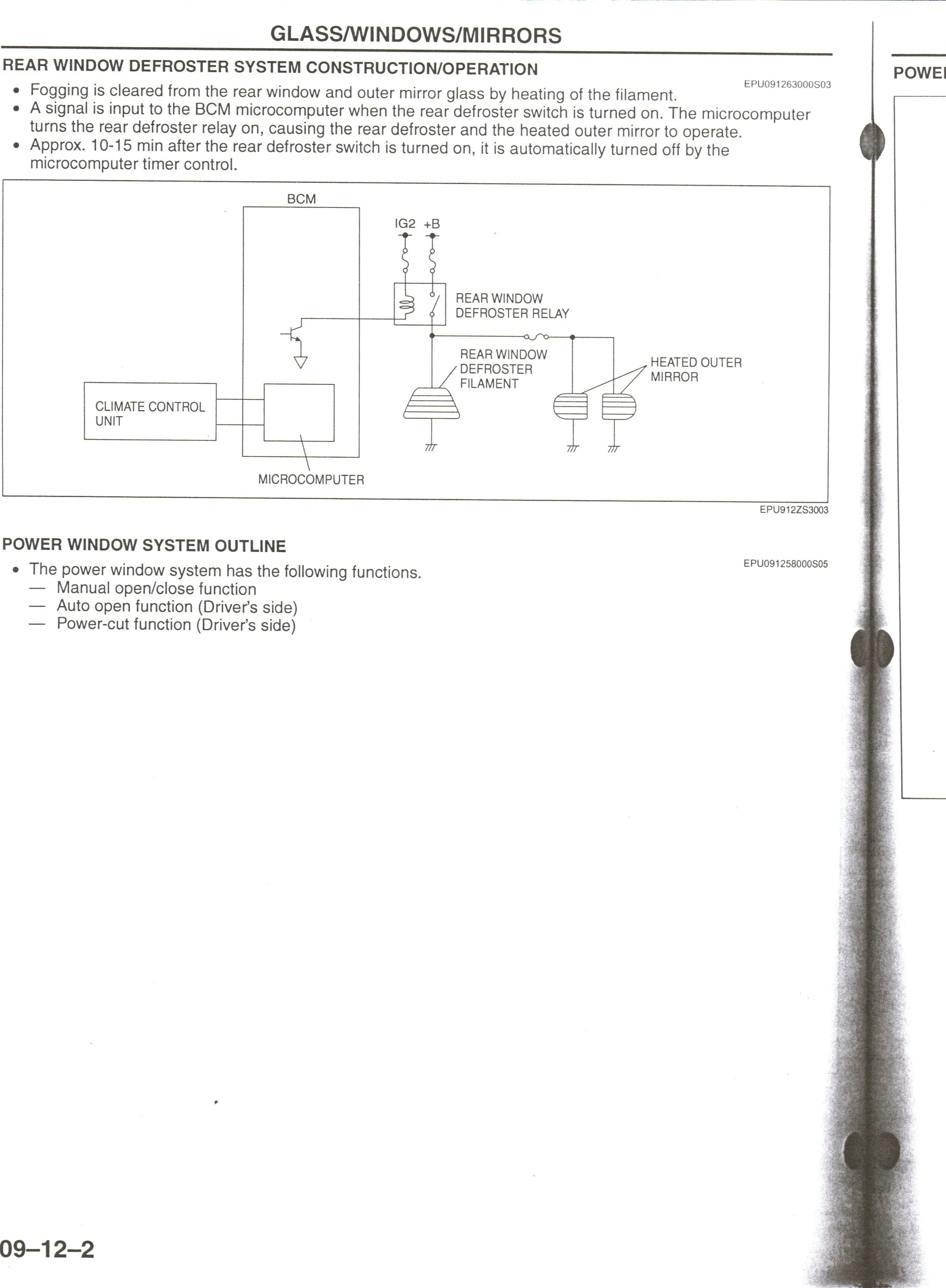

Got the wiring diagram with pin out of the mirror connector....
The system (rear defrost/heated mirror wiring diagram) requires an added fuse of 7.5A (if it not there already) and secondly the mirror glass with element. I have not givin up finding the correct connector but may just still drill out the correct pins anyways.
I will post all wiring diagrams required for the job later tonight. I anticipate wiring it up next week...(or sooner)

The wire seems to be there but I will run a continuity from the fuse box to the wire at the mirror....I feel confident that it will be there which explains on one side of the mirror connector there are 5 wires but on other side of connector only 3 used
