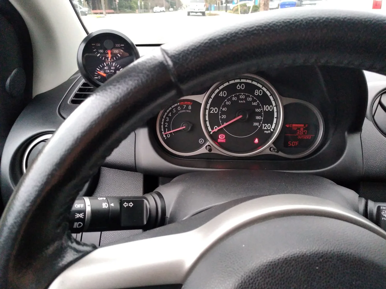

I installed an oil temp/pressure gauge from SpeedHut. Analog. My 2011 Mazda2 is only equipped with an oil pressure switch, which alerts to very low pressure, so I installed a sandwich plate between the engine and oil filter to allow install of temp and pressure sensors. I then had to route the cables through the firewall and up to the dash. After considering several locations, I opted to mount the gauge on the side of the cluster hood.
The gauge is very nice. I was able to pick backlighting that matched the cluster. I think they will do custom fonts if you want the numbers to match your stock display exactly, but I was able to pick something that was close enough.
