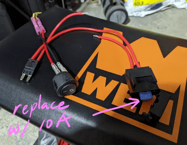

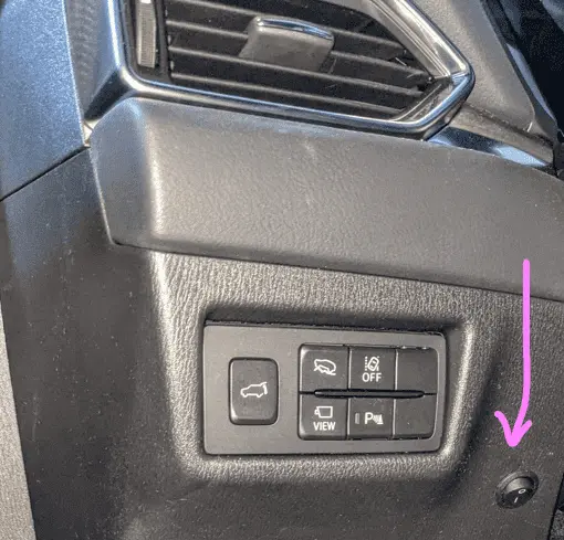

I actually wanted the trunk outlet power on demand, not on ignition.
Therefore, I installed a switch instead.

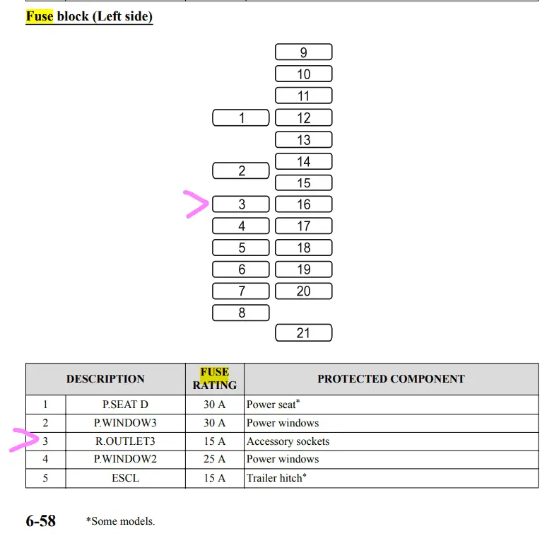

1. Use a fuse extender and plug into R.OUTLET3 (Fuse #3 15A); I used 10A fuse instead of factory 15A because the switch is rated for 15A and I wanted to be safe and keep current under limit.
2. Cut one wire (of two wires) of the fuse extender. You will bridge a switch here. Don't connect it yet because you will need to install the switch into the panel first and the fuse extender is too big to pass through the hole.

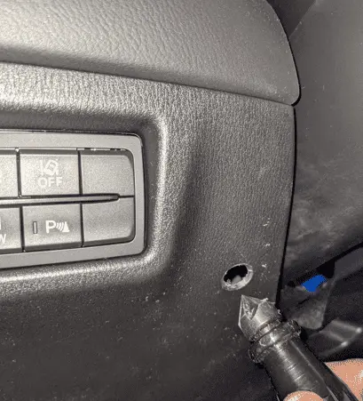

3. Find a spot deep enough to accommodate switch and wire connectors. Drill a small starter hole into the driver side under panel. Be careful when drilling ABS. Drill bit bites and tugs if you don't use a variable speed drill and go real slow. Better yet, use a hand drill.
4. Progressively increase drill bit size. Once I hit 1/2" drill bit, I started to use a hand countersink reamer until it went through.

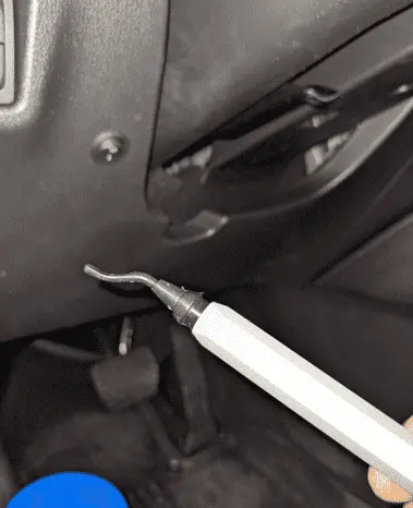

5. Use plumber's deburring tool to smooth out edges of hole and increase hole size. Careful not to make it too big. Keep check if the end of switch will pass through.

8. Before you push the switch through, connect wires to the switch long enough to reach fuse extender plugged into the kick panel fuse box.
9. Push the switch through and admire the near factory look.
10. Route wires to kick panel and bridge the cut wire of the fuse extender.
Now, you can use the switch to turn the trunk power On or Off.
