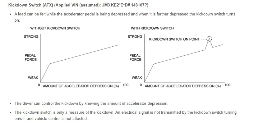

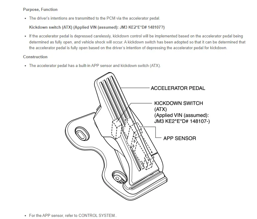

So I guess don’t click that switch if you want to conserve fuel and prevent "vehicle shock". Sounds kinda screwy to me, but now I think I understand. I did find this old video from Mazda…
