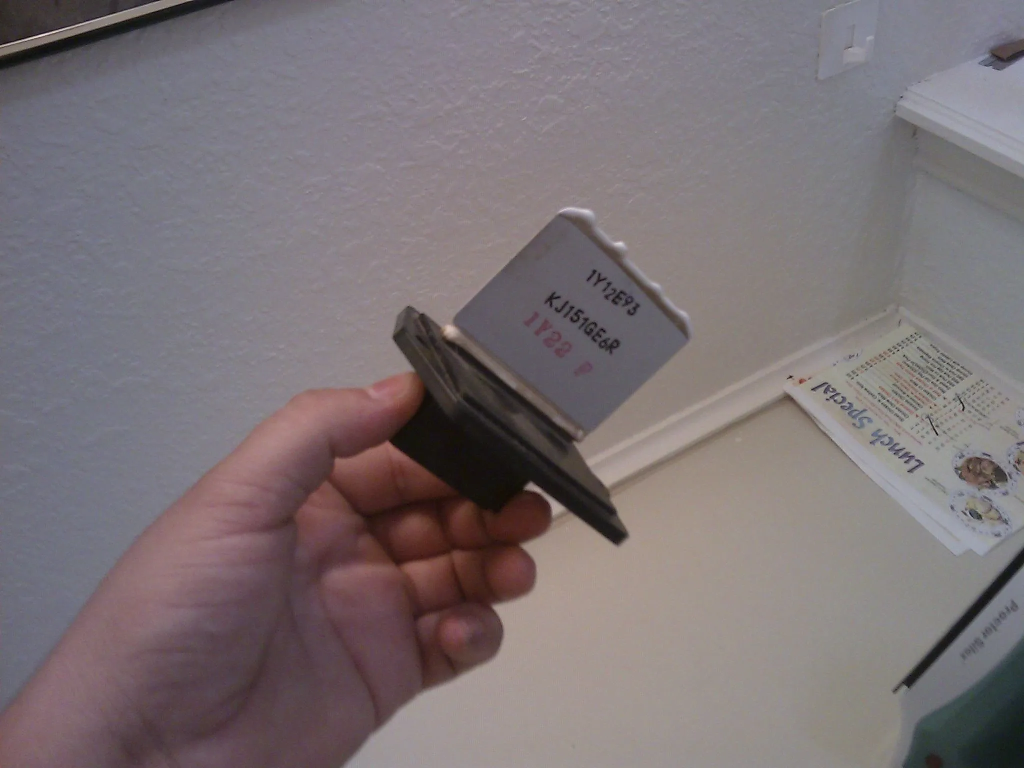

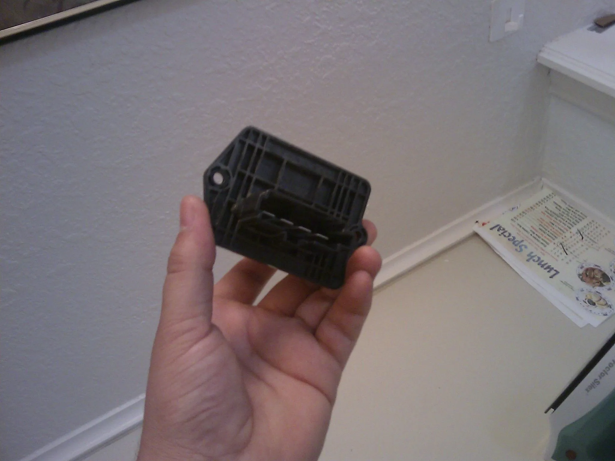

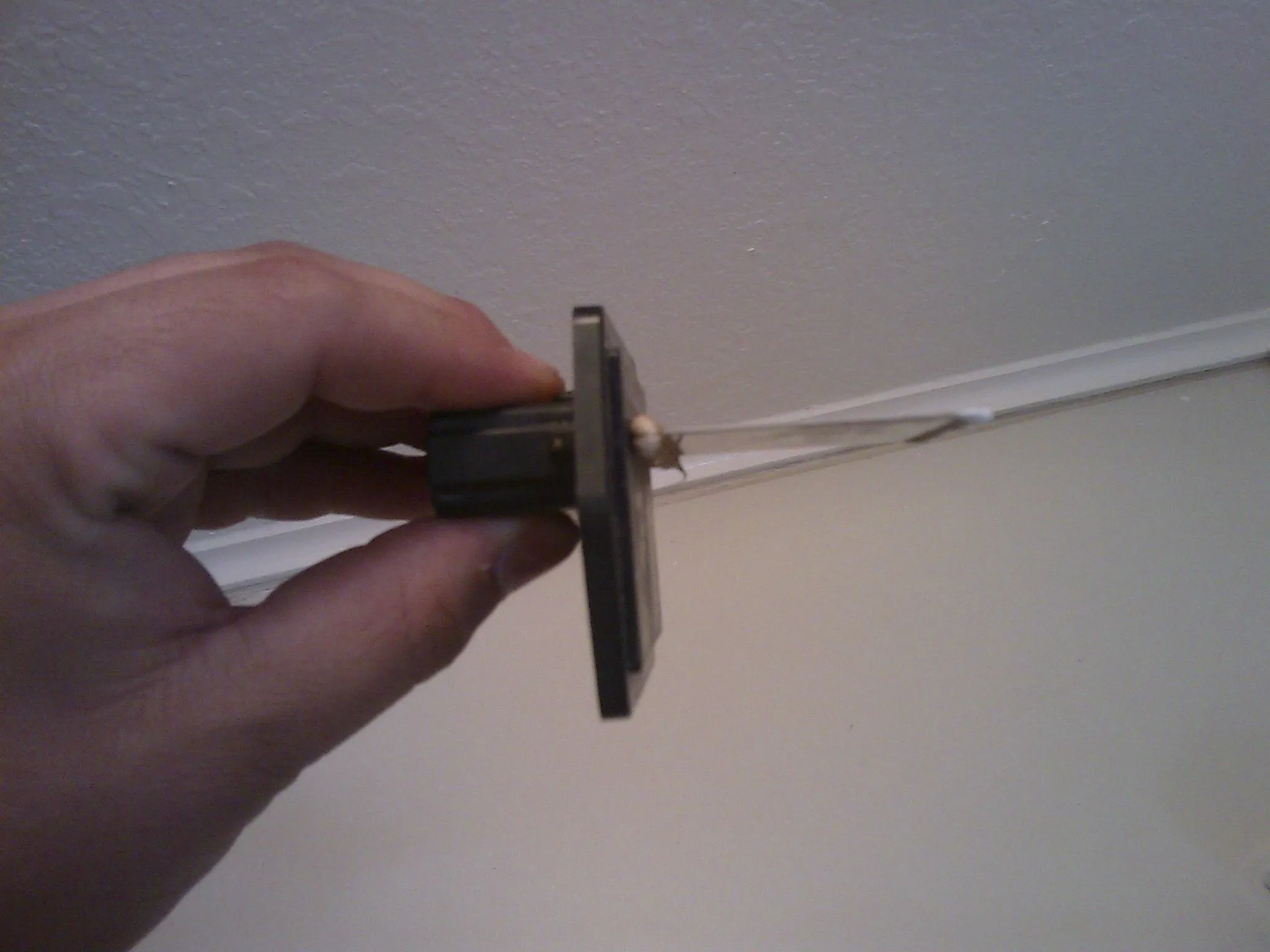

i had the same problem not to long ago and found the solution, first checked all the lines, fuses, relays and none of those were it. So i pulled out the blower and it was stuck so i turned it and i heard a crack it was dirt that made it stuck so i hosed it down with hot water and let dry, also changed out the moduale and that fixed my issue. i had gotten these moduals from the junk yard try several and got one that worked on all 4 speeds. i will post the pic of the modual i was referring to. hope this helps, any trouble just hit me with a PM
