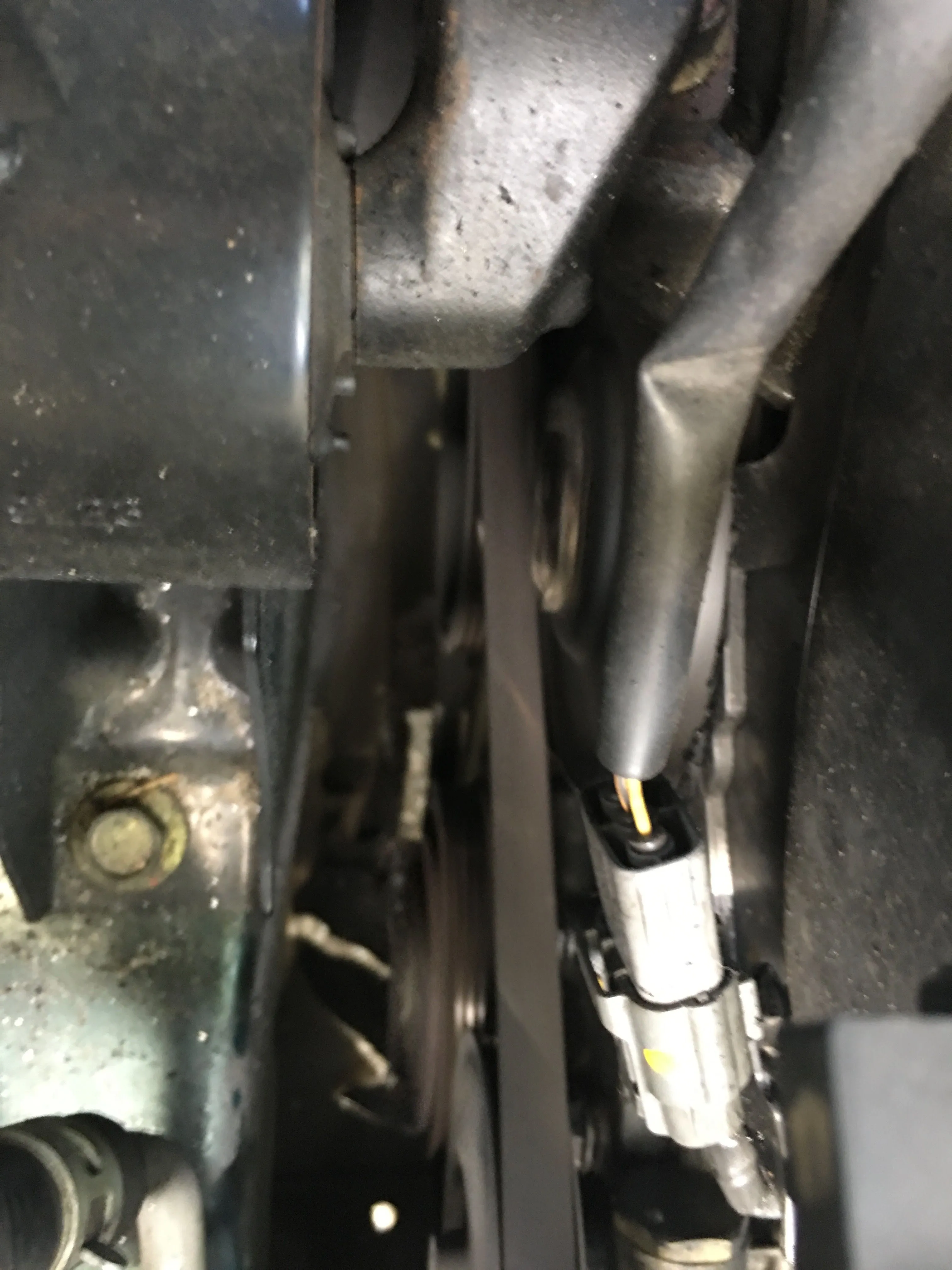

OK so I had a noise every time I engaged the AC switch on in my car. A rattle. It would last 5 or 6 seconds and was intermittent. I drove the car like that for 6 months.
Now the AC does not come on and when I look inside car the AC Clutch was slipping & not engaging but now it does not turn spin at all.
The car is old. 2000 Mazda Protege' DX 1.6. The repair shop wants $1400. to replace compressor. They also just don't replace just the clutch even if the AC compressor itself is still working.
They also told me the car was not safe to drive because metal filings from compressor could fly out and snap the belt that is shared with other components such as power steering.
I pulled both AC fuses as to not turn AC on accidentaly. Question: How dangerous is it to drive without the possibility of the AC coming on, since I pulled both AC fuses?
And please explain. Thanks in advance. I'm not a car guy or 6 months ago I probably could have just repaired the clutch myself as I have seen people do on YouTube.;-)

I'm almost positive you can just unplug (or cut) the wire powering the AC clutch and then it will never be able to engage.
When it's not engaged it just idles on a bearing.
The pulled fuses should do the trick but cutting the wire makes sure.

Wow. Some great info here. That's why I love this Forum. Have not been on in years and in hours I get accurate information. I think I will just cut the wire for now.

Take a ruler or staight edge and try to line it up across the two pulleys to check for interference.
You could just remove the compressor or the pulley on it.
The engine was probably designed to provide clearance.

You can't see in the photo but the 3 big nodules that stick out from the clutch plate cover are pretty much chewed up.
I can get a better photo so you can see.

Even if your belt shreads, you're not gonna die.
It happens all the time.
You might lose power steering (which can be shocking but you can still steer) and maybe your alternator (you'll just run off the battery... I don't what all's connected to that belt) but you may end up stranded somewhere.
I'm 98% sure you should be fine unless your clutch is still grabbing even with it disconnected.
Take a look and a listen.
If you hear and see no movement you're sure to be fine.
