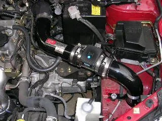

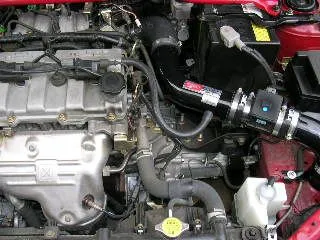

Well,fortunately for me,we got a break from the rain today which meant the install of the intake.So here it is:
how is the coolant bottle attached now? Care to upload a few bigger pictures for me please? thanks in advance.
The coolant bottle has been relocated to rest on top of the radiator(since the stock air intake is gone) and stays on by bolts and a metal plate.I would post bigger pics, but it would take up the entire window.
Yeah,I guess they don't come in the blue and the red anymore.It's only black and the polished.
The sticker on the piping looks different. I have a blue one. It has red letters, but the sticker is positioned so that if you're standing in front of the car looking into the motor, "Ingen" is written upside down. I thought it was odd and wanted to see other pics to compare, but your sticker is different :(
