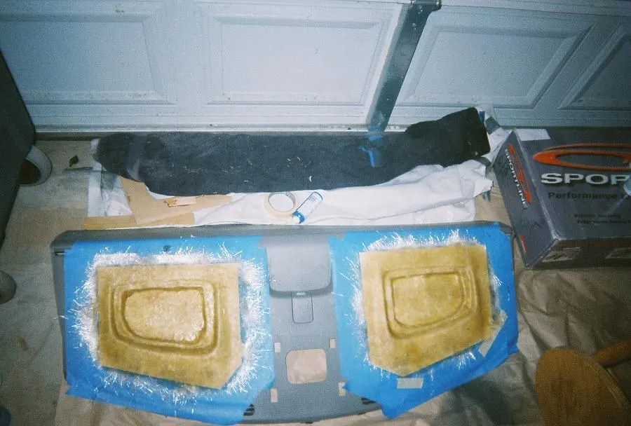

Don't have a lot of pictures on this yet. I'm still fiberglassing some stuff for my rear deck and amp rack. I'll go into detail later with proper pics and add them here.

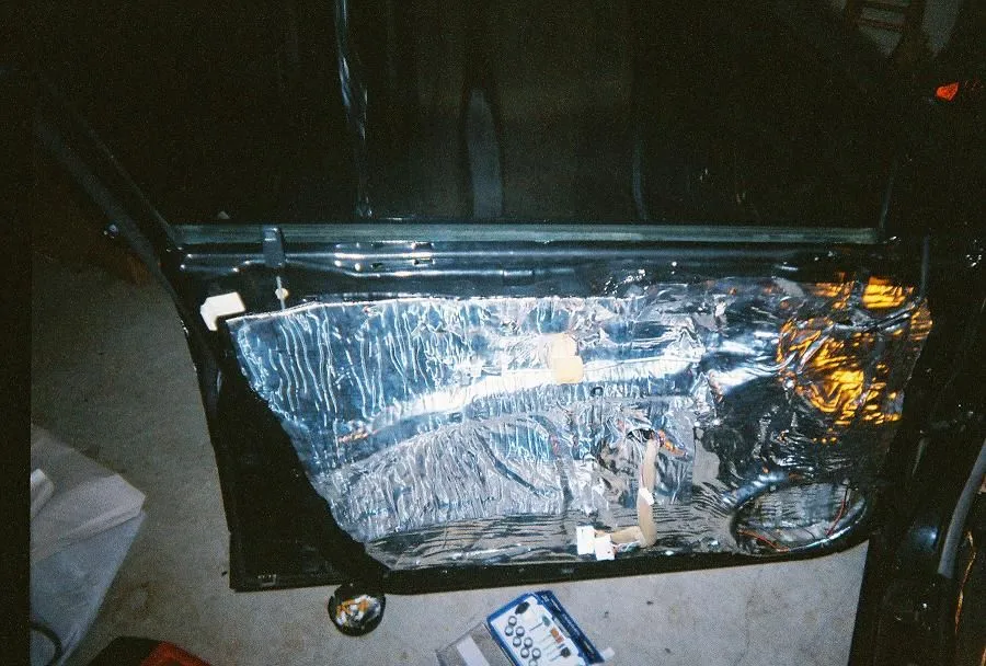

I do have a picture of my door after putting deadener in. Rick at Raammat audio has a good thing going on there. He was very helpful and his sight and presentation are very straight forward. This is what I got, this is what people think, let me know if you want some. His product is priced reasonable for the quality compared to others in the sound deadener showdown. Anyway putting this stuff in is a b**** cause you got to get to the bare metal of your car which means taking every last interior snapping clipping screwing tugging pice out of the car.
It's a b**** and I kept telling myself, "This s*** wouldn't sell if people did all the crap to put it in and then didn't notice anything." I have to say it's made a pretty big difference so far and I imagine when I get all my panneling back in the car is going to be pretty audio friendly.
pics are my door before. I flipped all my electrical connections to the inside of the door by just reversing the clips. this gives the mat more to grab onto, and if you ever need to get to those wires you can reach into your speaker hole and get them witout taking all the mat off. It's basically like Tar, lots and lots of tar.

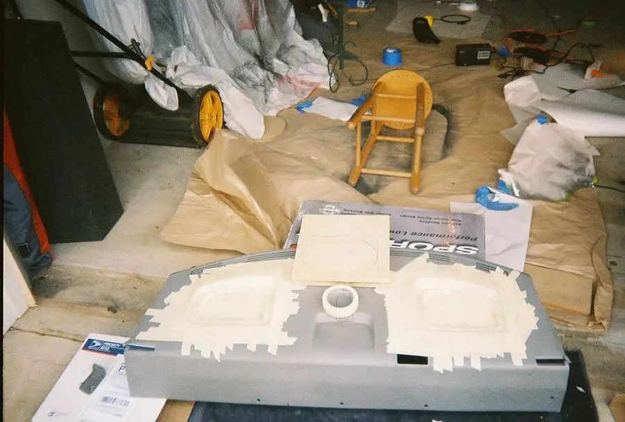

Some fiberglassing pics (first run at that too) I am raising my 6x9's up about 4 inches so I can mount my amplifiers in the roof of the trunk. that way I don't have to drill holes in my seats and I think it will look good (I mean let's be honest) And yes audio gods I have thought about the airflow up there and I think you will like my solution for that.

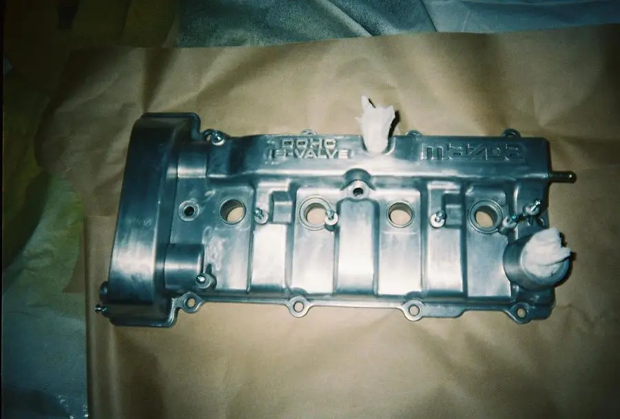

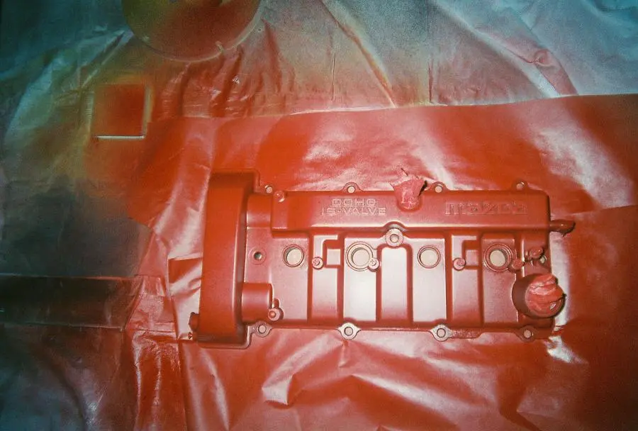

I gotta hit the hay but here are some random pics of the paint. Anything in faded grey is my old stuff. Anything with black and yellow and silver is the new scheme. Picked those colors cause the replacement seats I got had all three.

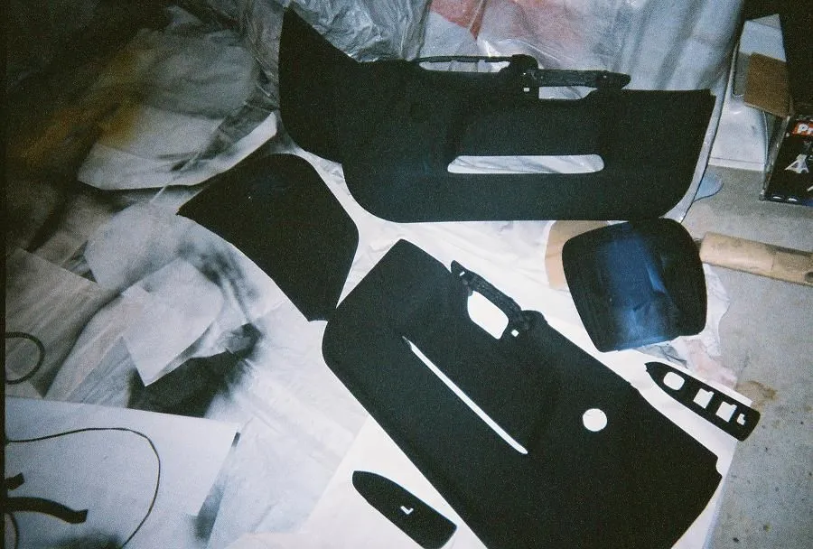

doors all all rattle can. I found that dupli fabric worked on the 'fabric' but you gotta get down in there good. Almost soak the fabric but not till things get out of hand. Then after each coat you need to rub the material till the fibers losen up then do it all again.

The key to the fabric is to think about what it is you are trying to do. You aren't painting a piece of plywood, you are tring to color an assload of little fibers. So one coat will get whatever threads are showing, the thicker your coat the deeper it will dye. Then after you let it dry completely (overnight at least) rough up all the fabric good. I basically did it till I could rub my hand down it and no color came off. This also changes the directions of the fibers and exposes areas that may have been missed. I'm pretty happy with the results, we'll see what happens after I put some abuse on them.
justanotheradikt said:
yea thats true...so did you soad it? or just a bunch of light coats?
I did light coats the when I started. Basically put it on like they tell you to paint a pice of plastic. Took about 5 coats to start looking dark and every time I rubbed the fabric down about half of the paint would come off. So I got pissed and painted the s*** out of one piece, it worked.
After trial and error this is the rule of thumb I found that works best.
1. Get close, 2 or three inches away. Think about what it would take to spray paint a letter L on a white T shirt. Mist would take 10 coats, but a solid line would show up. So, use a sweeping motion like painting other parts but you should be able to see the line that you are painting.
2. right at the point where you can see the color going on is the right amount. Back and forth, overlap each line till they blend.
3. Wait a good 30 min and then do the rub down (as if you were trying to mess up somebody's hair). Do about 3 solid coats and then wait overnight.
4. Do one good rub down, try to take the color off (not with your nails or anything) and then give it another coat, 30 min, rubdown and it should be good to go. The color will fade a bit after it dries so you want to put it on a little darker then what you expect to see.
Me and O-Town got back at it tonight. We managed to get a little further on the fiberglass enclosures and dabbled a bit in some Borsch relays. Took a bit to figure out a ground relay start vs a positive remote. I had one of each. My dome light ground and my deck remote. Got both going and neons are now installed.
I have 1 door pannel in. exactly 1 tweeter working and that is my entire stereo system right now. Hopefully can get the rest in before the meet tomorrow.
here are some pics of the current state of things.

speaker position before creating a fiberglass home
3rd Pic
Fiberglass 1st layer and supports
4th picture
