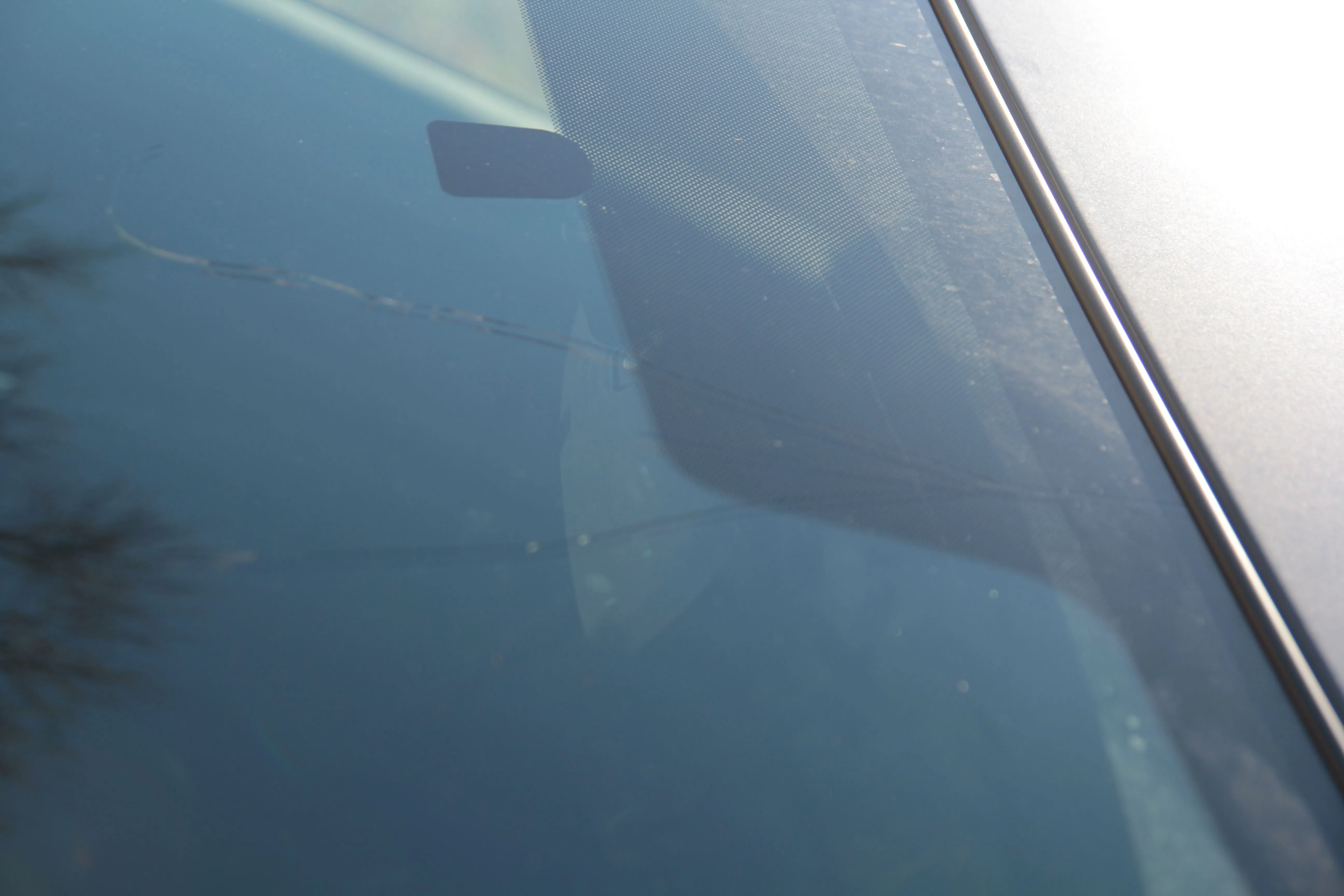

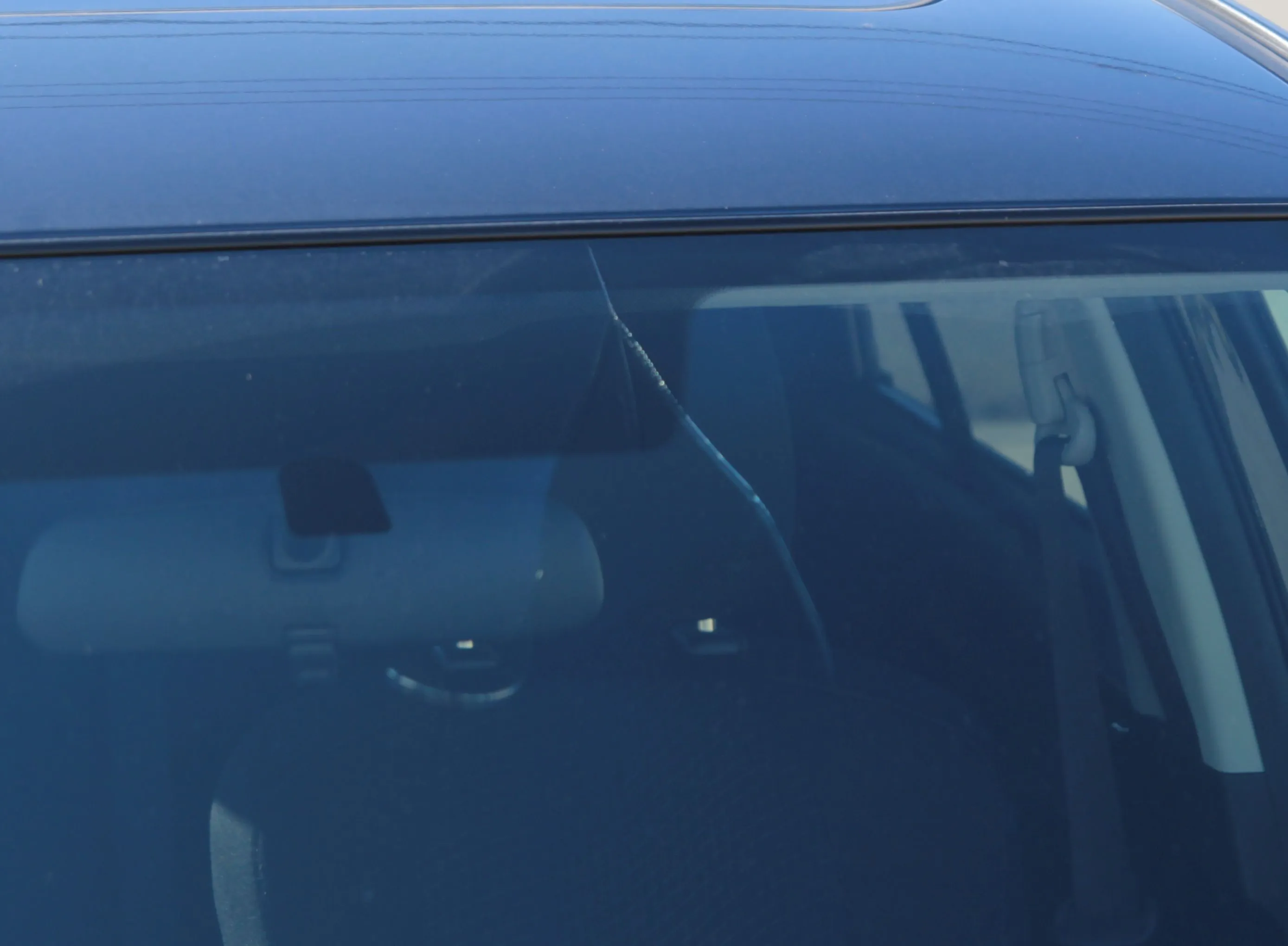

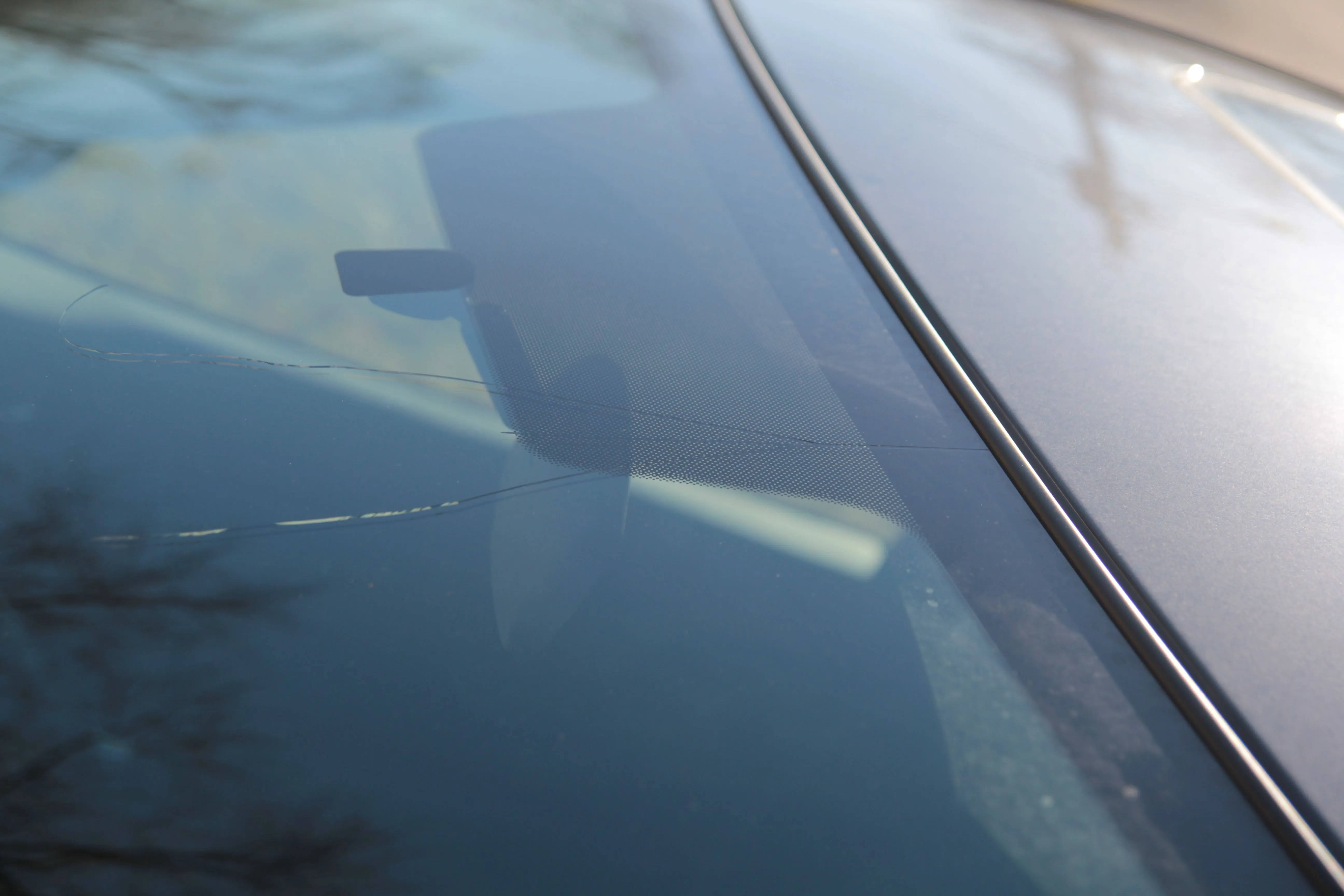

I took delivery on 2/26 and today as I'm leaving my office I noticed a huge crack in my windshield. The funny part was I did not notice it on my commute in or when I stepped out for lunch.
There does not appear to be any kind of impact. There's no indent from a rock or other piece of debris. It just looks like it started at the edge of the glass and continued out from there.
I'm calling the dealership now, but I can imagine how hard they are going to fight me on this one. Think I have a shot?

I took a better pic. And I can't really see any impact. It looks like it started at the edge and spread.

Dude that is definitely a stress crack of some sort, insist on it being a defect. Notice how it starts at the top edge and goes down and spreads, not the other way around. It'd be impossible for it to start in the middle (from say, a chip from a flying rock), all spread out as it is, to then run upward into one single line fracture to the top edge. They better fix this for you at no cost and no questions asked. Best of luck, you have a case though.

This is a nice shot. Note how wide the gap is. This windshield must be under tremendous stress for the two sides to be this far apart. There is no way this was caused by a stone and the dealer should not fight you but bring it to Mazda. There are too many of this type of cracks happening for it to be random isolated cases.

Edit: Update! Well for a second they tried to put the pen in the crack and say "Ohhh here's your point of impact". Then I asked them to run the pen down the entire top part of the crack and ohh boy it fell into the entire thing. It was at that point that they said we'll take care of you, but please mark us favorably on the survey. Should have the new windshield in early next week.
