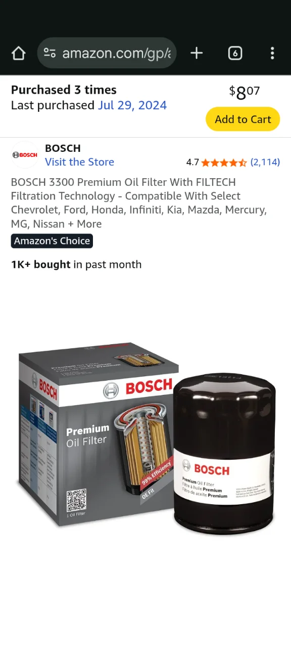

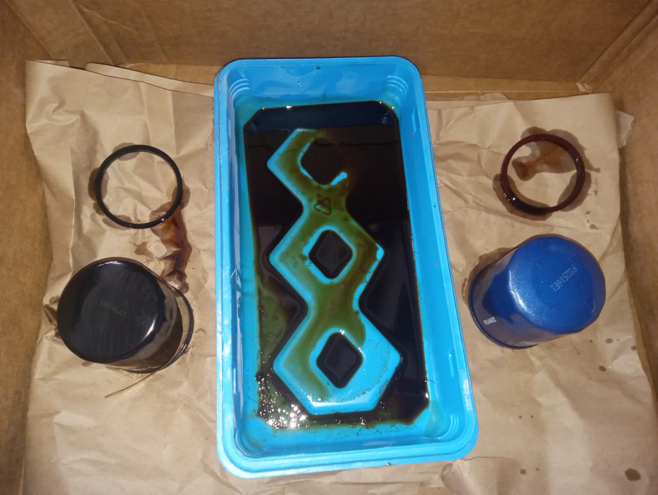

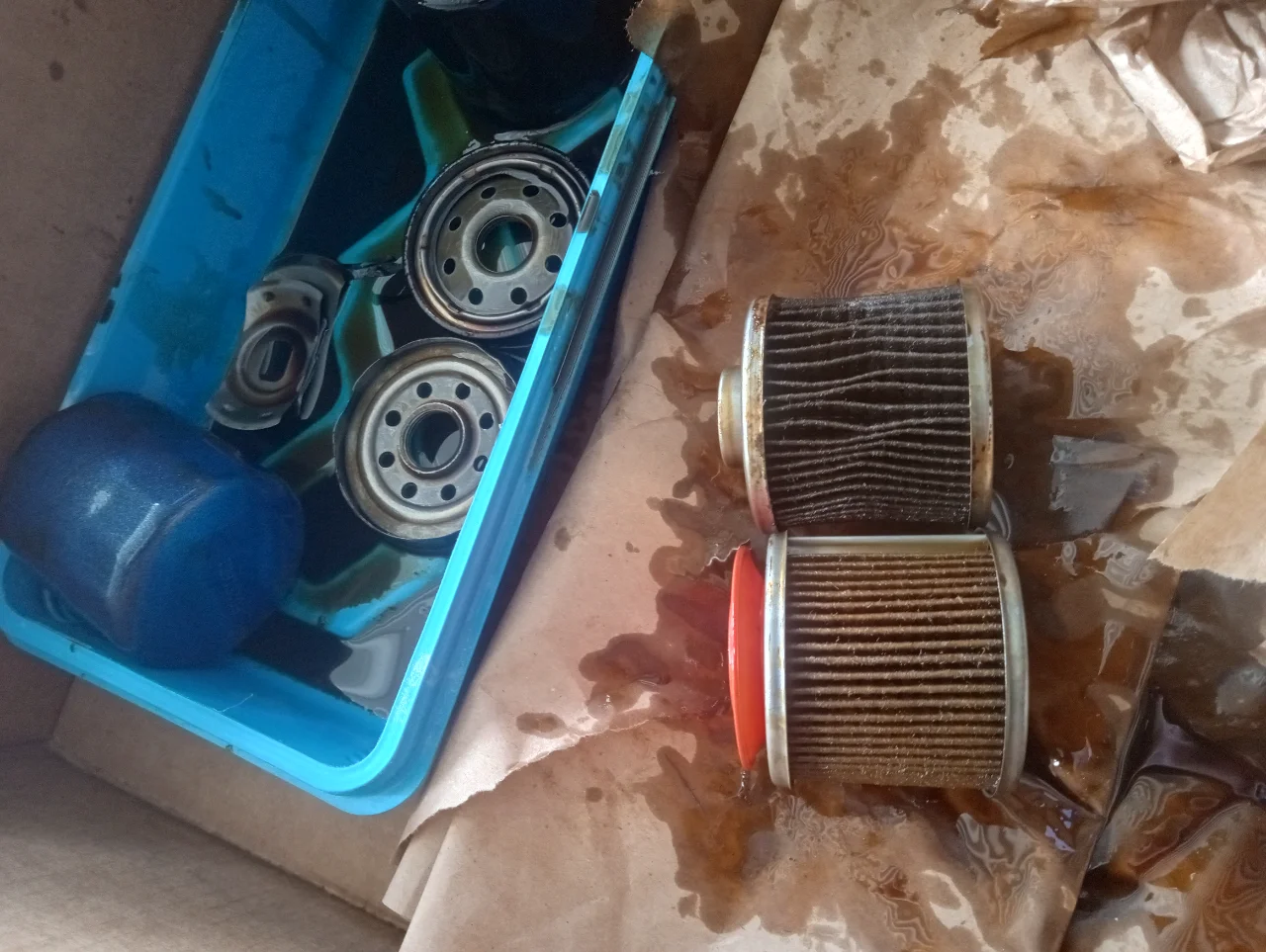

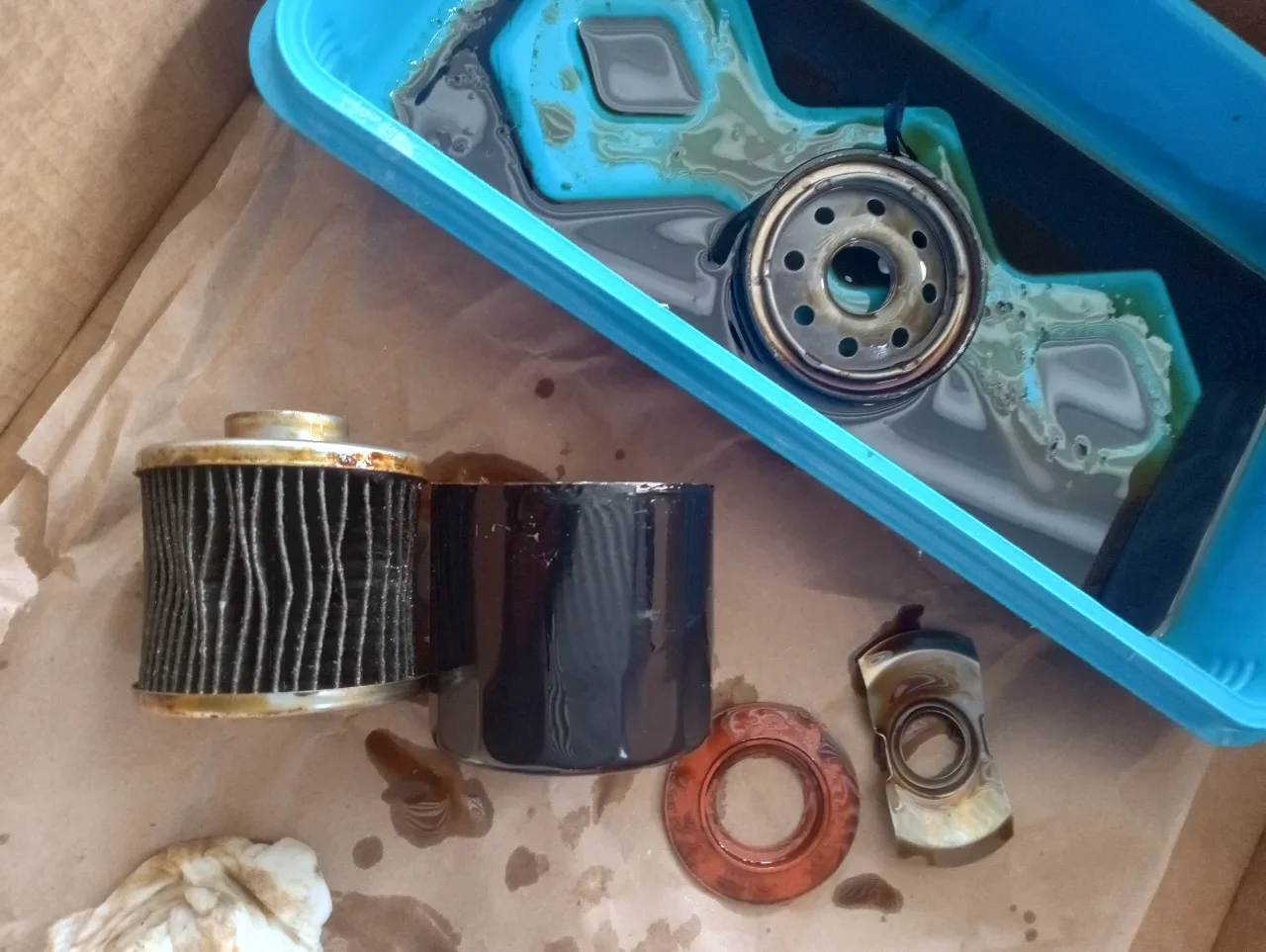

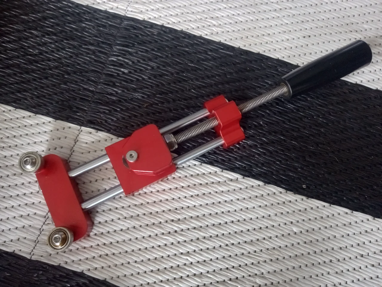

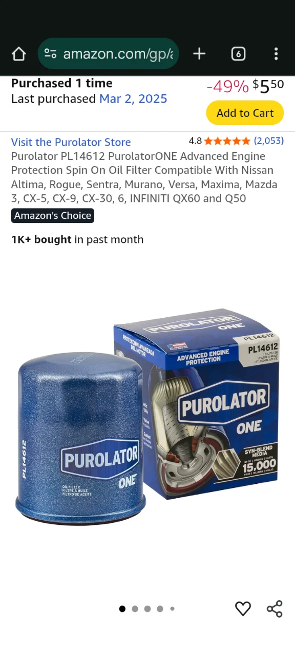

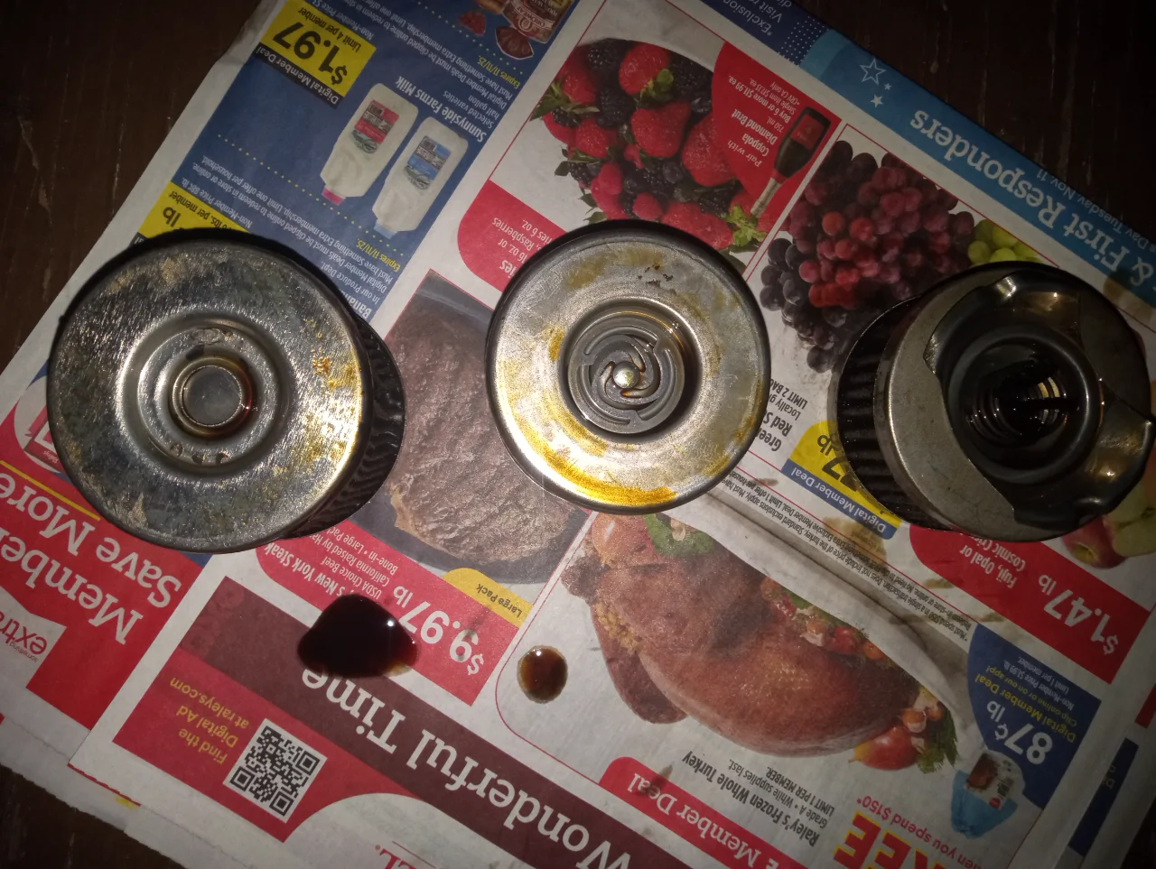

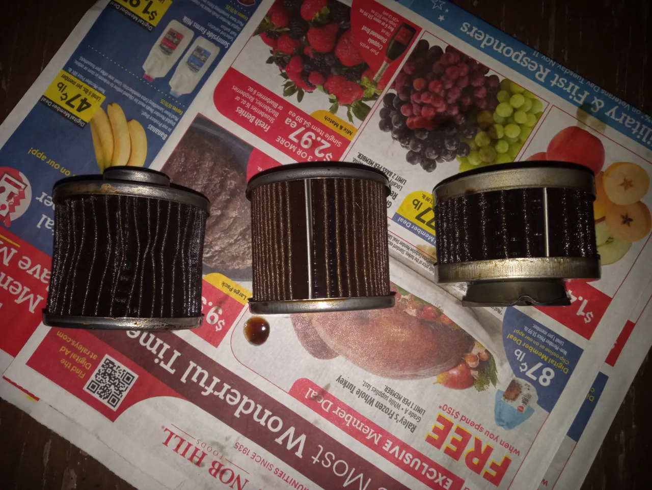

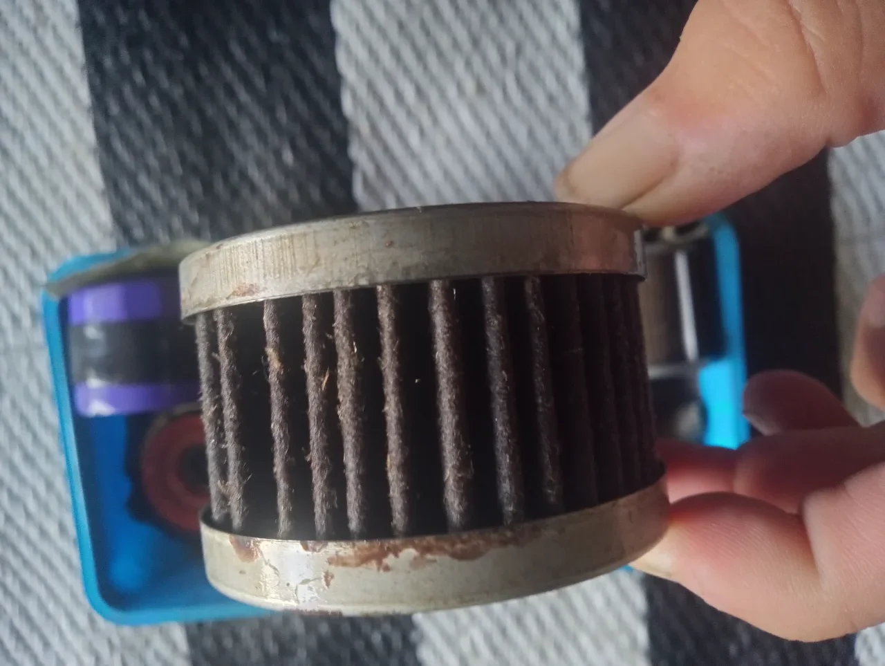

This is my new hobby. The $20 tool works very much like an electric can opener. The hardest part is holding the unit steady. The black one is Bosch 3300, the blue one is Purolator, both in service for 8K miles.
Bosch was easy to cut open, Purolator was five times as hard. The walls seem to be of the same thickness though. The media in Bosch was collapsing, whereas Purolator is still intact. Bosch has been sitting upside down in the tray since May. Purolator let out a lot more oil when cut open, after sitting upside down for two weeks.
Bosch was filtering regular 0w20. Purolator was filtering Royal Purple. I am surprised that the media didn't turn purple. Can you imagine if I put these pics on my dating profile haha ha. Wish I had kept a Mazda filter to cut open for comparison.
Not knowing anything about the filtering capabilities, I can only say that Purolator has a more solid construction than Bosch. My next one is a Royal Purple, which should come off in December. I might have to cut it open to decide which one to use next. I felt the RP filter is smaller than either Bosch or Purolator. Does size matter here?

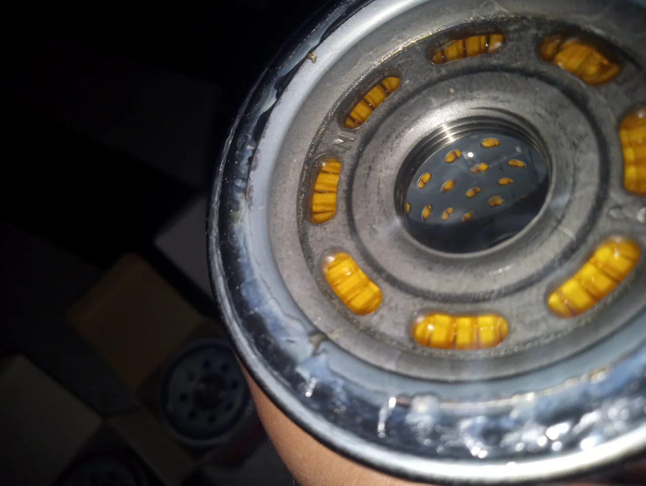

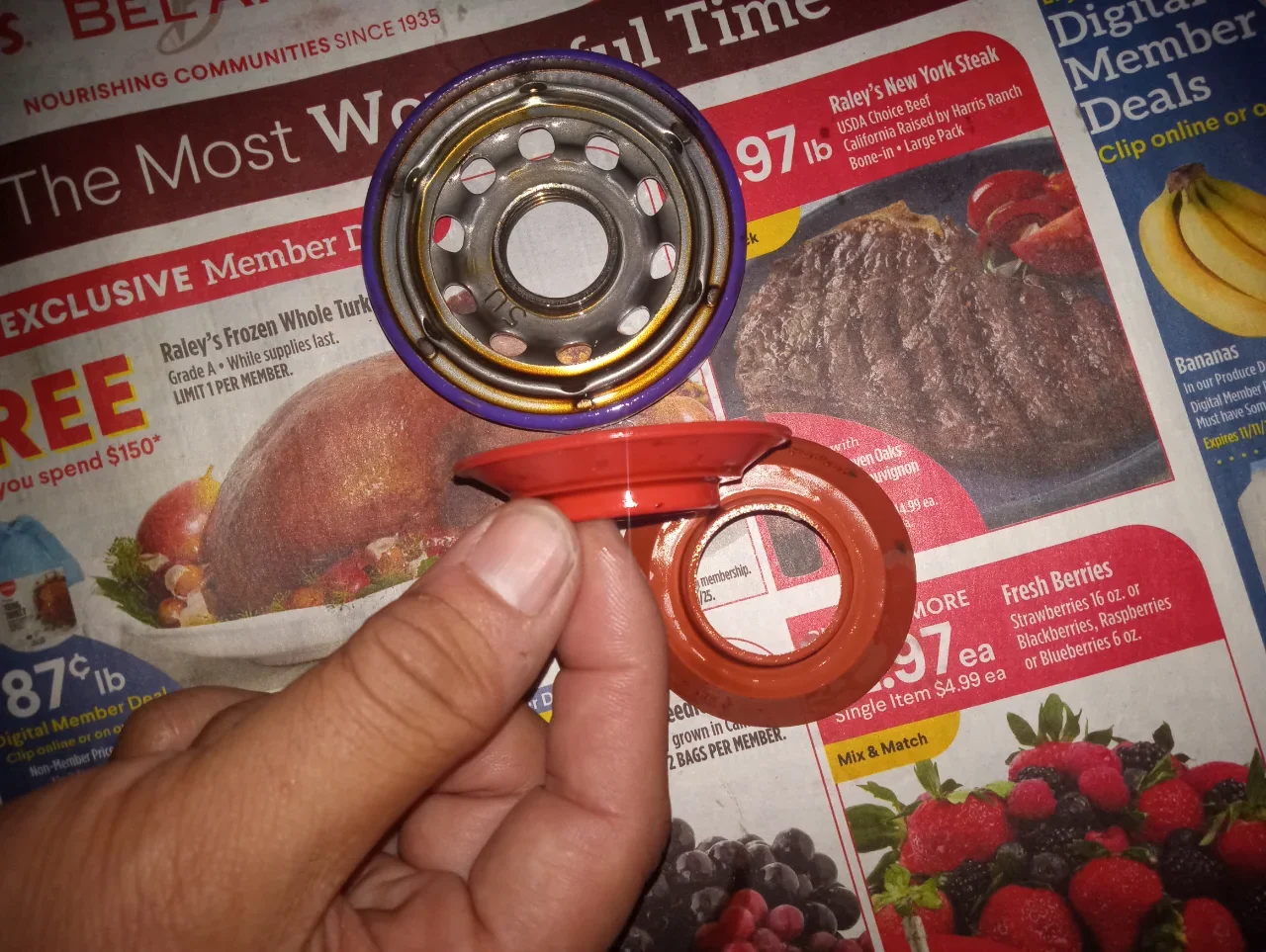

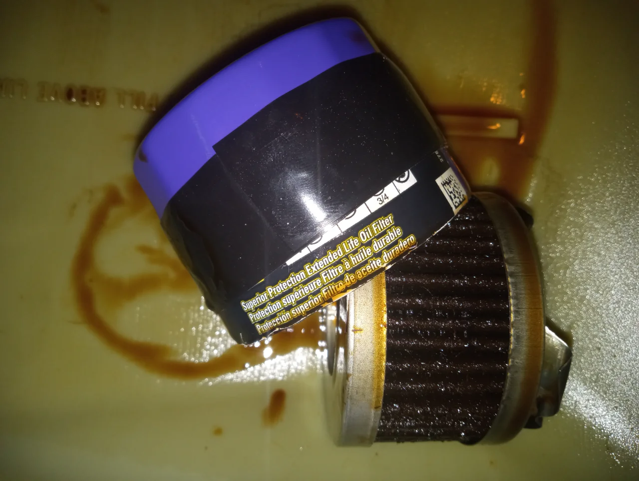

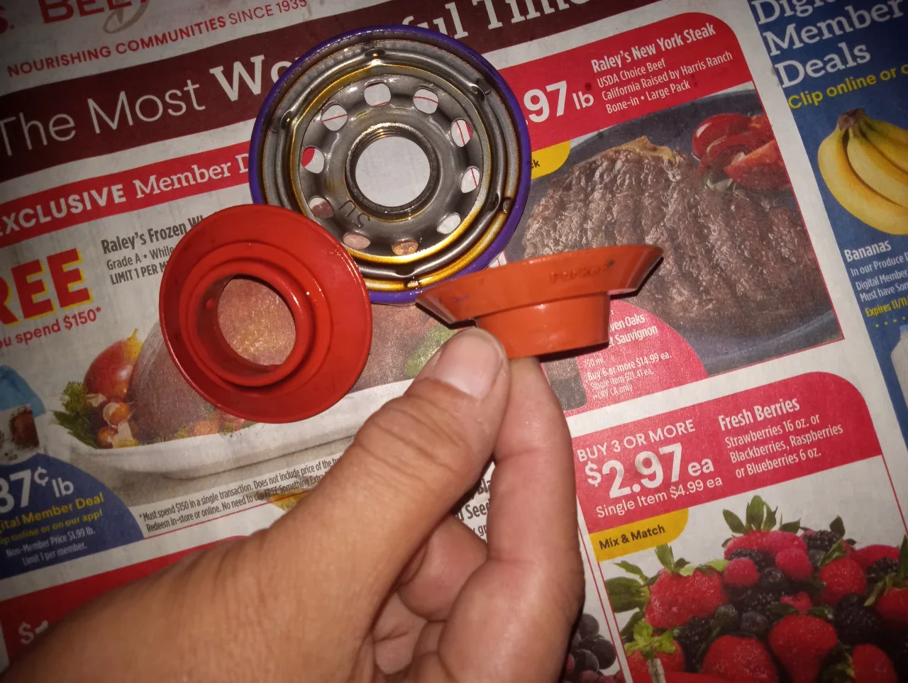

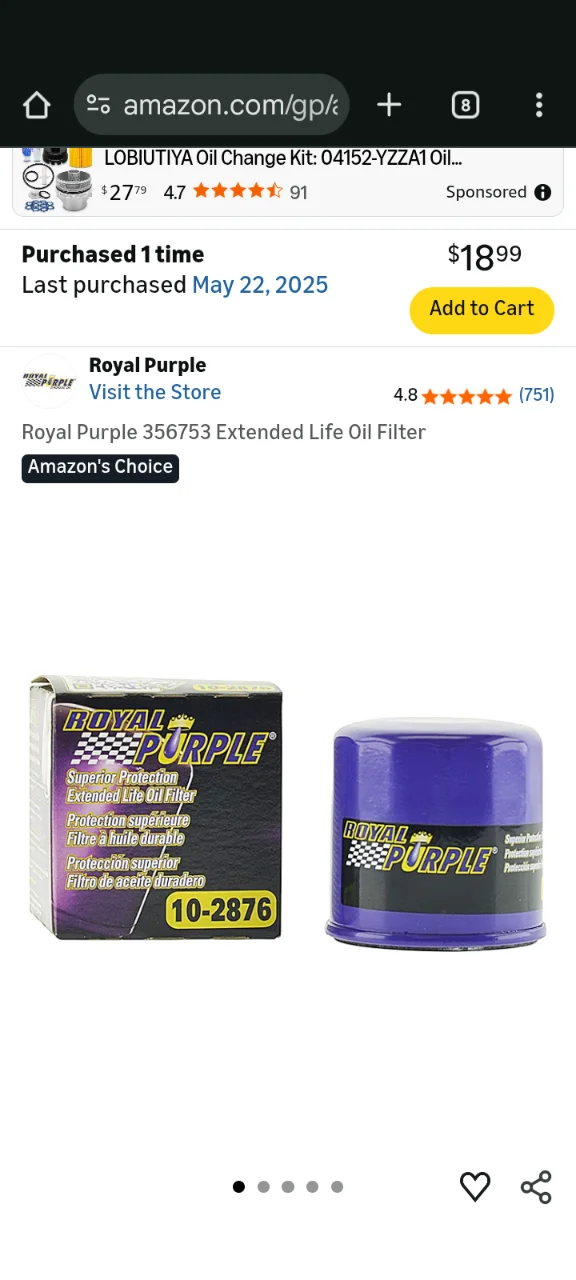

This is a $18 Royal Purple oil filter for my Skyactiv 2.0. Cooked and boiled for 6300 miles in Royal Purple 0w20. It is well built all right. The ADBV extends deeper into the center tube. The bypass valve at the bottom looks aggressive. I picked at the ADBV through the inlet holes with a tweezer and couldn't get much residual oil out.
The media looks rough though. It looks much worse than the previous two that I cut open. 😥 It claims to be extended life but that's not a lot of surface area.
Took another shot of the media element in daylight.

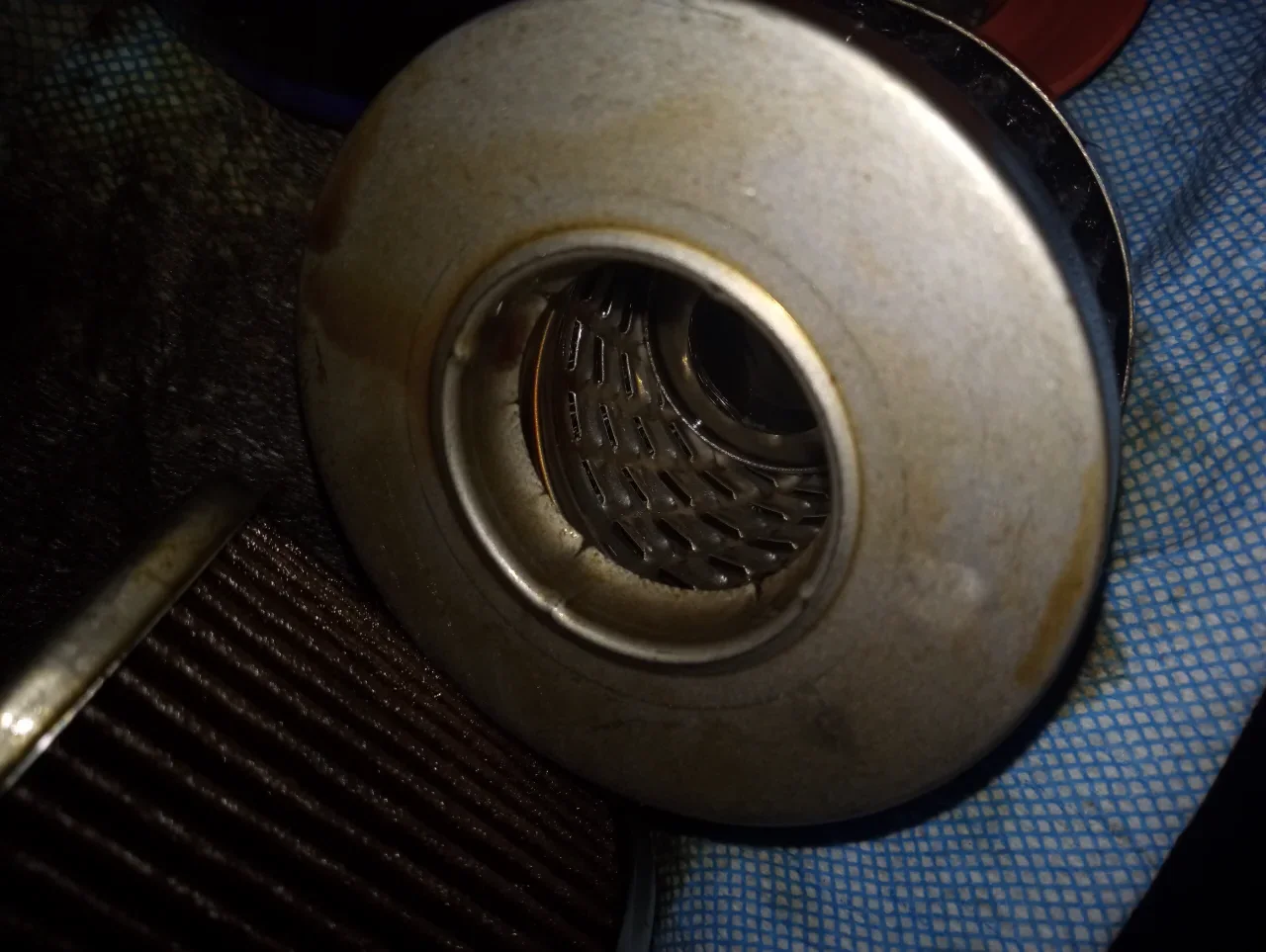

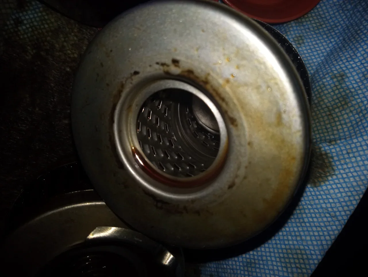

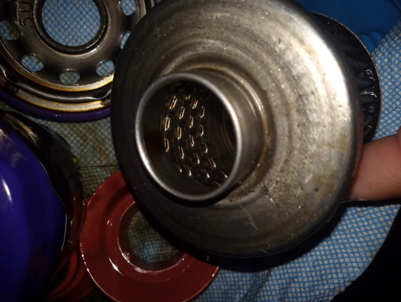

A shot of the interior of these filters. All three have the grater type of slits.
Edit: Looking more closely, I can see that both Purolator and RP have slits facing up and down. For Bosch, the slits all face up.

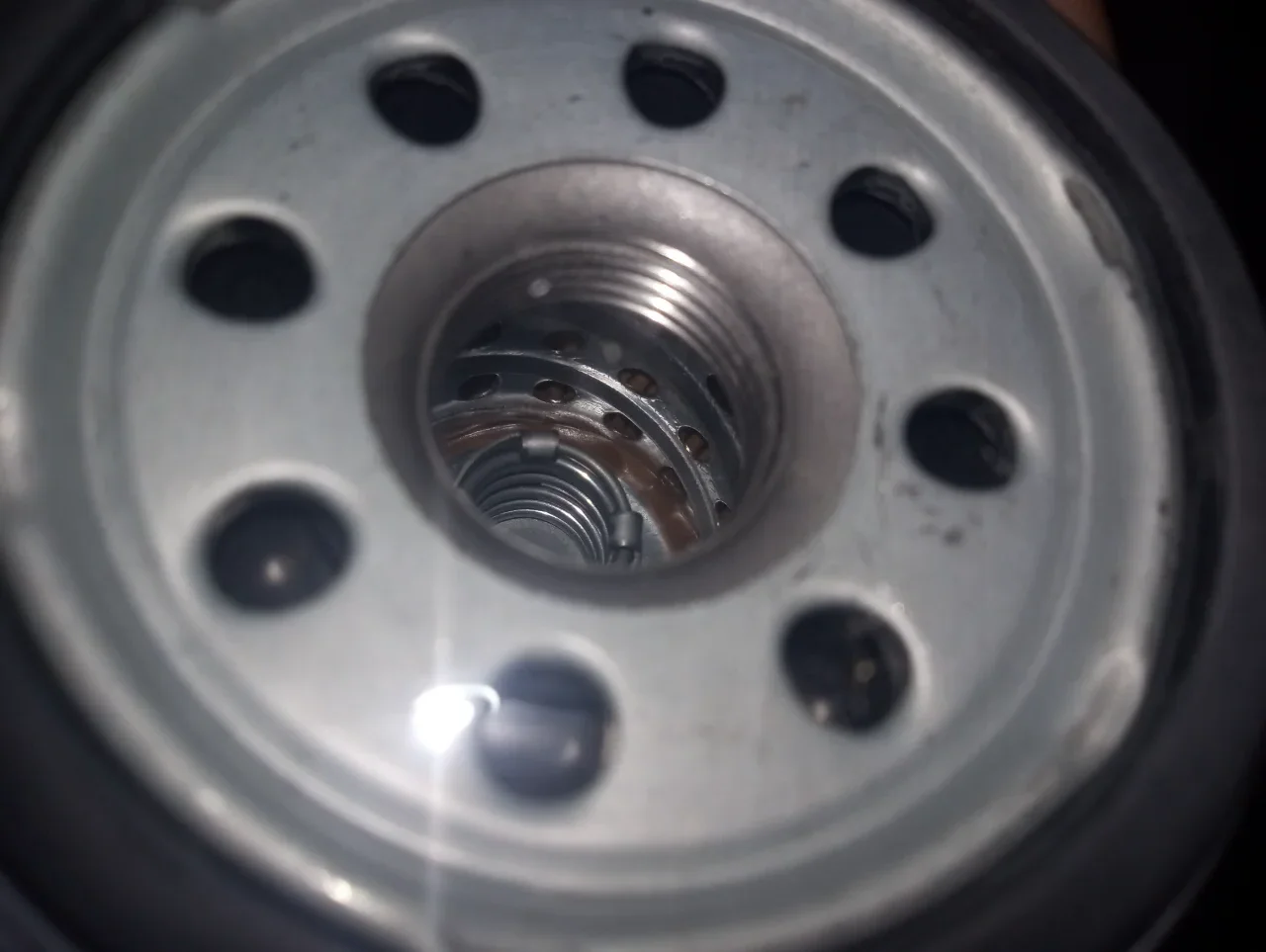

Besides one RP, I have two more new filters on my supplies shelf. This is a Premium Guard 4612EX. The holes are large inside. From what I can see, the filter media goes all the way to the bottom.

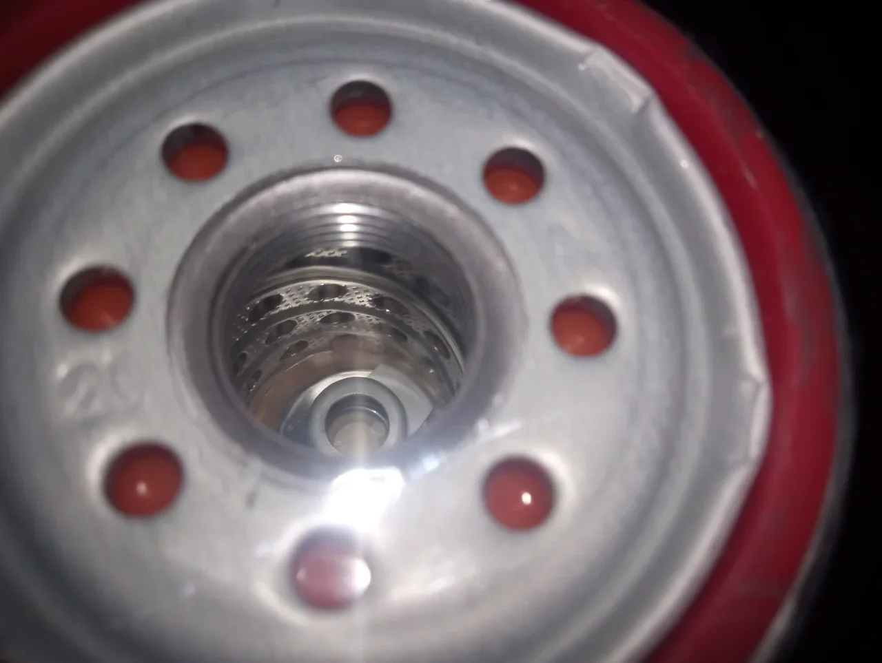

This is a Pentius Ultra Flow PLB6607, also with holes in the center tube, smaller though, than those on PG. It is also shorter. The PG has 5 rows of holes inside, this, only 4. The filter media also seems to go all the way to the bottom, but it is smaller than PG.
Hmm, does that spring stay put inside?
OEM has large inlet holes. The holes in the center tube are much smaller but densely spaced.

I wonder how the ADBV on these non-oem filters impact the flow. On the RP unit, the diaphram seems to be very close to the inlet holes. On the Pentius, the diaphram sits a bit deeper.

Edit 1/8/2026: After watching so many filter cut-open videos, I find myself prioritizing flow over filtering capabilities. And the top candidate is Supertech, its nylon cage offers better flow than metal tubes with holes or louvers. The 13 inlet holes also sit slightly above the diaphragm. (This matters because on the RP filter, the adbv is very close to the inlet holes, and when I try to push the adbv down with a cotton swab, it didn't move at all. I don't think much oil can make it through. Among all the filters, the RP one might go to Pete unused.)
