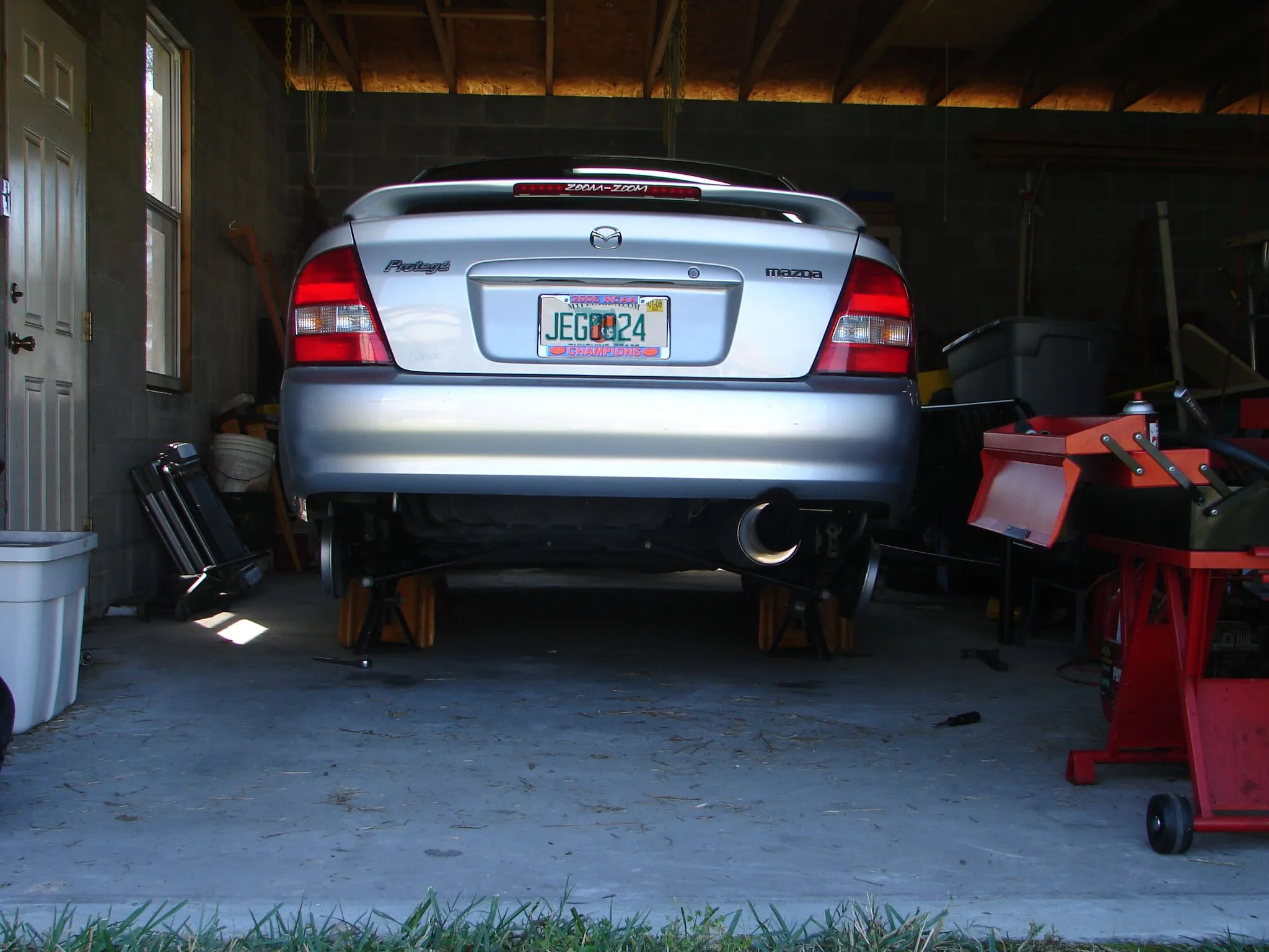

In regards to jacking up the back of the car, I have another picture to share depicting the area where the rear suspension components are secured to the inner sub frame of the car:
Is this the location that people have been using the jack the rear of the car up? I assume the jack should be placed behind the flimsy looking hollow box piece that sticks down?
In closing, I was hoping to shed some light on an often asked question and wanted to invite other users to share their experience on this subject. Does anyone have any other methods they use as they pertain to floor jacks and jack stands? I am trying to avoid speculation and it would also be nice if certain methods were not dismissed as wrong without some evidence to back it up if possible. Heck, I might even find out that I have been doing this wrong the whole time myself!
