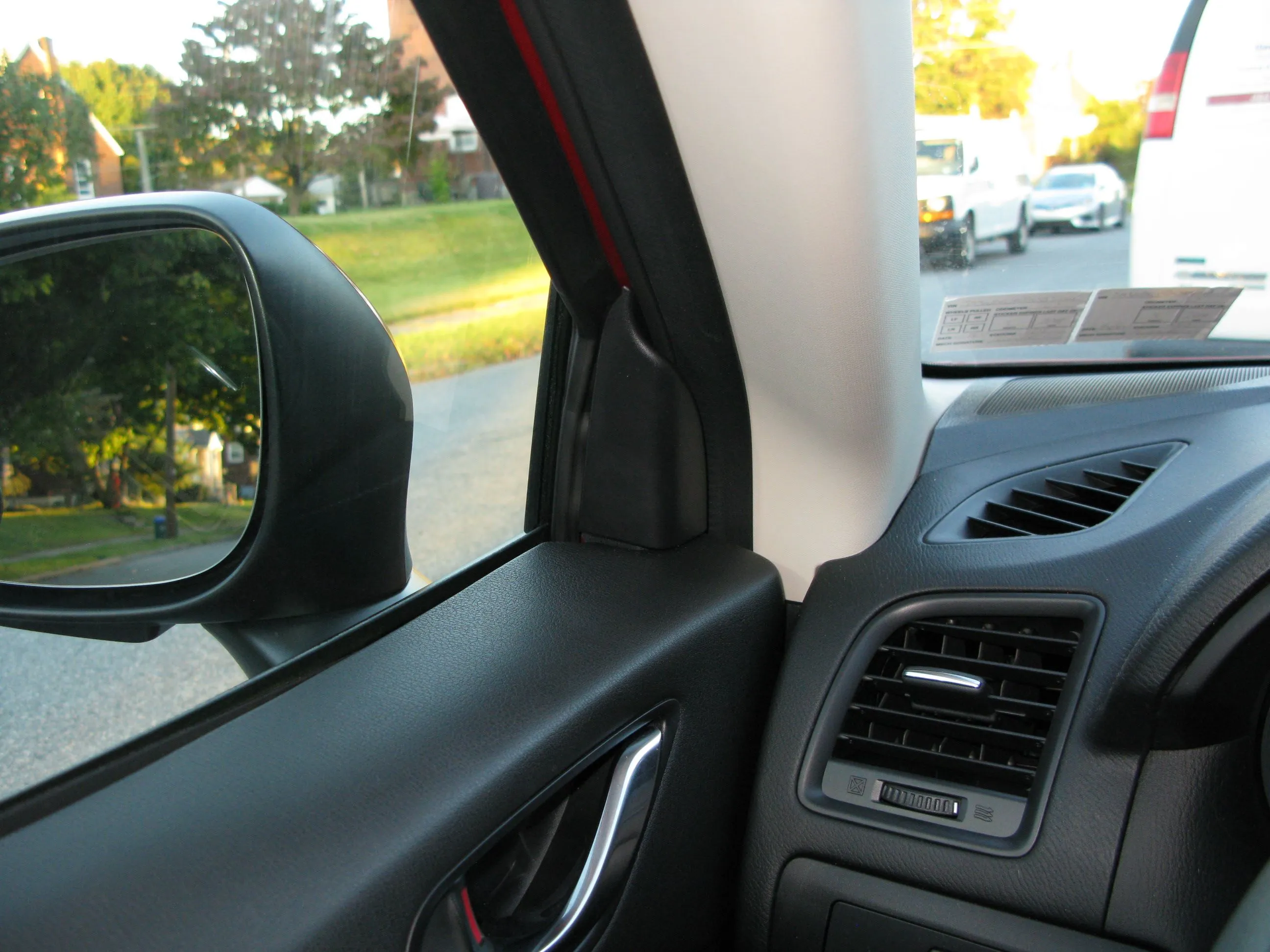

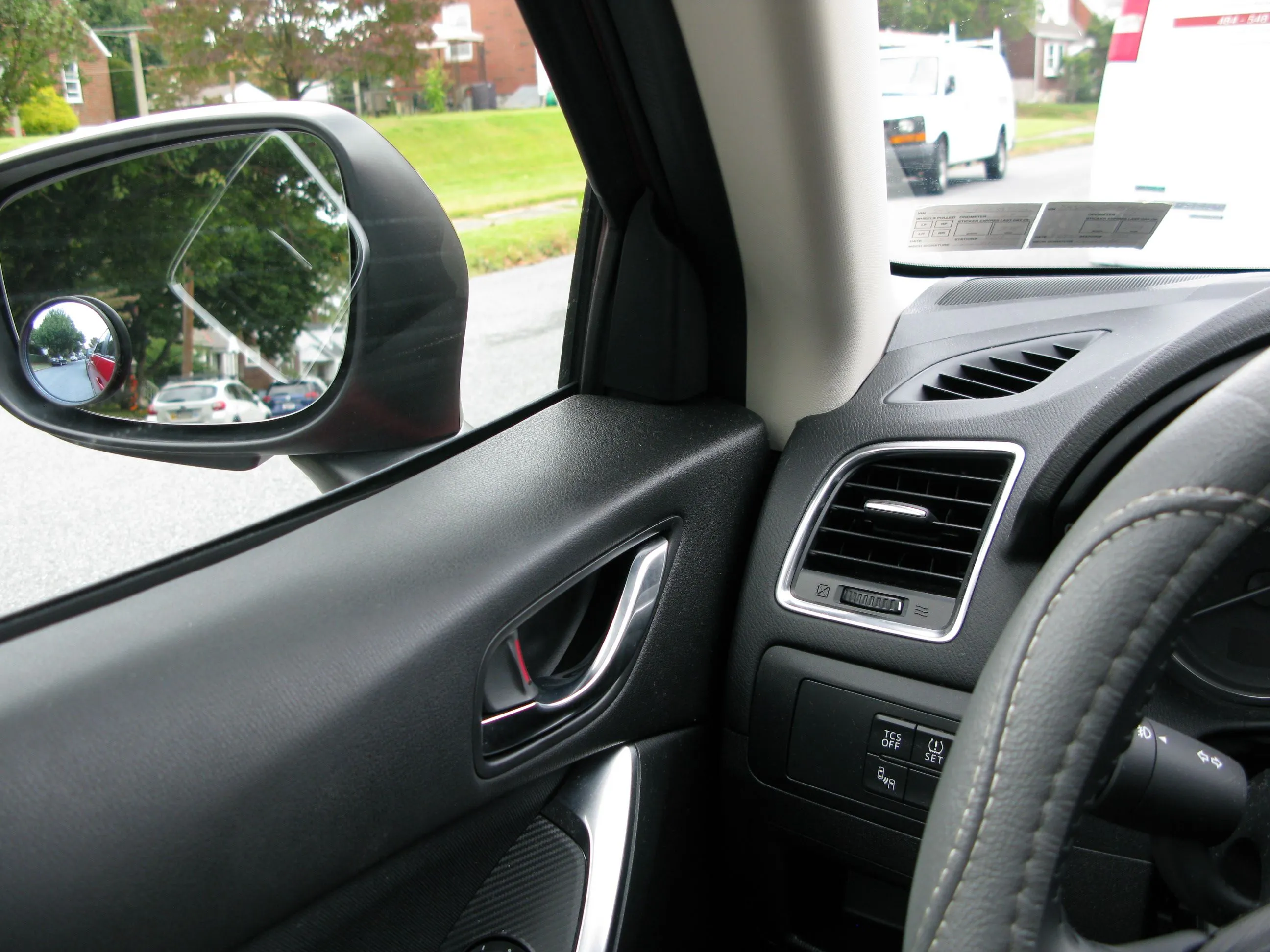

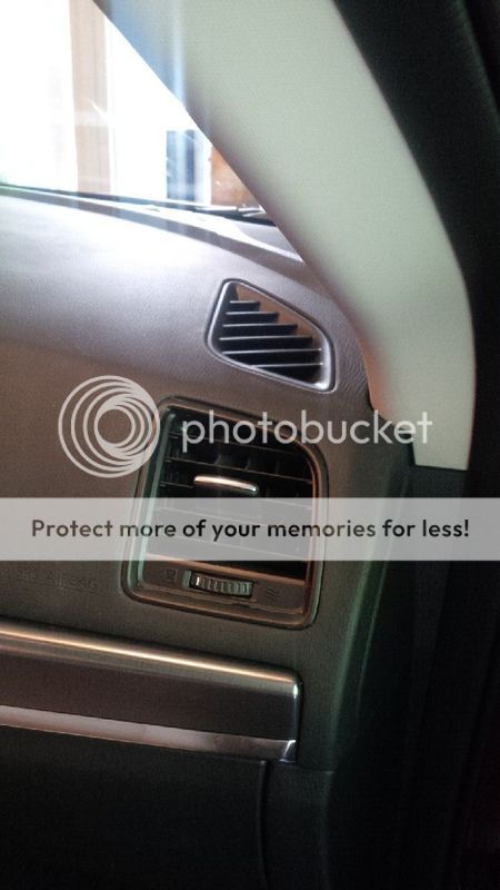

Thank you. Thank you. Thank you. I did the passenger side last night with vinyl mat. Looks super and NO Mirror Glare - priceless!
So you cut the 3M matte black vinyl wrap to the size of the vent with the backing on it? And then peeled the backing off of the cut out piece and worked it into the crevices? I really want to do this, and ordered the 3M vinyl wrap already. Yours looks fantastic! I can't wait to get rid of that annoying glare.
