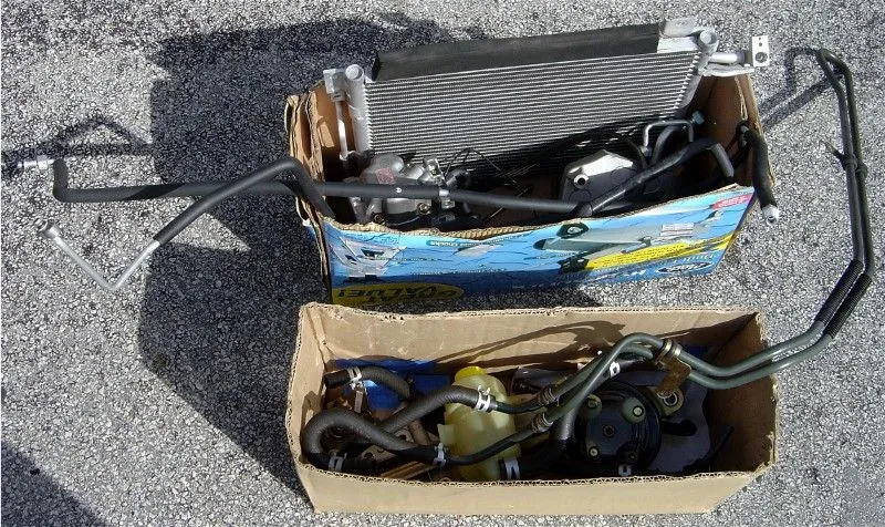

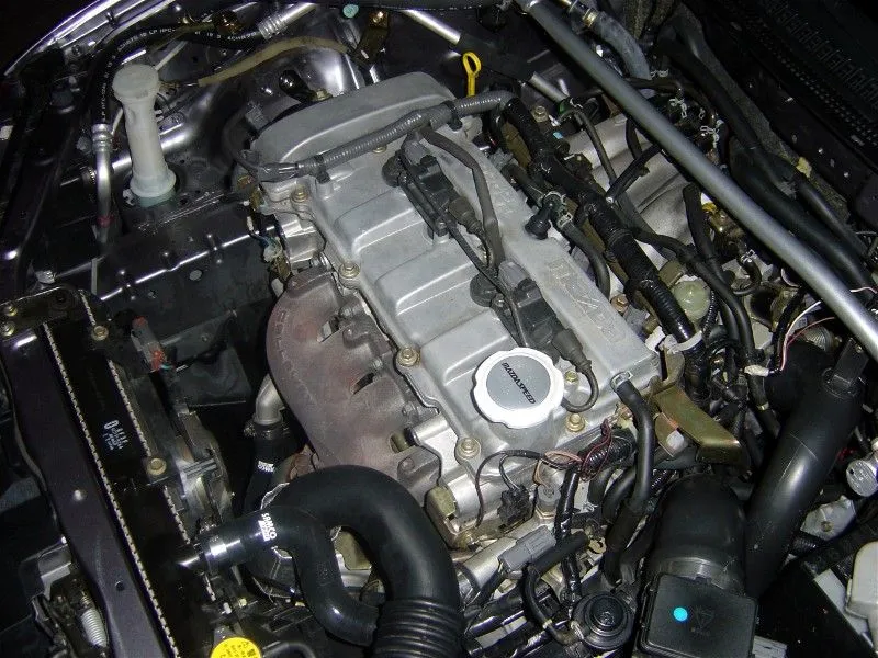

First, I'd like to thank Jeff & the other people I talked to for help with this project. I'd also like to point out how TOTALLY misleading Jeff's thread about this was too. :p He said that this only takes an hour & that the resulting weight savings was 80lbs. In reality, it's more like 6 hours (doing it solo) & 35lbs (I weighed it). (smash)
So anyway, they're out...enjoy the pics! :D

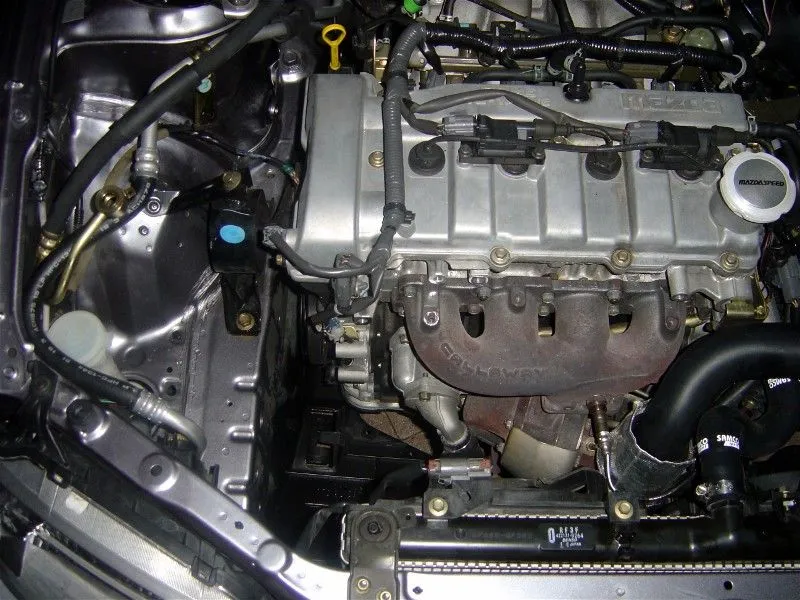

1. All the parts, brackets, bolts, etc. The A/C box weighed 22lbs & the PS box weighed 13.

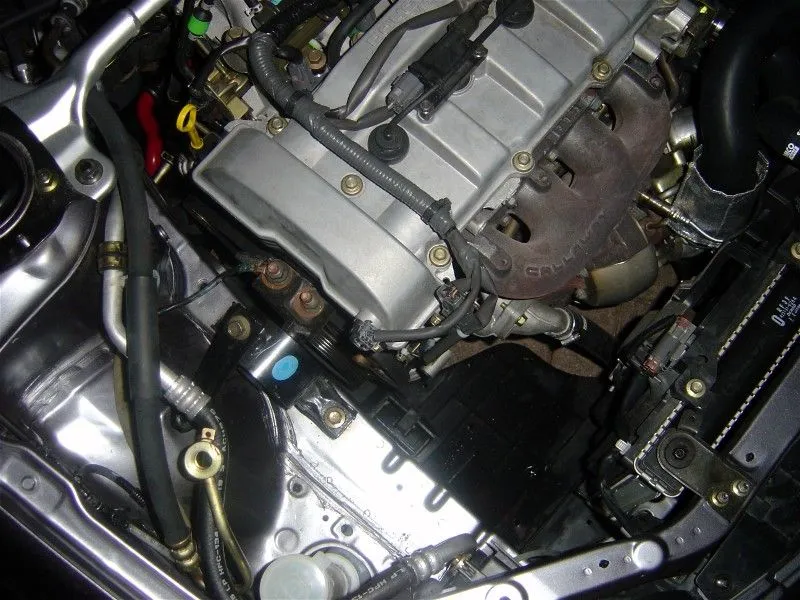

2. You can actually see all of the engine now since I also removed the brackets that held everything to the engine.

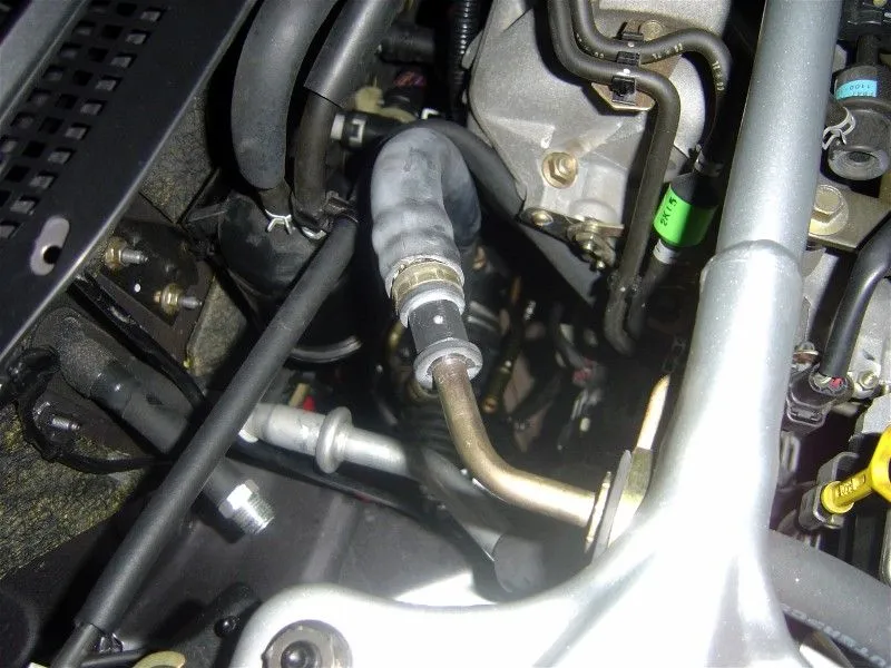

3. I still have 1 A/C & 1 PS line that I couldn't remove.
4. I think I could fit a small child in my engine bay now :p
5. In the foreground, you see the A/C line I removed, the special connector I couldn't disconnect (even WITH the Ford AC removal tool), & the PS line I coudn't get at (not enough room to reach down with big pliers). In the background, you see the PS line I removed.

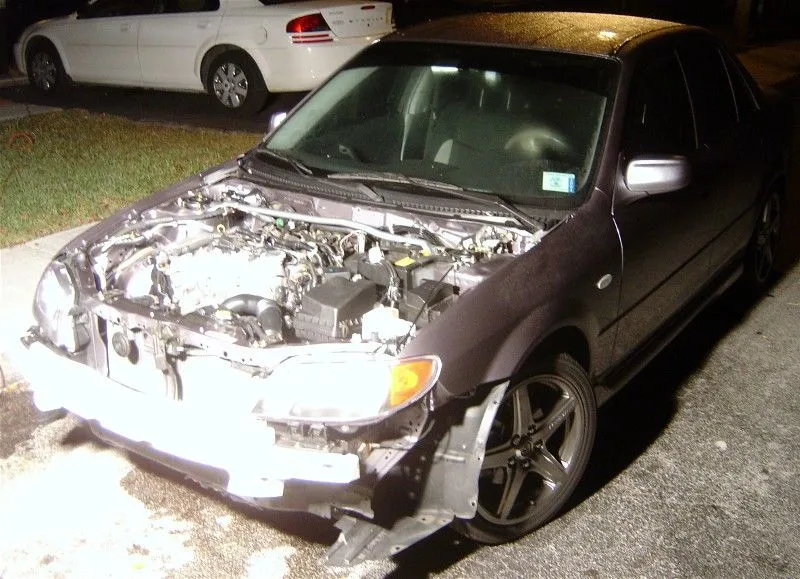

1. In order to do all of this, I took off the following parts (not all necessary, but made it easier):
-airbox
-both IC pipes
-both fans
-coolant resevoir & coolant resevoir/airbox bracket
-both radiator brackets
-bumper
-hood

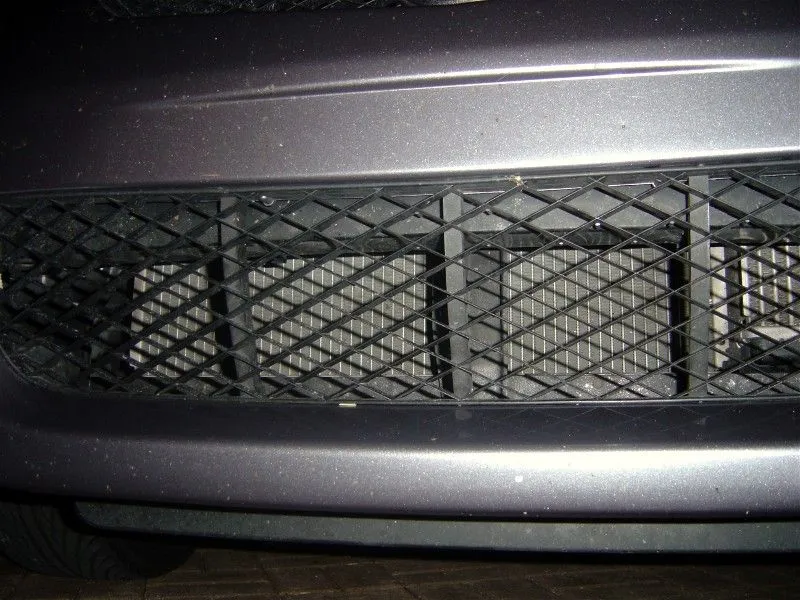

2. The radiator now gets direct airflow through the lower grille...until I stick a MAM FMIC in there. :D

Not that it will matter (because I'm getting a FMIC), but taking the A/C condensor out not only gives the radiator direct airflow, it also eliminates the bracket that blocks the top 1/4 of the SMIC. For anyone running a SMIC (stock or aftermarket), this would probably help out since the bumper beam blocks the middle 1/2 of the core.

I live in FL & most people think I'm crazy for doing it, but I almost never use the A/C. I either put the windows down or turn on the fan for a bit. Originally I was going to take the A/C & PS out to make it easier to install my FMIC, but I did it because I also wanted to save weight & eliminate the parasitic drag. To answer your 1st question...NO. :D
Matthew said:
**** no power steering. AC i can live without, but not PS.
When I first drove it, I was ready to put it back in right away. I've driven it for a few hours on the highway & around town now & it's not that bad. The only things that really suck are sitting still & U turns. Of course, you can't turn the wheel as fast as before, but I did swerve to miss something on the road without any problem. One-handed steering is gone too, but the steering has a nice feel to it. The wheel always returns to center now & you can feel the road a lot more...I'd say the steering is more direct, just not as easy to do. The car also feels WAY smoother in the way it drives.

make sure you loop your power steering lines together, it will make it easyer to turn
I asked around for help & info with the removal before I did it & searched for threads on here & Club Protege. Since I wasn't able to find anything useful (besides thread jacking the WOMP S/C thread), I relied solely on the Factory Serivce Manual. If you could go into further detail about what you said, I'd really appreciate it. I'm not putting anything back, but anything I can do to make turning easier would be great.

the two lines that go to and from the pump to the rack, loop those together, I'll see if I can print up some pictures at work to show you what I mean
