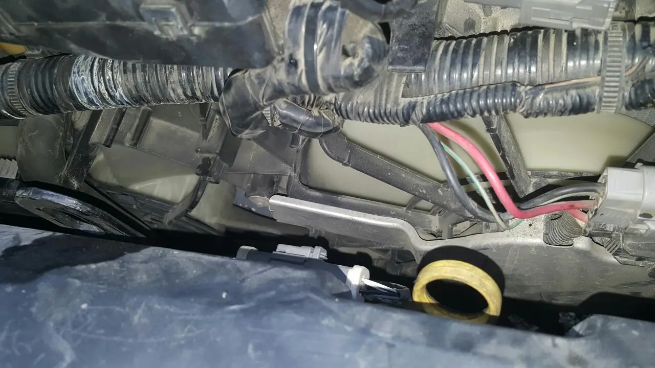

Checked the condenser and everything looks fine. With the engine on I noticed the fan is still not spinning.
So what ever activates the fan is where the issue might be.

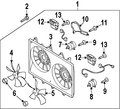

Ok, so the mechanic told me its the fan control module CY031515YA that needs changing #12 in the diagram left side. its around $300 (boom02)
