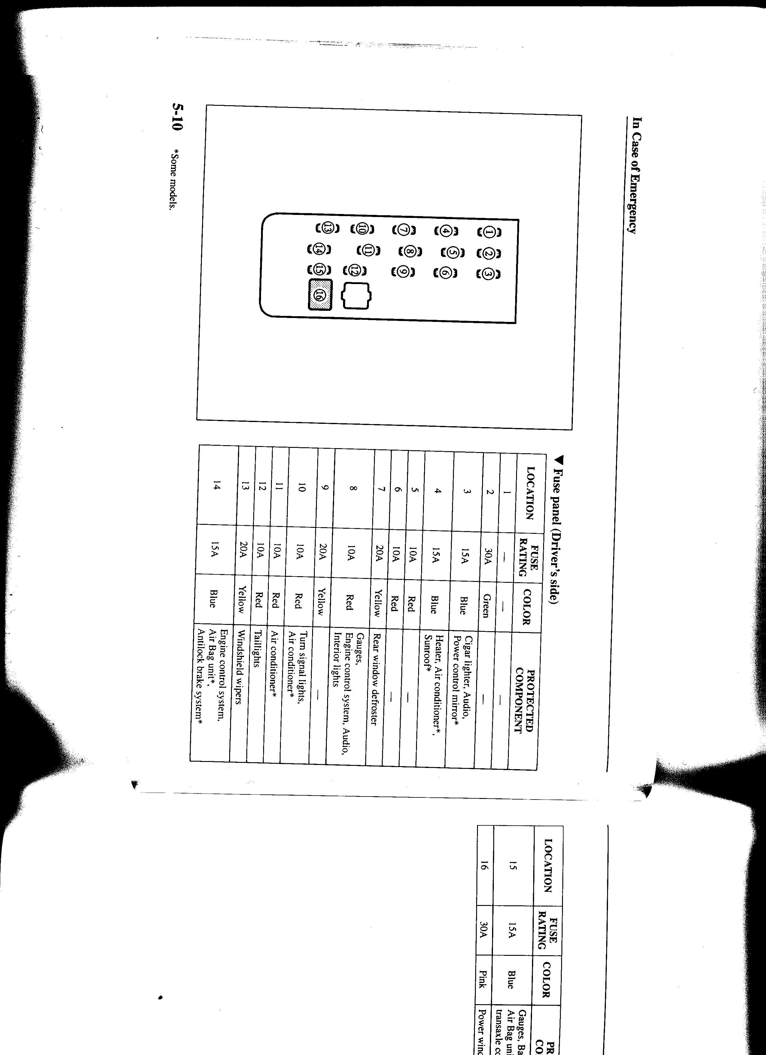

Hey, Does anyone out there have the interior fuse panel diagram for the 97 protege? I picked this car up for $550.00 as a project (its in good overall shape despite high km's) and am trying to keep costs down.
Before you state the obvious, NO I do not have the owners manual...
No, the diagram is not on the box cover...
And as far as repair manuals go, I bought the Haynes from the local Crappy Tire and it has the WRONG diagram in it, its not even close to the right layout, and I'd like to avoid buying another book just for one stupid but essential diagram :mad:
Cheers!
P.S. Haynes, YOU SUCK!
Here it is, hope it helps.
Thanks A TON!!! thats great :)
Really appreciate you taking the time to scan it for me, let me know if I can ever hook you up with any of the diagrams from the Haynes, I HOPE that that's the only one thats wrong....
