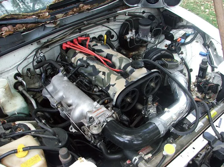

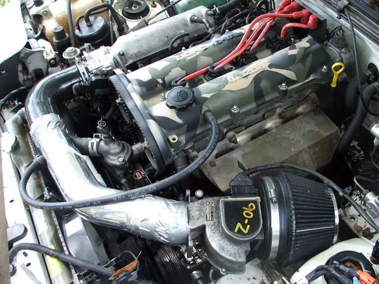

By the way this is what my 1.8 swap looks like. (peep)
Did you get those idle issues worked out with that duct tape ;). The camo is kinda cool, though, hehe.
