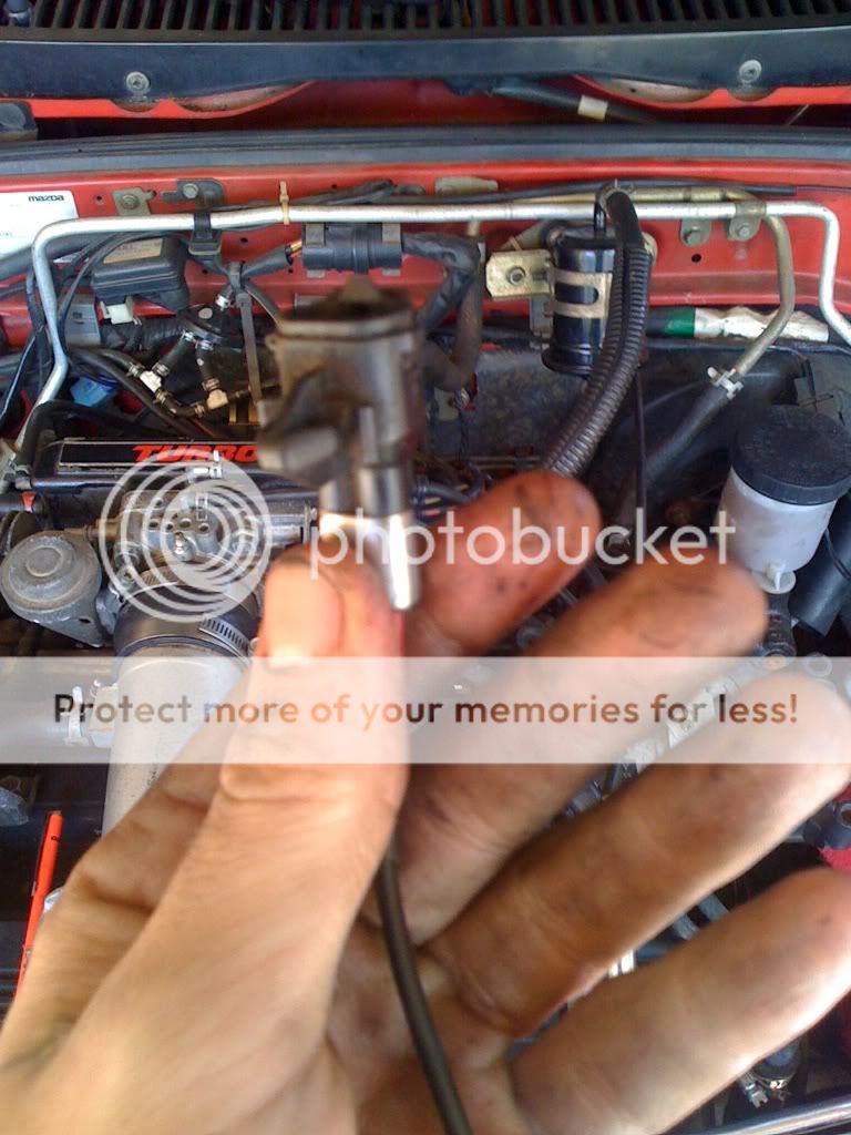

ok so the motor is almost buttoned back up and ready to crank.
except for a few things here and there
if yall could help it would be greatly appreciated
i know this came of the intake mani but i dont know where and what its for..... it broke the connection on the block when the head was coming off

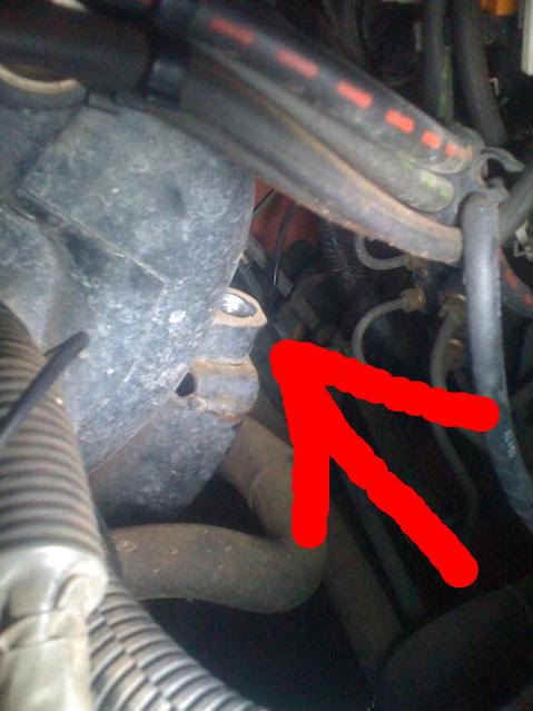

and for this oil return?
idk if i lost the bolt or whatever but i cant seem to find what size i need.... and if i do need to go and buy one does it need to be a special one due to it being attached to a oil return?... like have a hole in it?
The plug is the knock sensor. It is located next to the oil pressure sensor next to the starter on the back of the engine.
The bolt you need is Mazda B660-14-615 and two crush washers 9956-21-000
