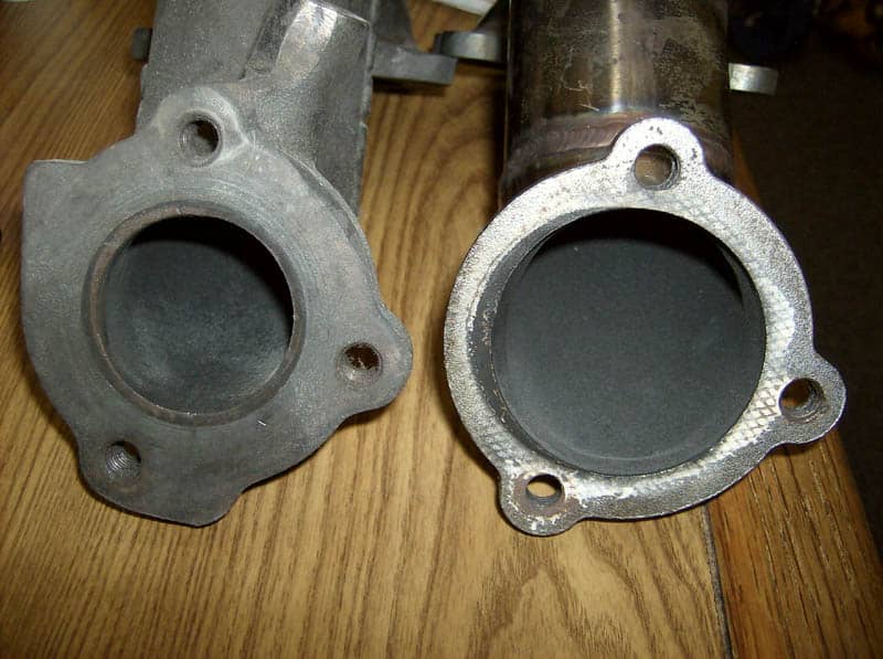

Here is a picture of a stock bottom of the S-pipe and the CorkSport current version

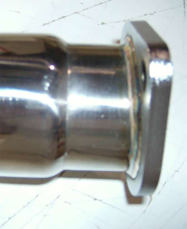

The stock outlet is 45mm ID and the CS is 60mm ID. The space between the bolts is right at 67mm which means we have to do some sort of reduction for the 80mm pipe to work. What we can do is ..
There would be a small section which could be cut off for a custom app. The outside of the stock S pipe flange at the J pipe connection is 81mm. This is the stumbling point on the getting 80mm piping to the flange for the S pipe connection. We could leave it with no flange but I dont think that would work well for the majority of people.
