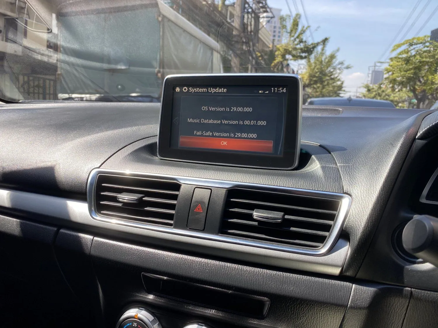

My current version is 29.000.000, does anyone have this version? Should I upgrade it to 31.00.100A first? I tried to follow the instruction, but the screen always showed operation fails. Does anyone have the same issue like mine?
