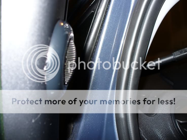

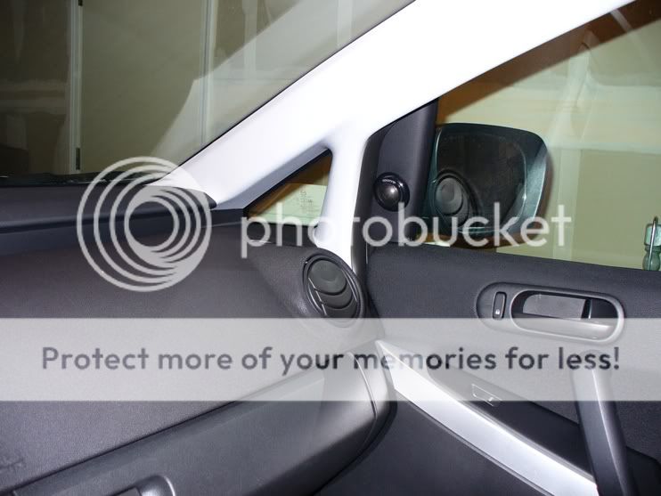

Can you post pics of your front tweeters installed? I am planning to do the exact same thing! :)
You Had Room To Flush Mount Them, Or Did You Surface Mount Them, I Know Mine Would Not Fit Flush. The Sound Shage Is Pretty Decent. Its Amazing How Little Highs The Stock Speakers Had

the tweeters are flush mounted, but they are like 1mm too deep and stick out a just a tiny bit. I've considered trying to make it blend better, but the gap is so small I don't notice it unless I'm staring at my tweeters and it doesn't bother me.

the gap.
They are Kenwood tweeters as you can see, I can't remember what the exact model/mounting depth. I had the idea to do this and just went to the local stereo shop to pick some up.
Thank you! I have a set of infinity components that I'm almost ready to install and I will definitely be doing the same. Honestly, I could live with that gap too! If you hadn't taken the photo from exactly that angle, I never would have known!
