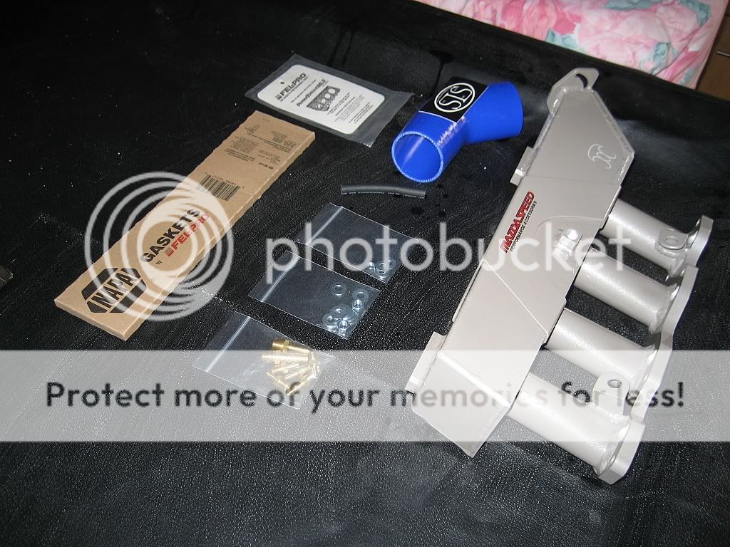

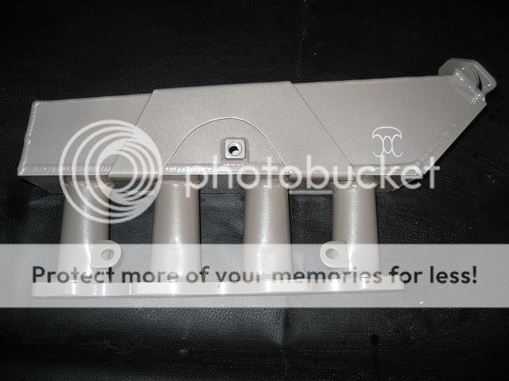

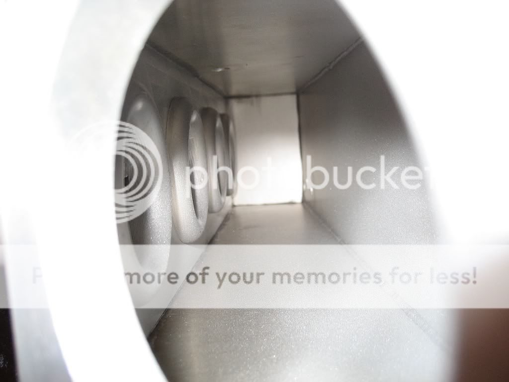

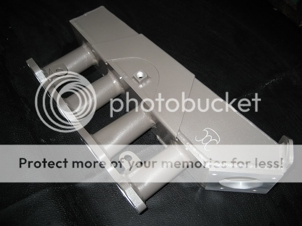

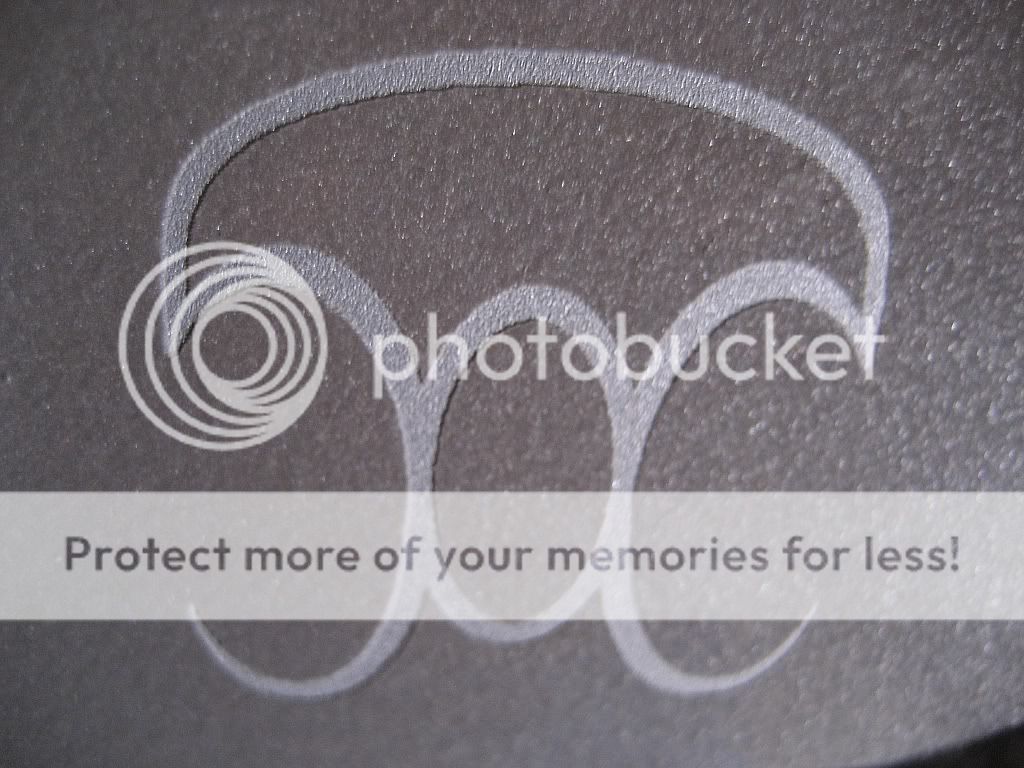

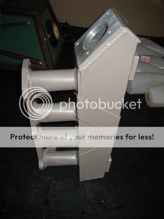

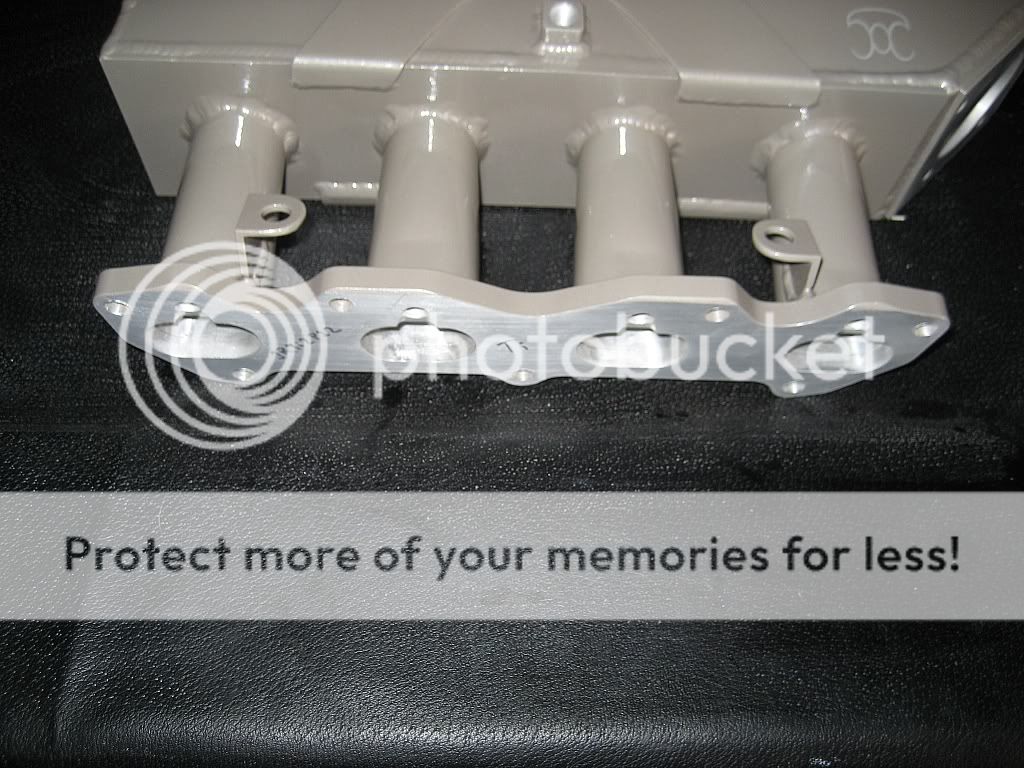

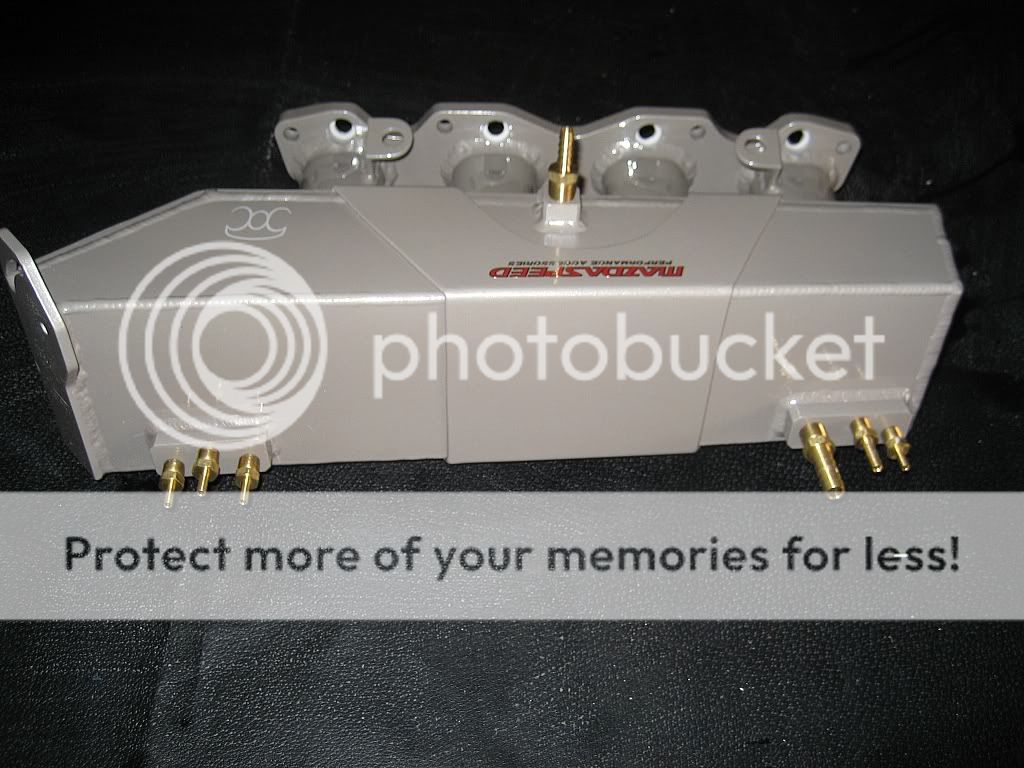

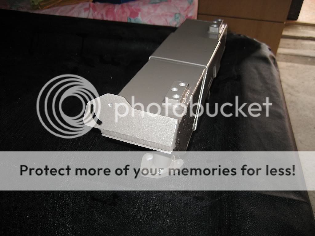

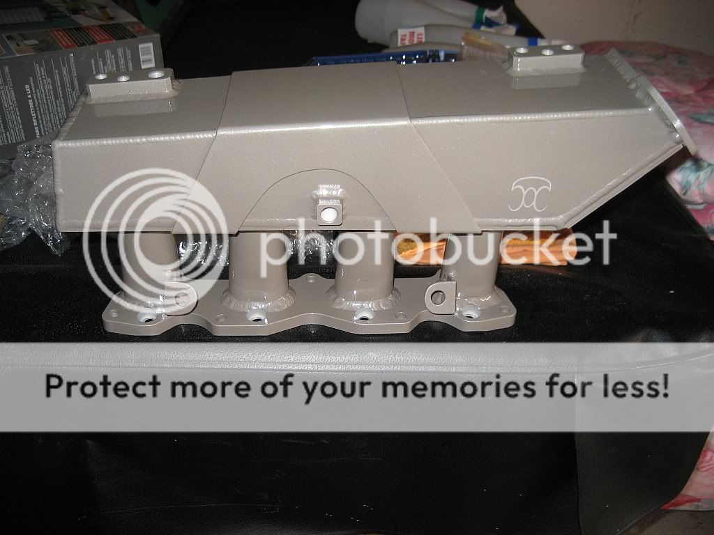

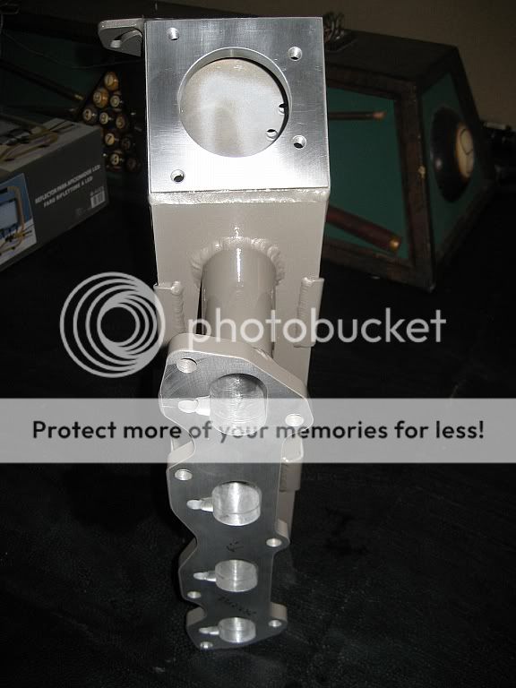

THIS IS WHAT DREAMS ARE ******* MADE OFF !!!!
I just can't say anything else.. This is just to ******* Much.. INSANE !!!!
Judge your self, and ENJOY !!!!
Added my Mazdaspeed Performance Accessories Stickers for legal Purposes lol lol lol...
Thank You RICH, you are Simply the ******* MAN, no matter what others say.. this thing Rocks ******* hardcore.. btw my Intake Manifold Is FLAWLESS no matter where and how you see it

I was wondering is you were gonna add the Mazdaspeed sticker. lol

miguel - Pumped yours got overseas safely. I hate how that coating looks in flash pics, underhood in most lighting it should look pretty close to titanium. I hope.
Everyone - I want to specifically address the integrity concerns by pointing out a couple things.
Back when we made the prototype, we didn't have any of the fixtures or jigs or anything that we used to make the production pieces. One of these things we used were 4 oval steel "plugs" that fit snugly into the main flange ports. These soak up the heat on the inside of the pipe and minimize any "eating away" of the pipe there where it meets the flange. Since these were not used on the proto, there ended up being HUGE gaps there. Like 3-4 times the width of ANY of the production pieces.
That manifold has been run on my car for almost a year and a half. My car has solid mounts on all 4 sides. It was also the manifold used for ALL testing, including AFR per cylinder testing, AND the dyno testing.
Hope this helps settle any concerns about them being "weak" there.
