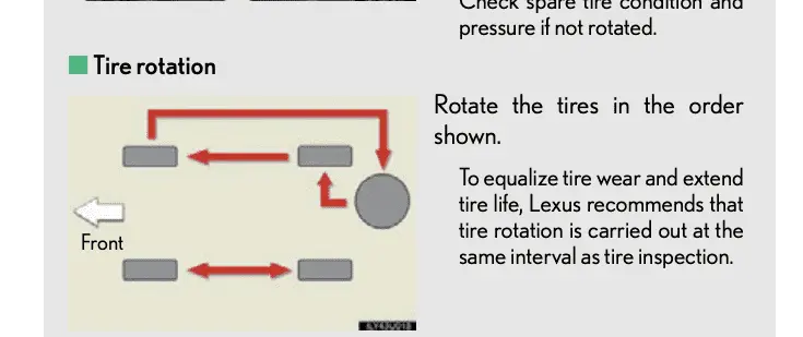

This is what is recommended on my GX 460 (150 series LC Prado)
It has a full time AWD system with a torsen center diff.

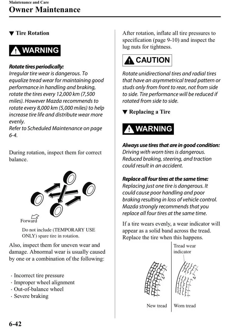

Follow the mazda manual that carpe diem posted in post # 2. Throw your spare on the right rear and follow the manual. That is for 90% of the tires.
Only unidirectional tires (v-shaped grooves) like a nokian snow tires or Michelin cross climate, etc. get rotated straight back to front ... and front to back. Also asymmetrical tires like a nokian wr4 all weather would also go back to front / front to back.
But all regular tires which is almost 90% of tires will follow the crisscross method in the Mazda manual. Just sub your spare onto the right rear...

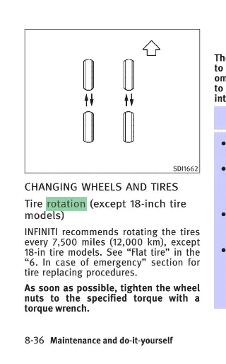

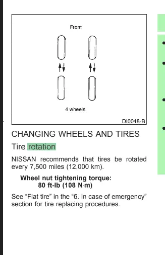

Interesting.. my old Maxima and my current 07 G35x also suggest front to back
Funny ...I've just done the same on my CX-5 over the years with no abnormal tread-ware. I do run snows (Blizzak) in the winter as well

Maxima was FWD, G35x (AWD but RWD biased) and 460 are AWD. Infiniti tries to run in RWD when it can.. the 460 like my old Explorer always has significant ratio of power going to both axles.

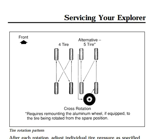

I had a '96 Ford Explorer 5.0L AWD and they did recommend criss cross there. Interestingly different 5 tire rotation that my 460
