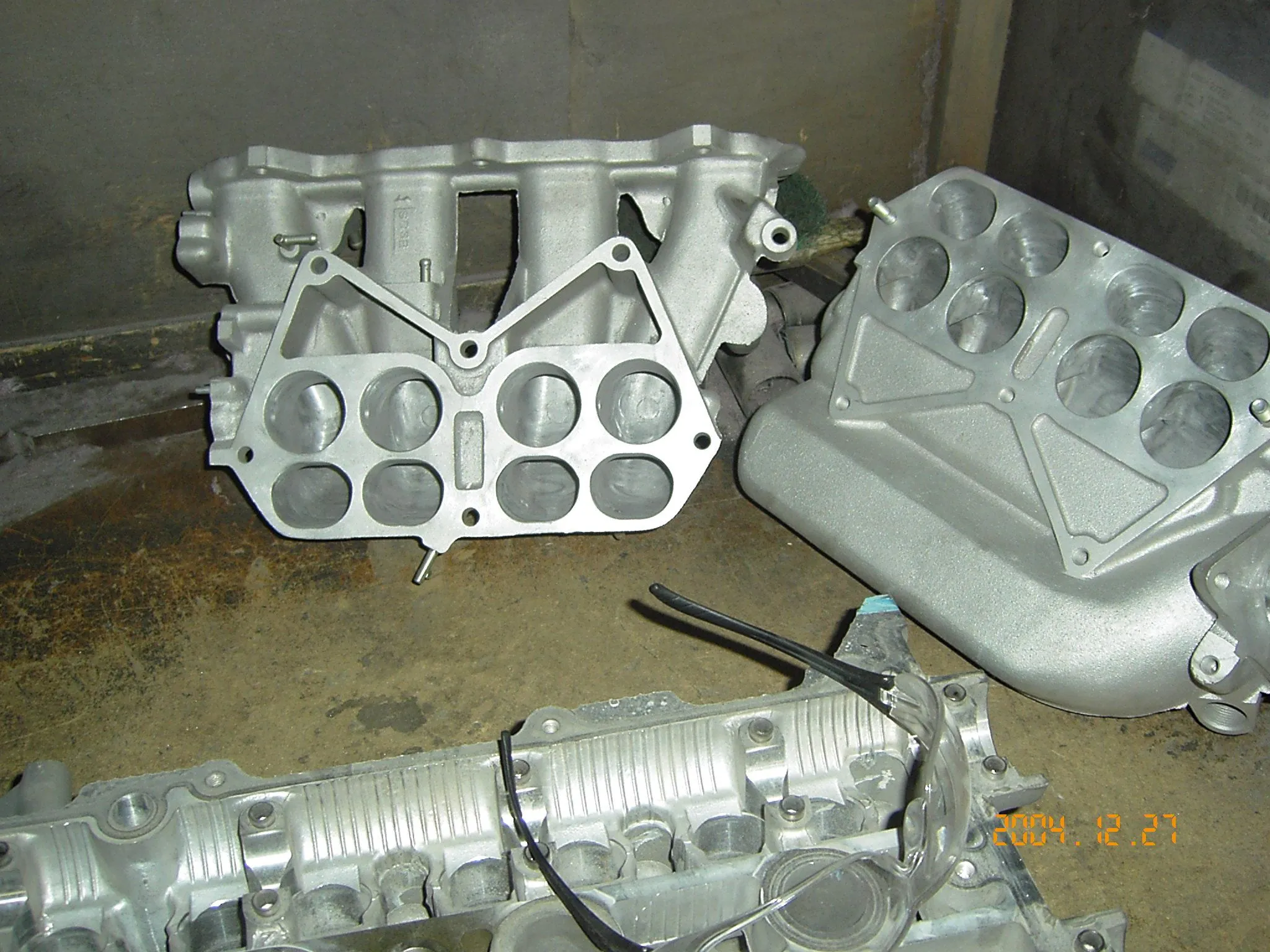

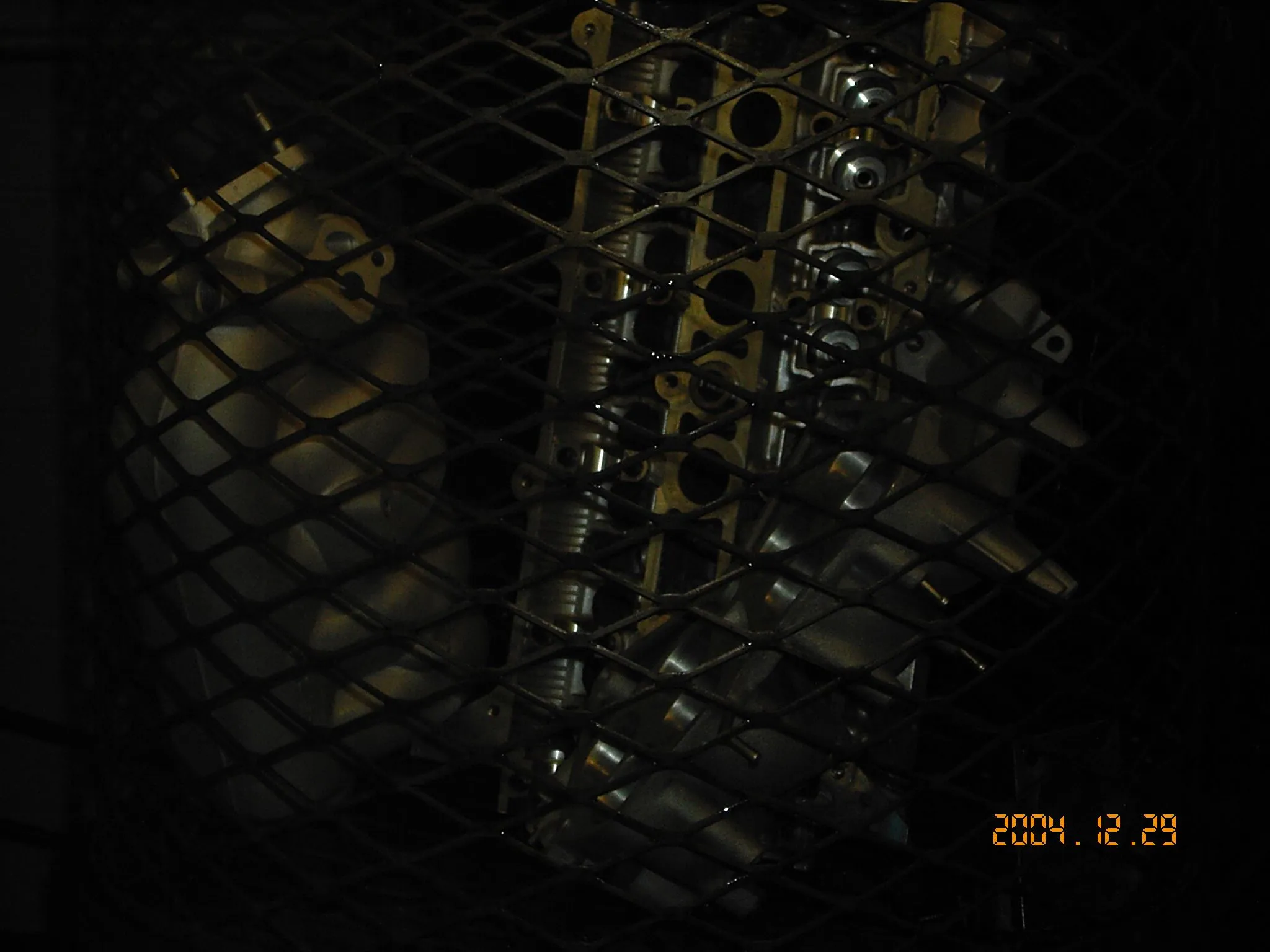

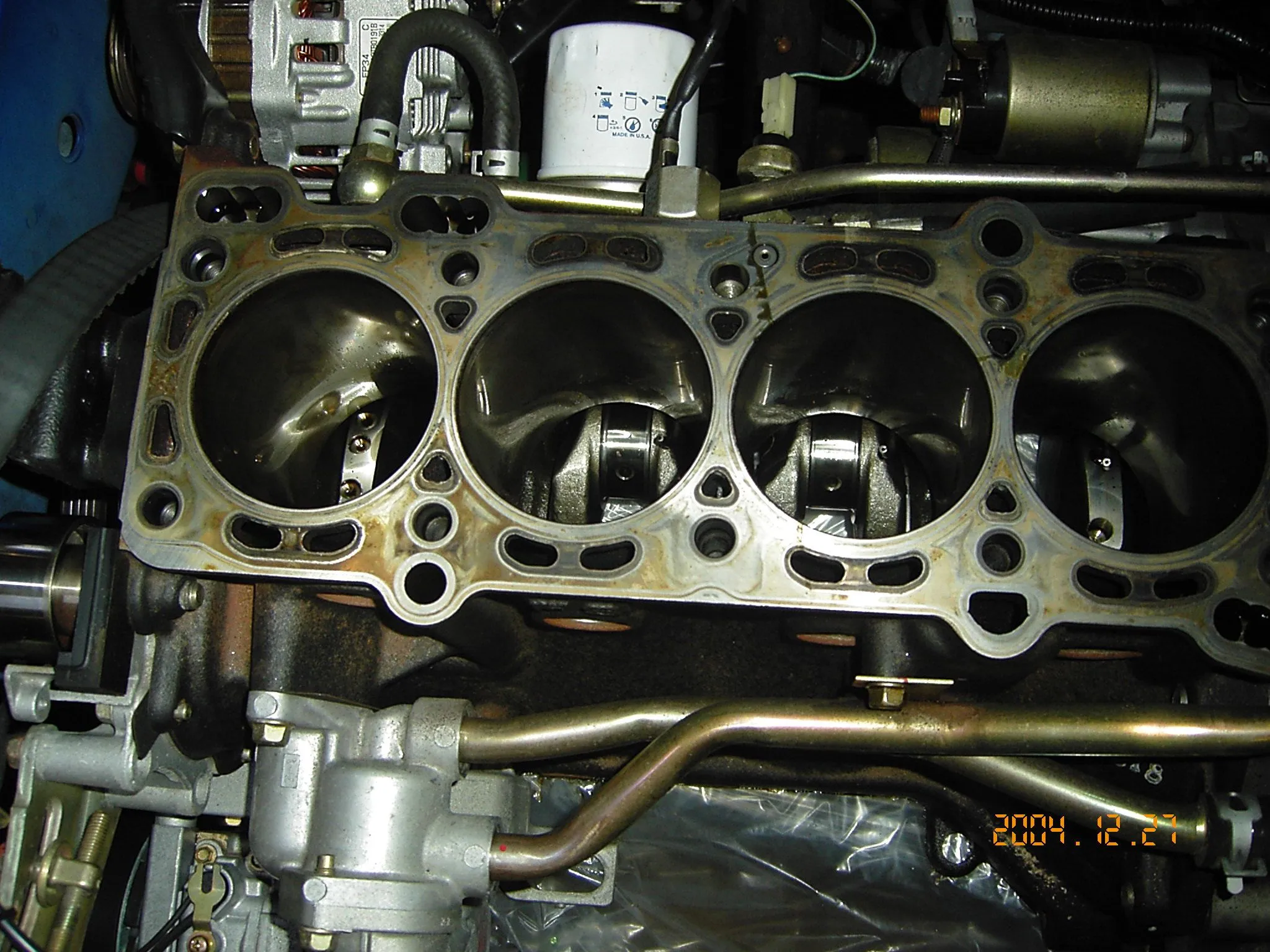

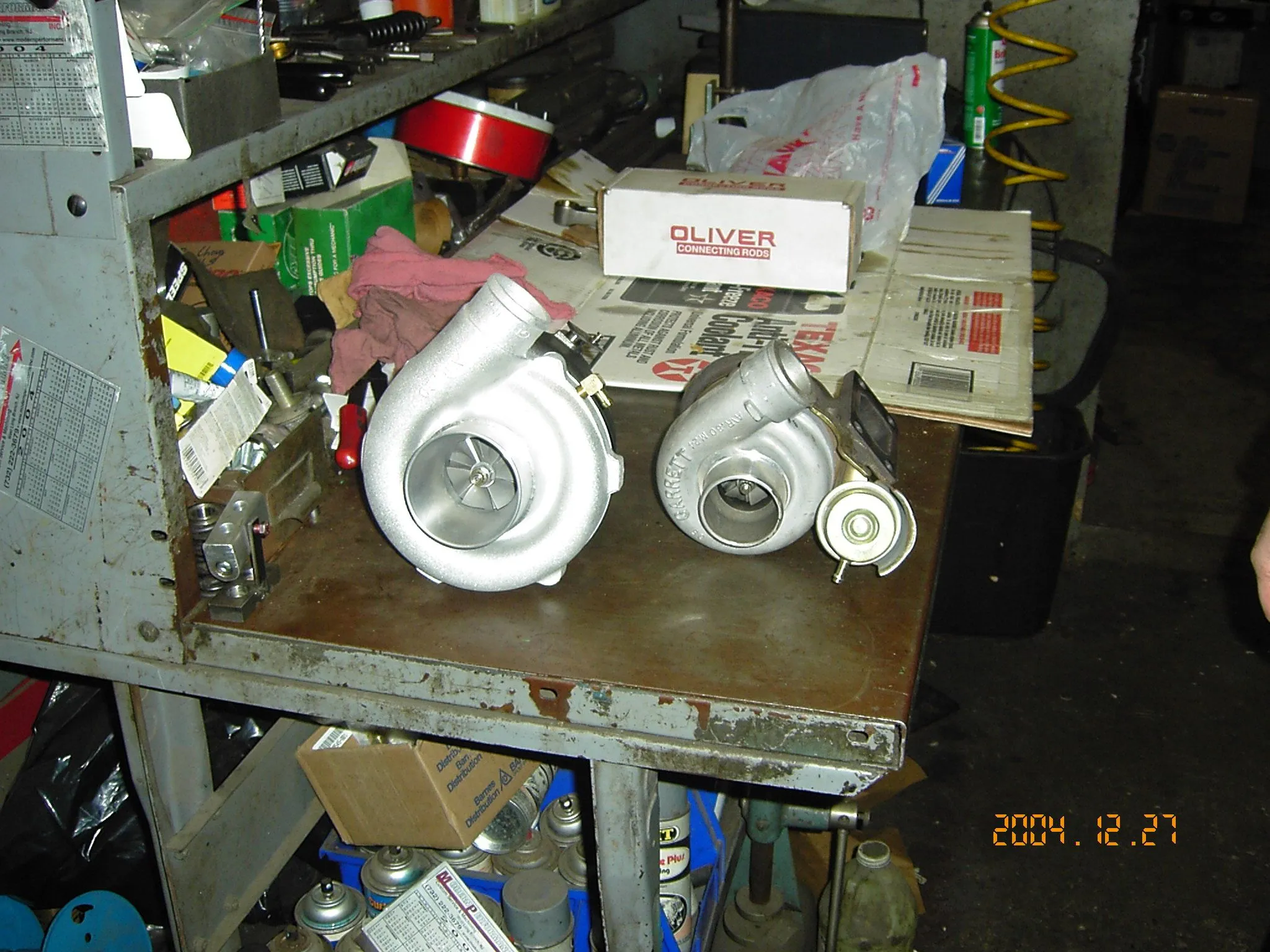

Hey i finally was able to get to the shop... here are afew more pics, as of now the intake mani was ported and polished and the head and exhaust mani is ready to be done, the rods and pistons are out, the motor should be put back together by thursday..and then we have to figure out how were going to set up the new intercooler, along with the fans.
Thanks,
Matt

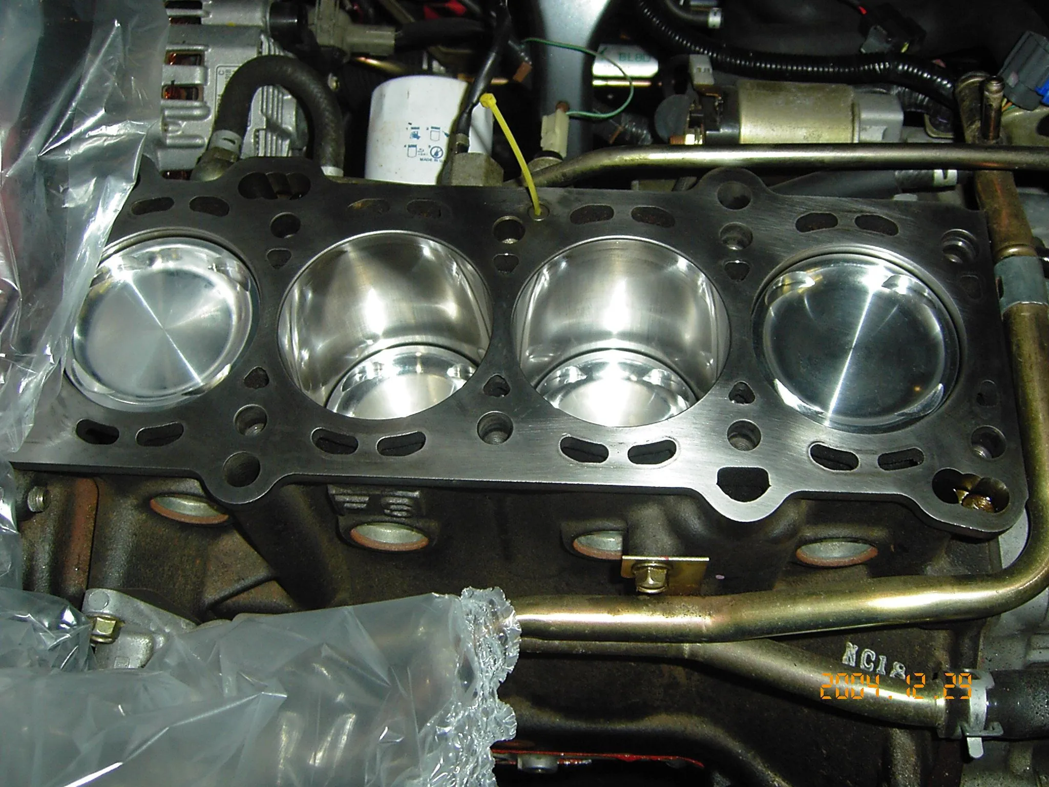

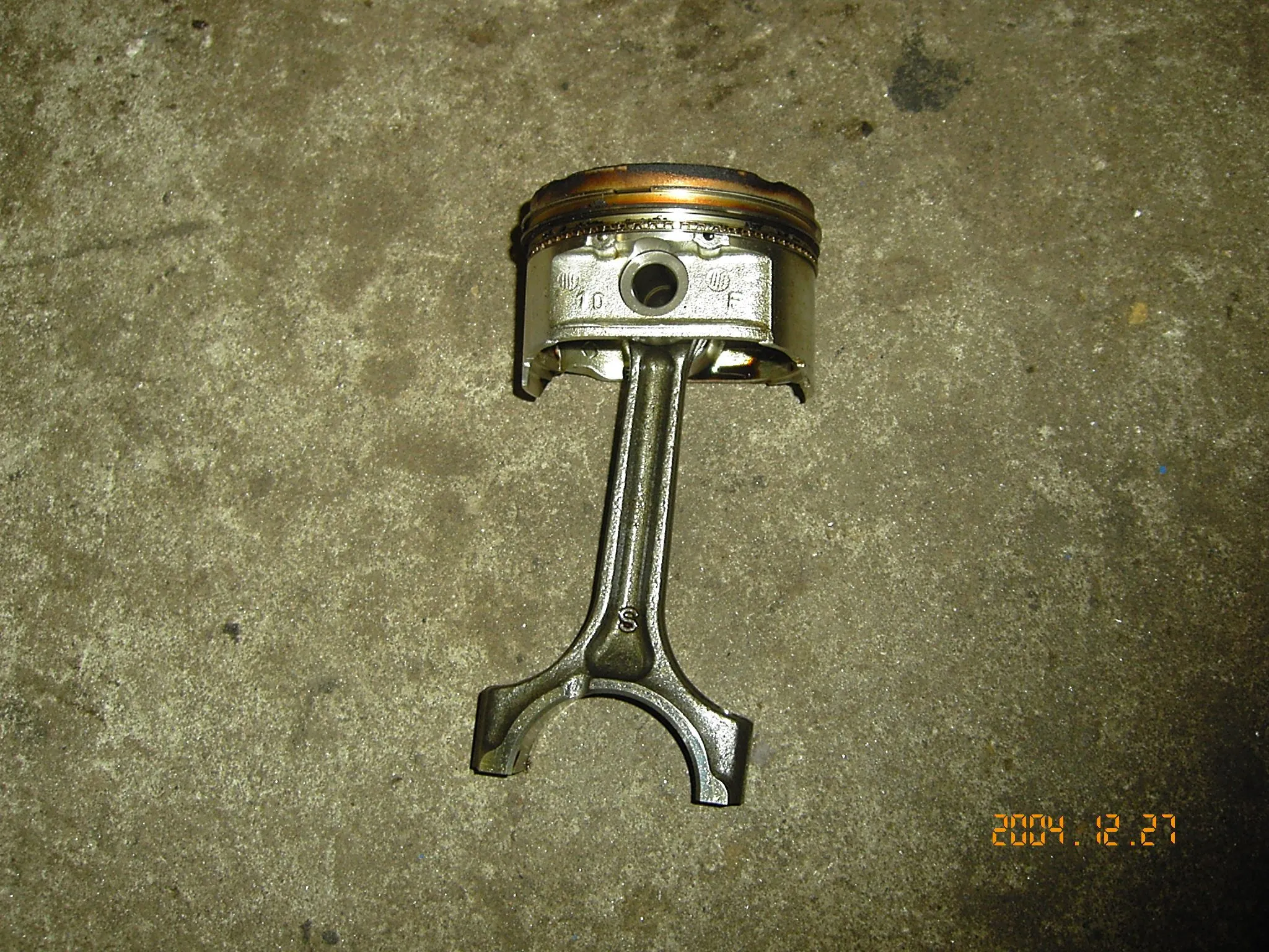

the New Oliver Rods and Cp pistons are in, and my Ion turbo back should be here tommorow?!?!?its about ten mins from my house but DHL was closed by the time i got back fromthe shop
Heres a pics of the new forged goods, my intake, exhaust mani,head, turbo exhaust houseing comeing out of the heat wash.

Now that is just beautiful!!! Hope Ion does finally come through for you. It does sound nice.

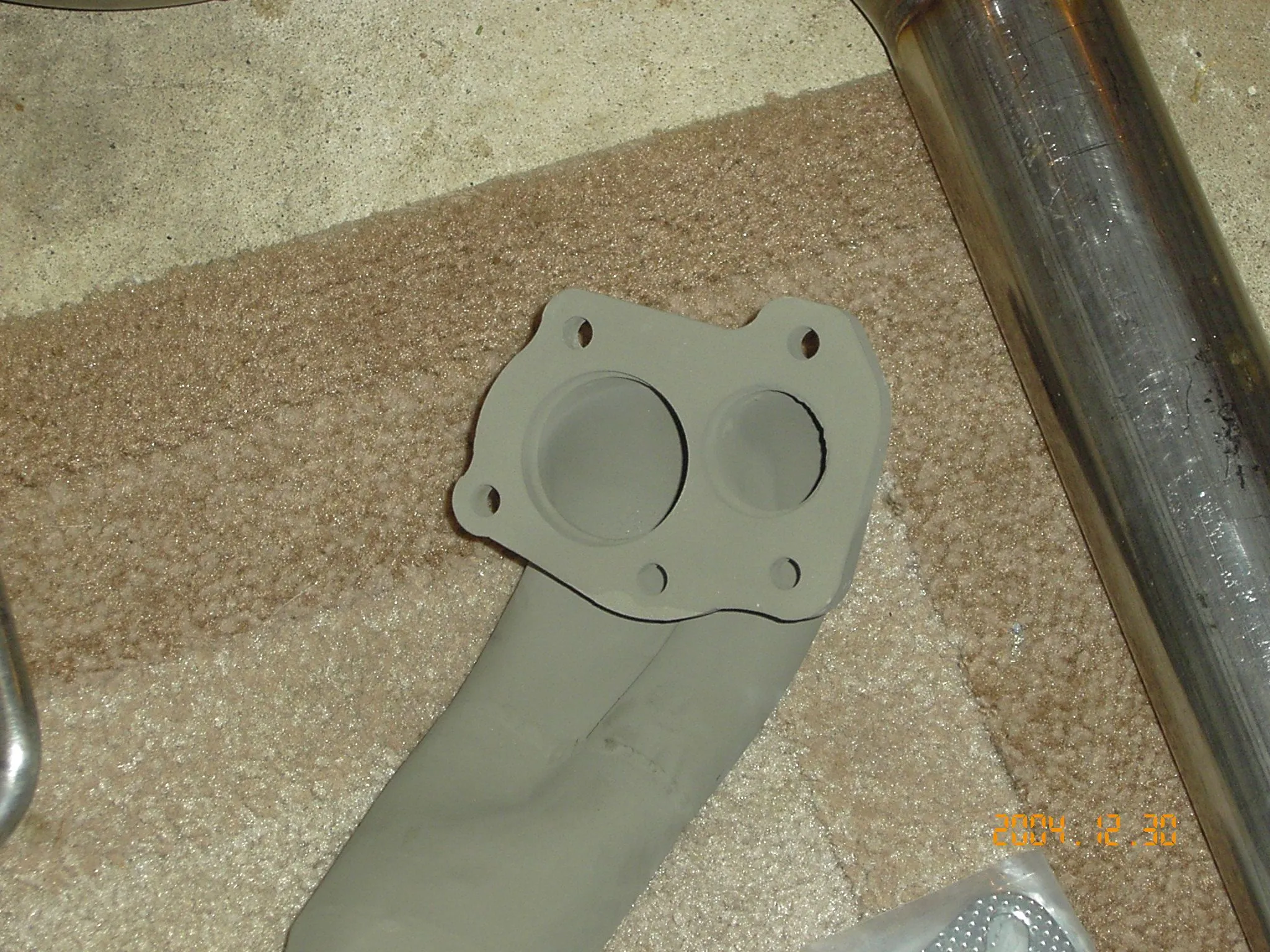

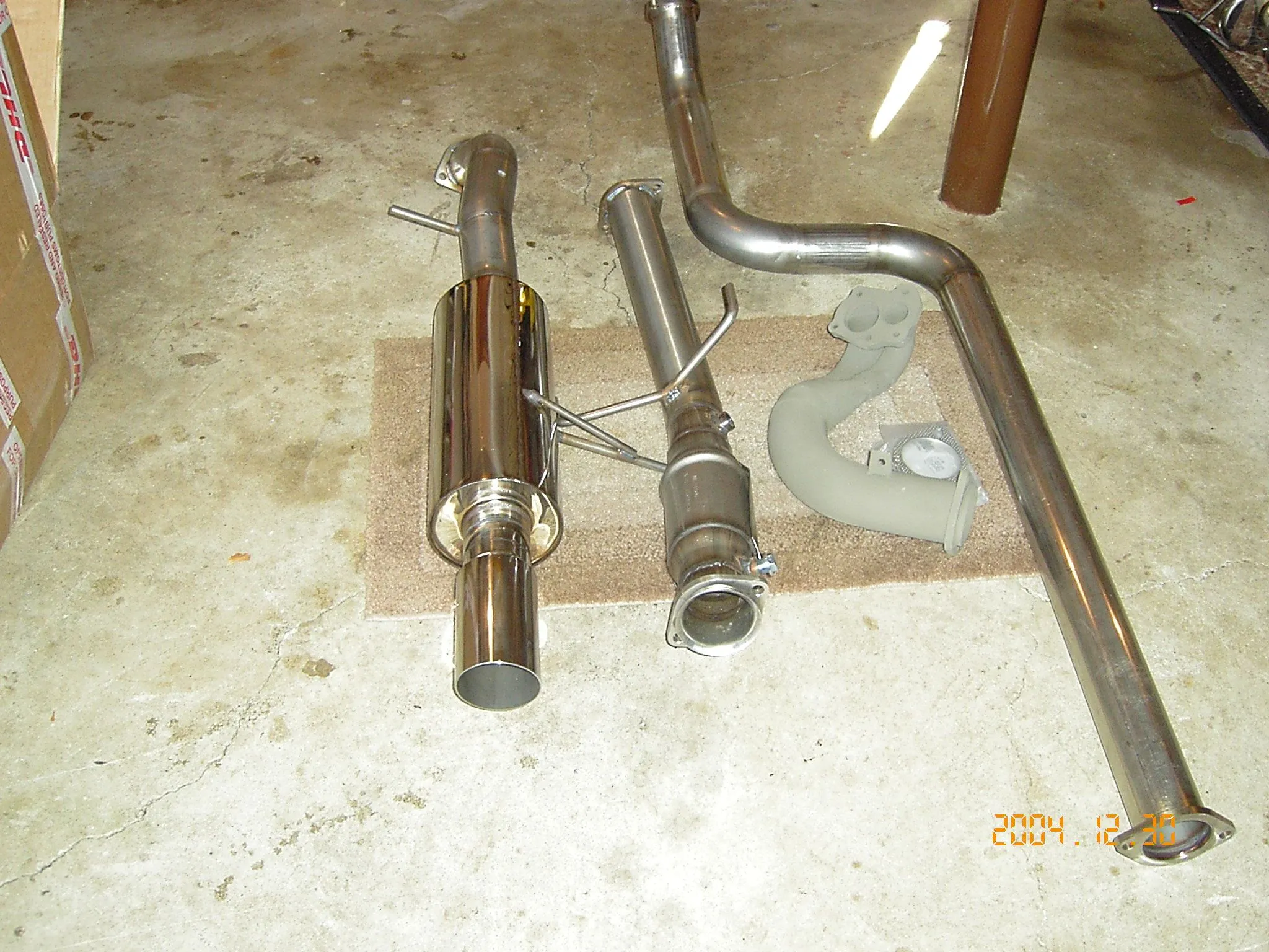

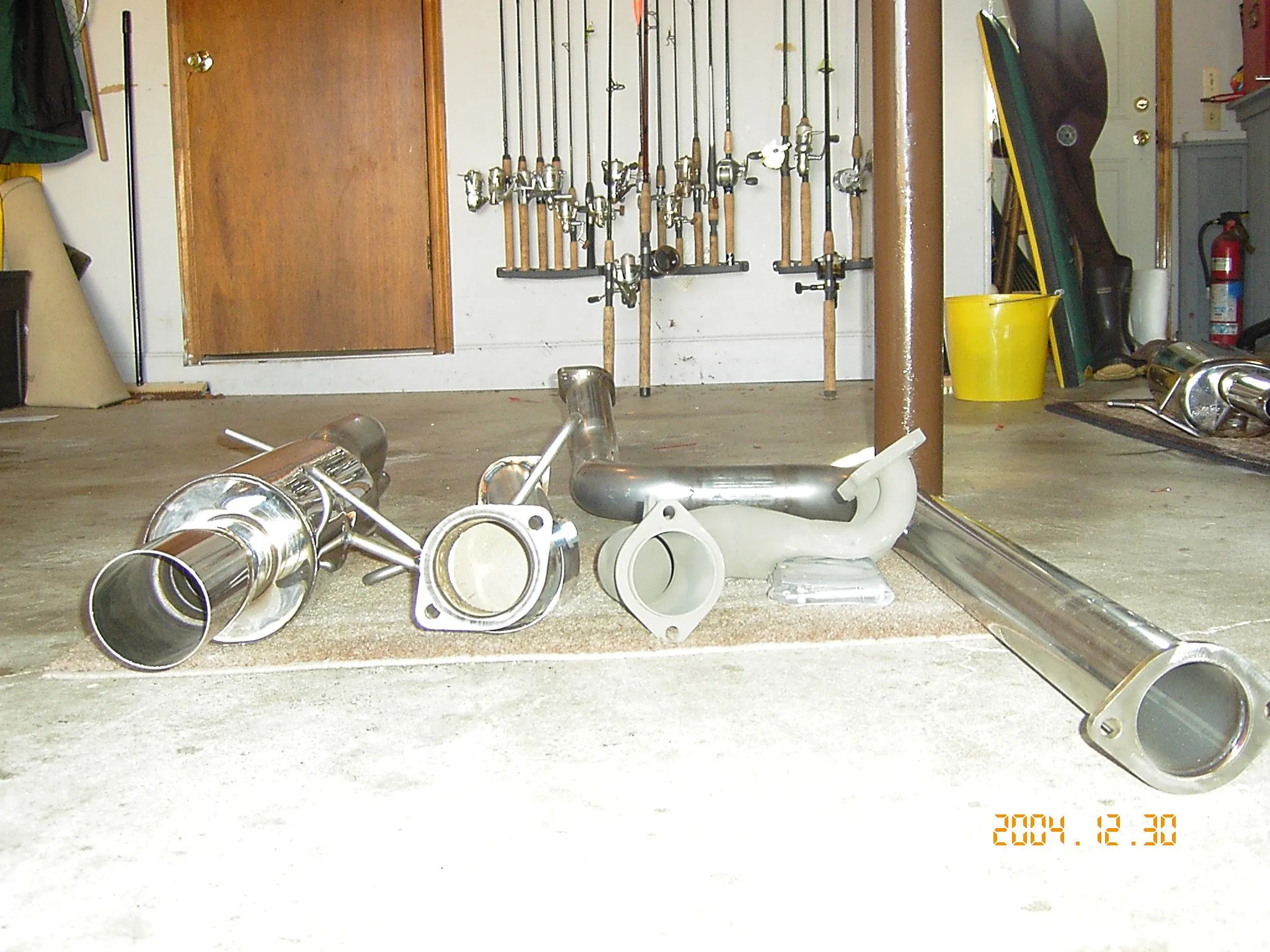

Finally My Ion Turbo Back arrived, and I guess i could say it was worth the 4month wait...
