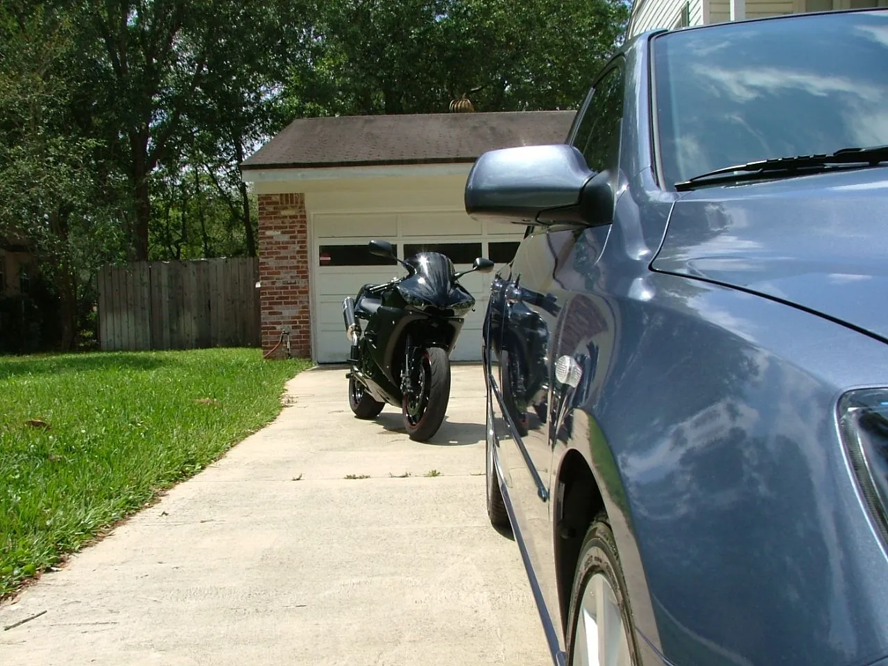

I don't see a clear bra! (attn)
It is so invisible it's hard to photograph. Here is the best picture I have of it.
BTW. It was $348.00 dealer installed and no bubbles.
Lol, I'm just messing with you guys. Kindof an oxy moron.. I don't see the clear bra..
anyways, $348 is a bit pricey.. i'll have to save for that
PS - nice bike
LOL! It is a bit pricey but IMO well worth it.
PS. Thanx, that is my other wife...
