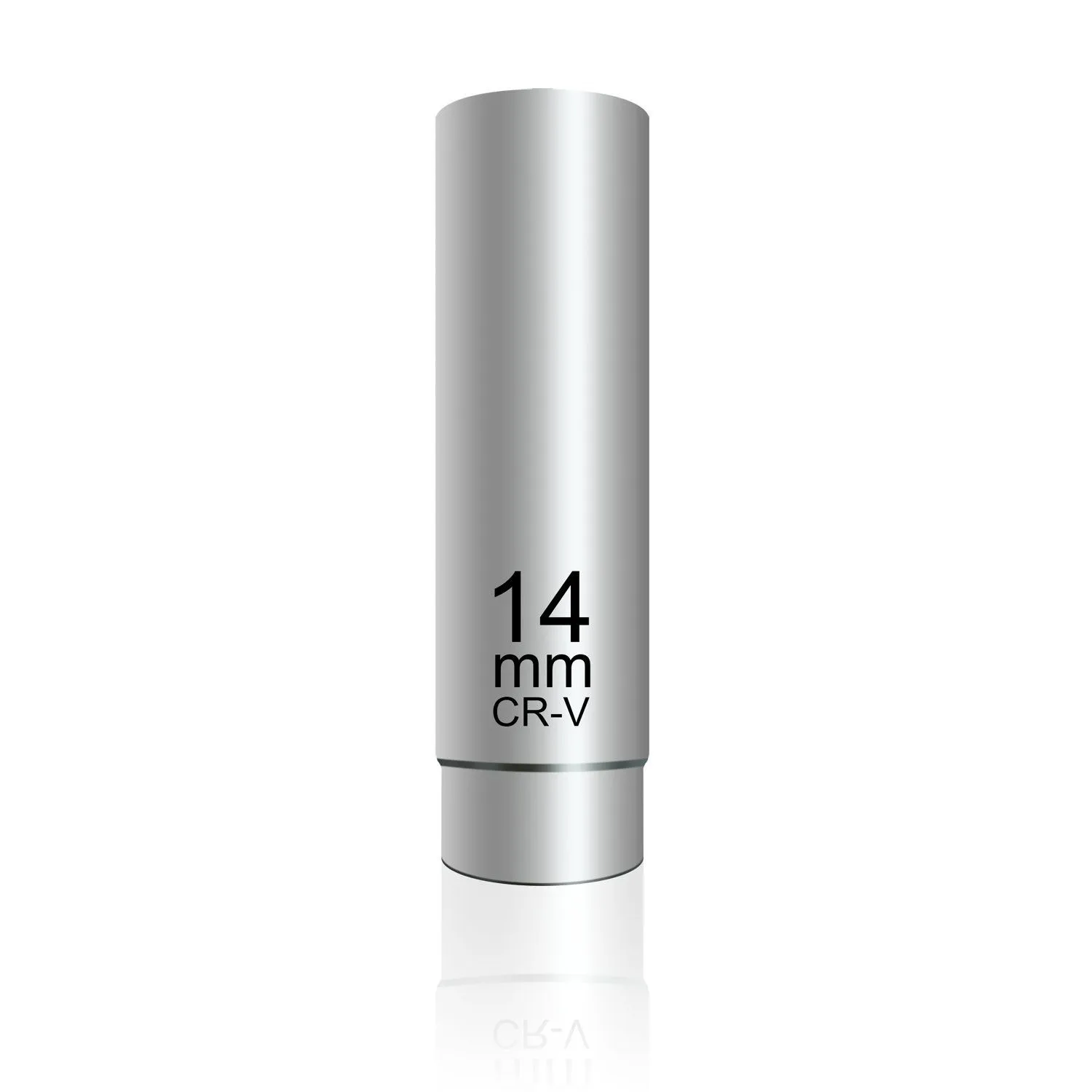

you got it ! And order your $12.99 spark plug socket from Amazon and its cake. It's a 14mm thin-wall.
